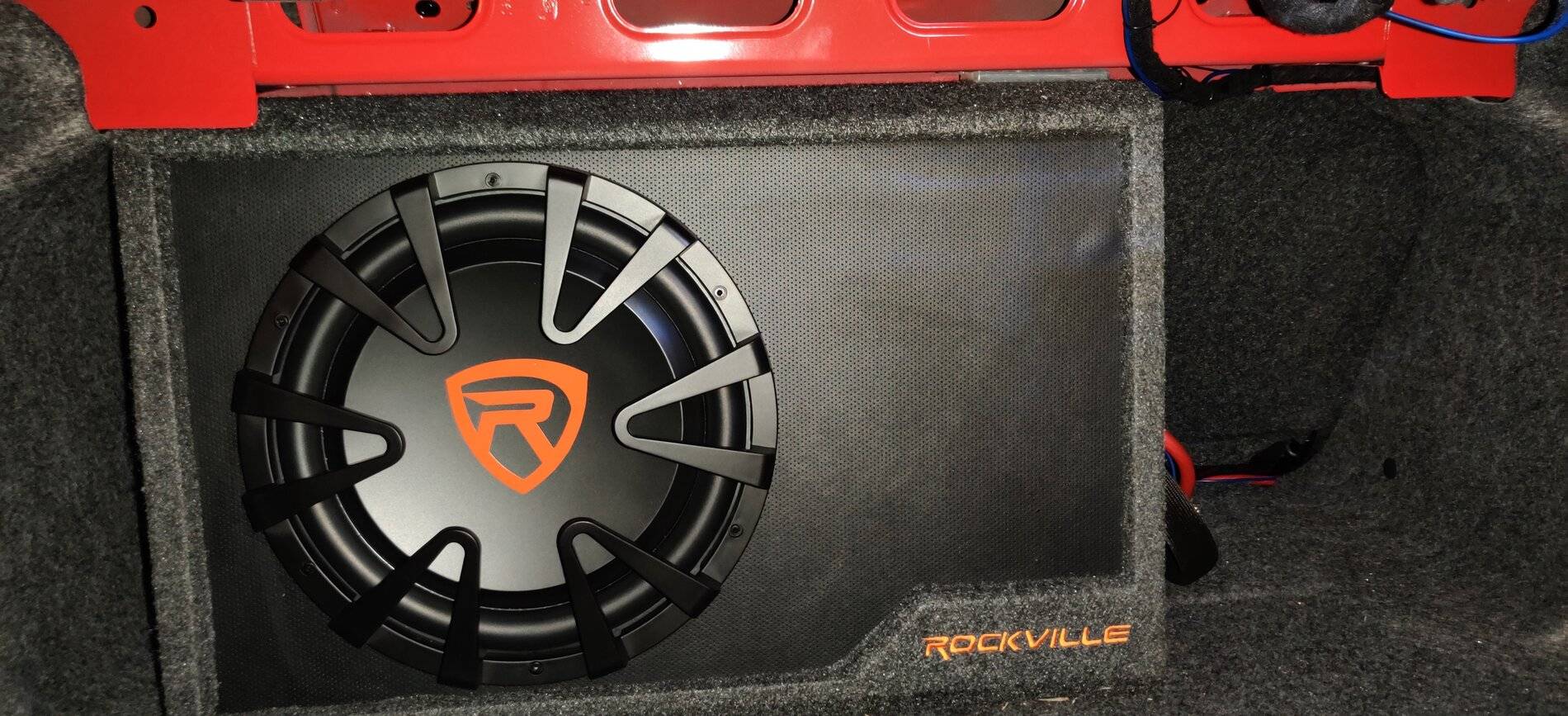

I just installed a subwoofer and I super happy with the results.
Here is what I did.
1) upgraded the door speakers to Kicker 6.5
https://www.stage3motorsports.com/k...-6-5-door-speaker-upgrade-kit-base-audio.html
~ 180$
These have a much cleaner sound than the factor.
2) Rockville RWS12CA Slim 1200 Watt 12"
https://www.amazon.com/gp/product/B01DNT4YBA/ref=ppx_yo_dt_b_asin_title_o08_s00?ie=UTF8&psc=1
This fits perfect just behind the seats, facing the trunk. Speaker is self powered, so less cable mess
I set it to 50% gain, otherwise too gangster for me ;)
~150$
3) Wiring kit is crap on the Sub\Amp so I went with:
TOPSTRONGGEAR 4 Gauge Amp Kit True 4 AWG Amplifier
https://www.amazon.com/gp/product/B07WTTV19N/ref=ppx_yo_dt_b_asin_title_o01_s00?ie=UTF8&psc=1
~38$
4) Since I was going to replace my 4inch unit with an 8 inch, I decided to use a harness kit for the RCA inputs:
2015 - 2020 Ford Mustang 4 OR 8 Inch Screen Non Amplified Base Model Radio Plug & Play Audio Harnesses: Kits Ă— 1
https://plugnplaykits.com/products/...io-harnesses-kits?_pos=2&_sid=7f64f4692&_ss=r
~65$
* Blue remote wire does not work with the harness, amp stays on. I just tapped into the trunk wiring cables , its the blue wire with white strip.
Ground cable tap: I attached a bolt\washer where the spare tire goes, there are two spots to put a screw, this works even with the spare tire.
I Hope this helps someone. The difference with this sub is night and day, even with the seats up.
Here is what I did.
~ 180$
~150$
~38$
~65$
Here is what I did.
~ 180$
~150$
~38$
~65$
