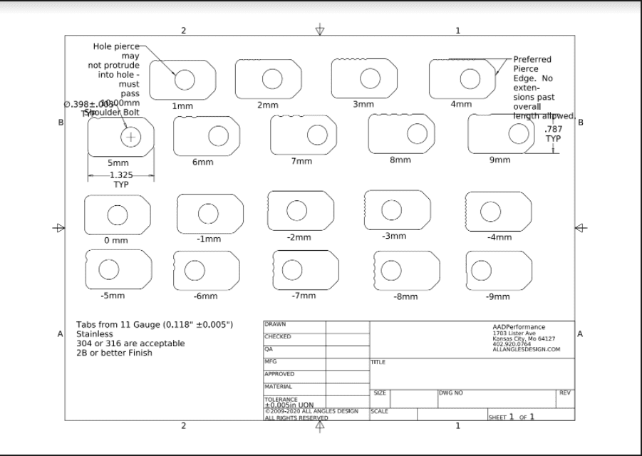

essentially we use a tongue and grove set up, where the end is allowed to slide in this grove. two bolts hold them together, one is purely clamping, the other goes through one of our stainless steel tabs. This locating tab allows us to set the length of the arm. All the tabs are the same size, the location of the bolt hole in the tab changes along the length of the tab. Once a tab is in place, the alignment will never change, unless you change tabs
As you can see in this drawing, If you have anymore questions or confusion about this system, Dm me and we can chat. -Graham
Thanks - so this is a "discrete" (non-continues) adjustment - you have to swap these tabs to adjust the camber ?
What's the range of adjustment (in degrees) between 9mm and -9mm tab ? And how do you an alignment procedure going given toe and camber are inter-dependent and you have to iterate if you want them perfectly set ?
How do you lock out (if at all) inboard mount to prevent sliding ?
Correct it’s a discrete “fixed” adjustable. You use the tabs to adjust
The tabs are available from -9mm to +9mm in .5mm increments.
camber adjustments will change toe, toe will not effect camber. Set camber. Adjust toe accordingly (we also have toe links available that adjust the same way)
Lock outs are included in every kit that requires them I.e camber and toe
