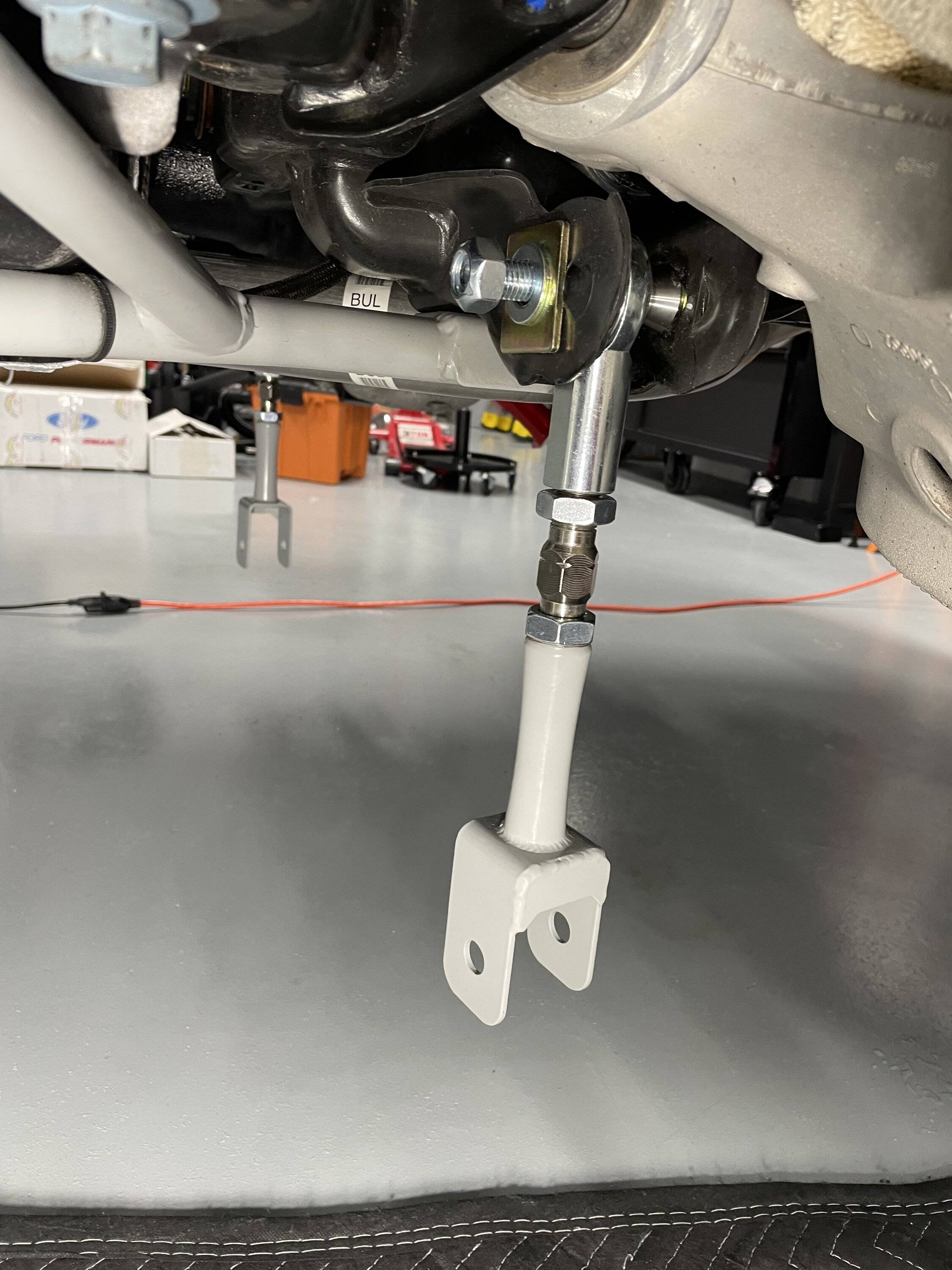

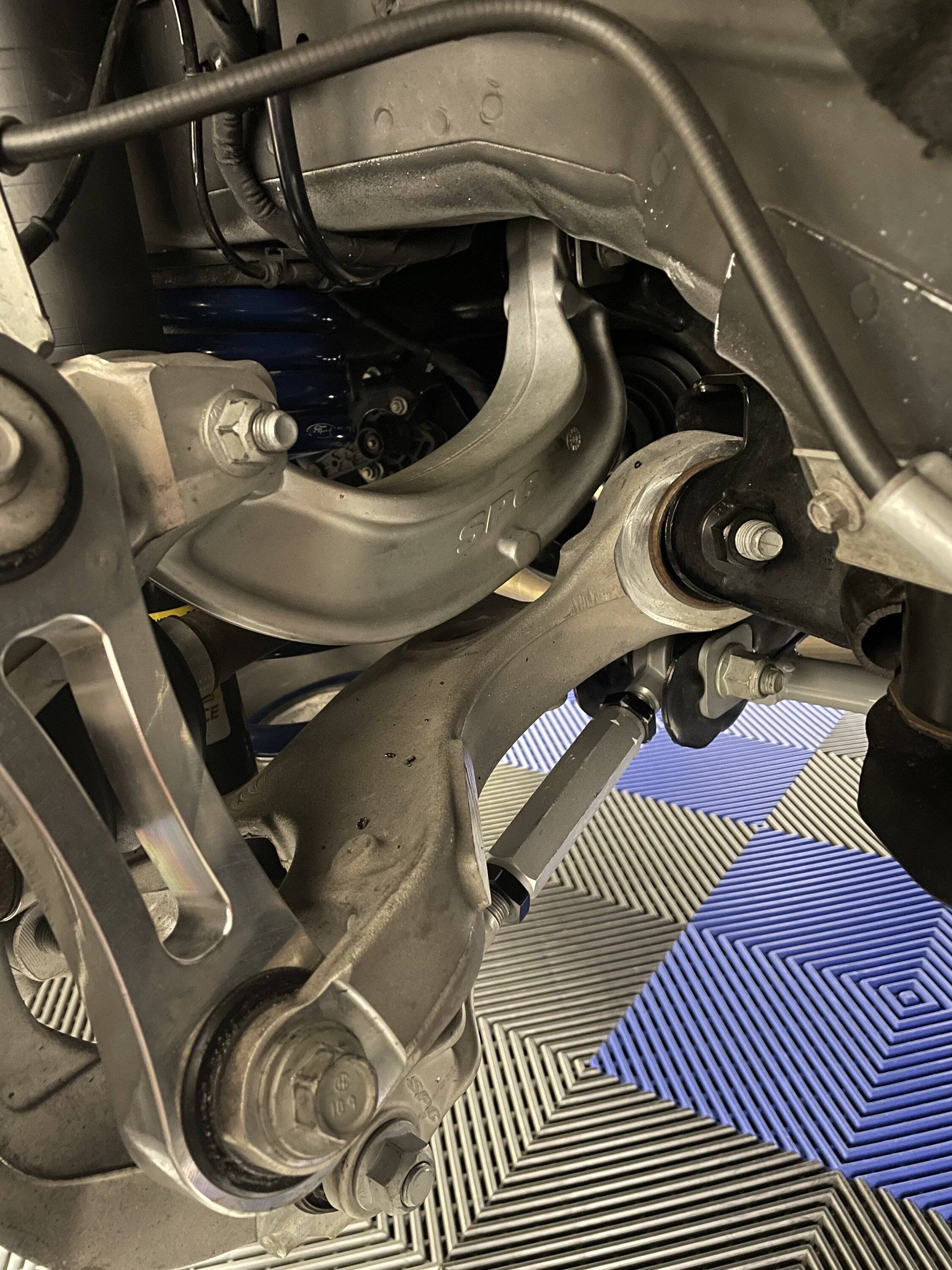

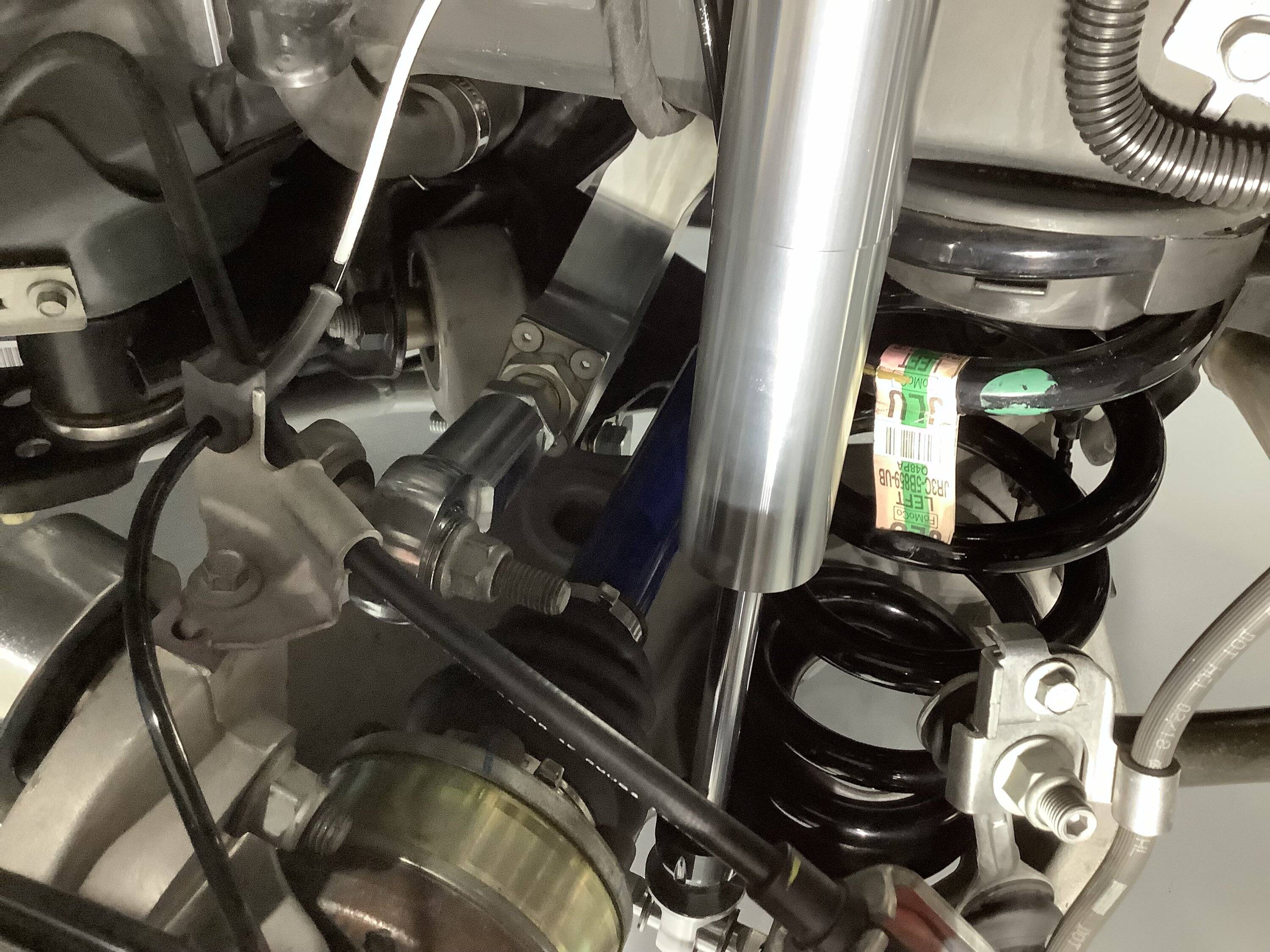

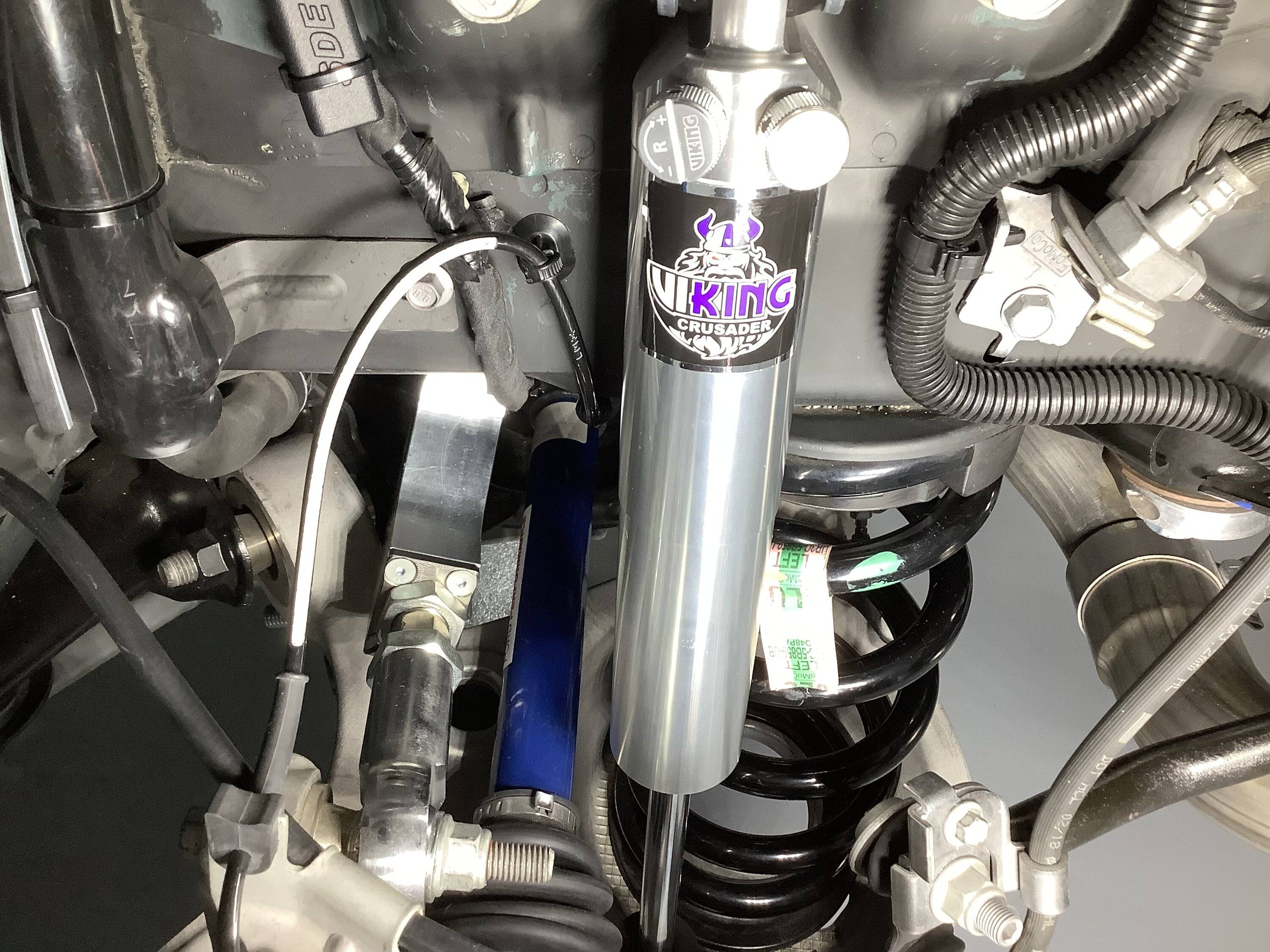

Great part! I’ve had them on my car paired with a BMR camber lockout kit for about 17 months.
There wasn’t any noise at all until after I installed KellTrac Ultra Spec Viking drag shocks, but I was expecting that, as the product description indicates the shocks will add noise.

Yes, the noise is from the shocks. I do drive the car on the street, but it’s not a daily. I’ve probably put about 1300-1400 miles on the car since I’ve installed the camber arms. I also have their adj. toe links on the car. I installed those at the same time.
I live in Parrish Florida.

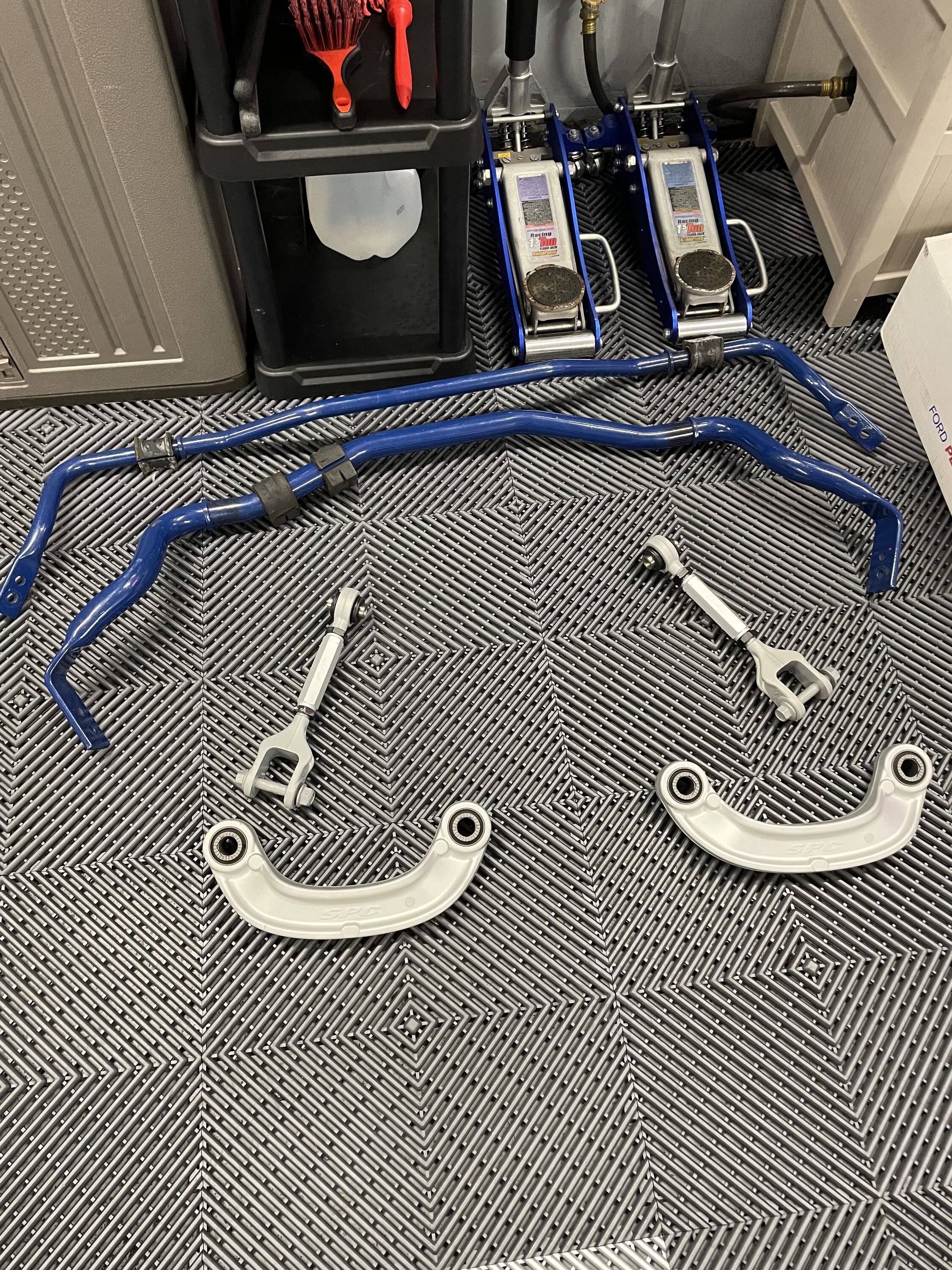

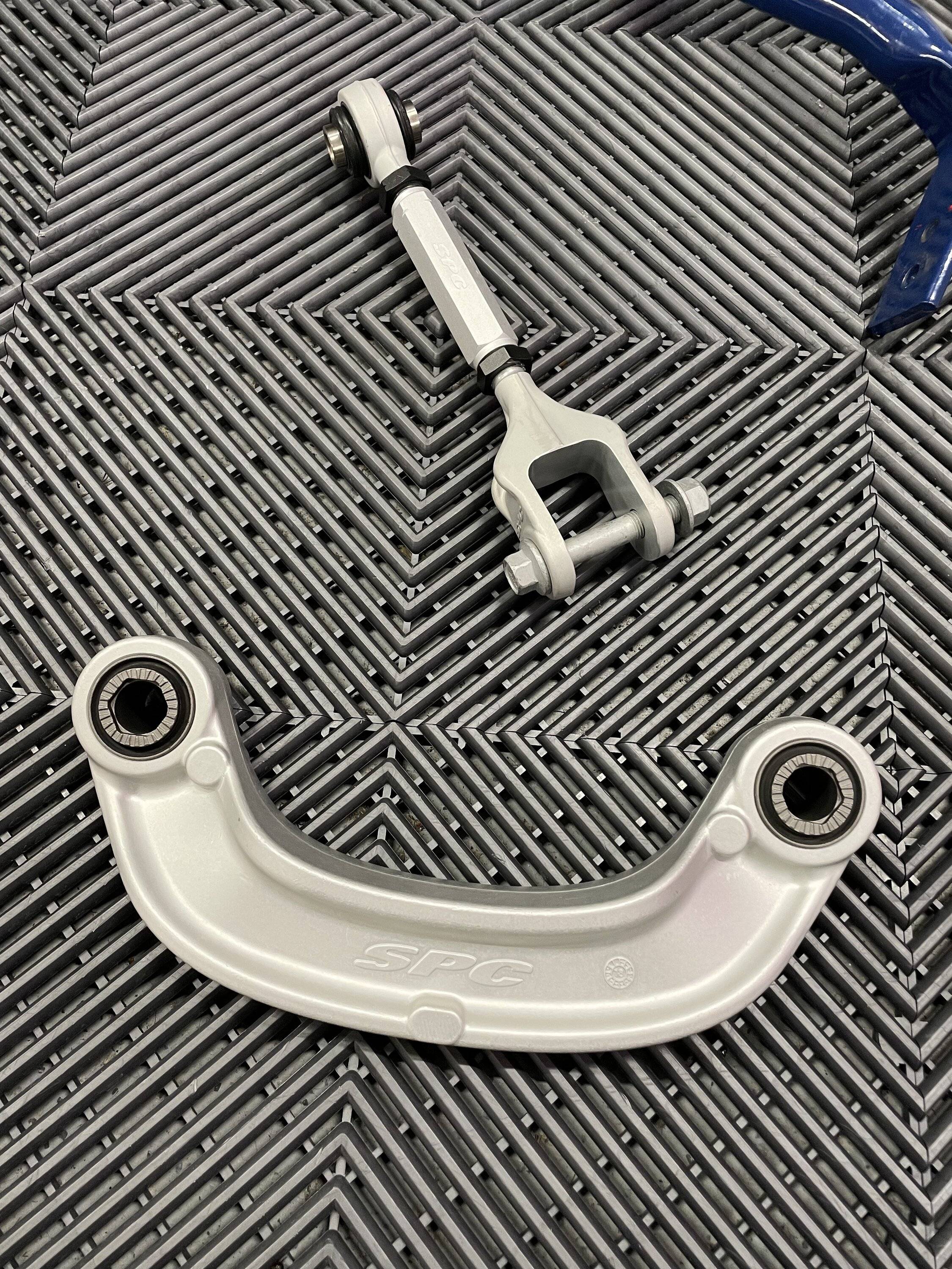

It is my understanding and homework that anything with spherical ends runs the risk of some type of noise and/or clunking. That drove me to the SPC arms. really don't know much difference, but couldn't be happier. These were recommended by a very trusted member over in the 350 section who swears by these on what's a pretty much full time race car. He even had FTB before the SPC and recommended the SPC.

SPC is another one I am considering. How far into negative camber can you go in the rear with these? I see they use an eccentric for adjusting. Really cool looking pieces, man.

Soooo, on the inboard side, they have an insert that you select between a few different positions with, before install. There's a worksheet and you gotta do a little math ahead of time (the sheet helps you figure it out). It establishes a baseline/ballpark camber setting. But when the inboard bolt is in place, it's in place. There's zero movement within the factory slot. Then the outboard bolt is on a cam that makes the final fine tuning adjustments. If memory calls, once you're in the ballpark of what camber you want (by setting up the inboard bolt), the outer eccentric will then give you right around +- 1°, or something close to that. TOTAL camber capability with these is a pretty descent spread. You're not gonna be short on capability with these.
It's way simpler than I'm probably making it sound.
I just installed these shock too and have noise but just from passenger rear I hear.
