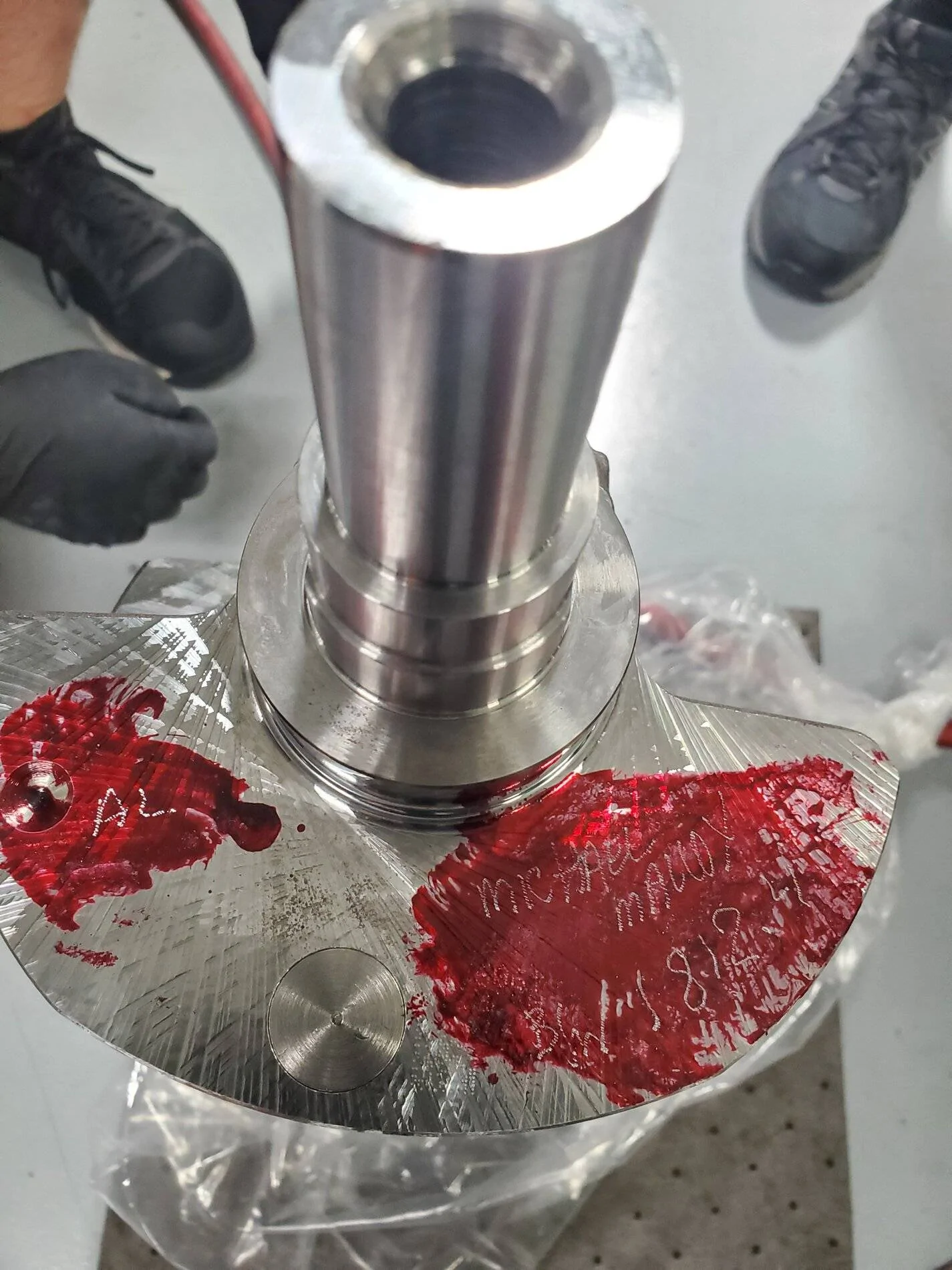

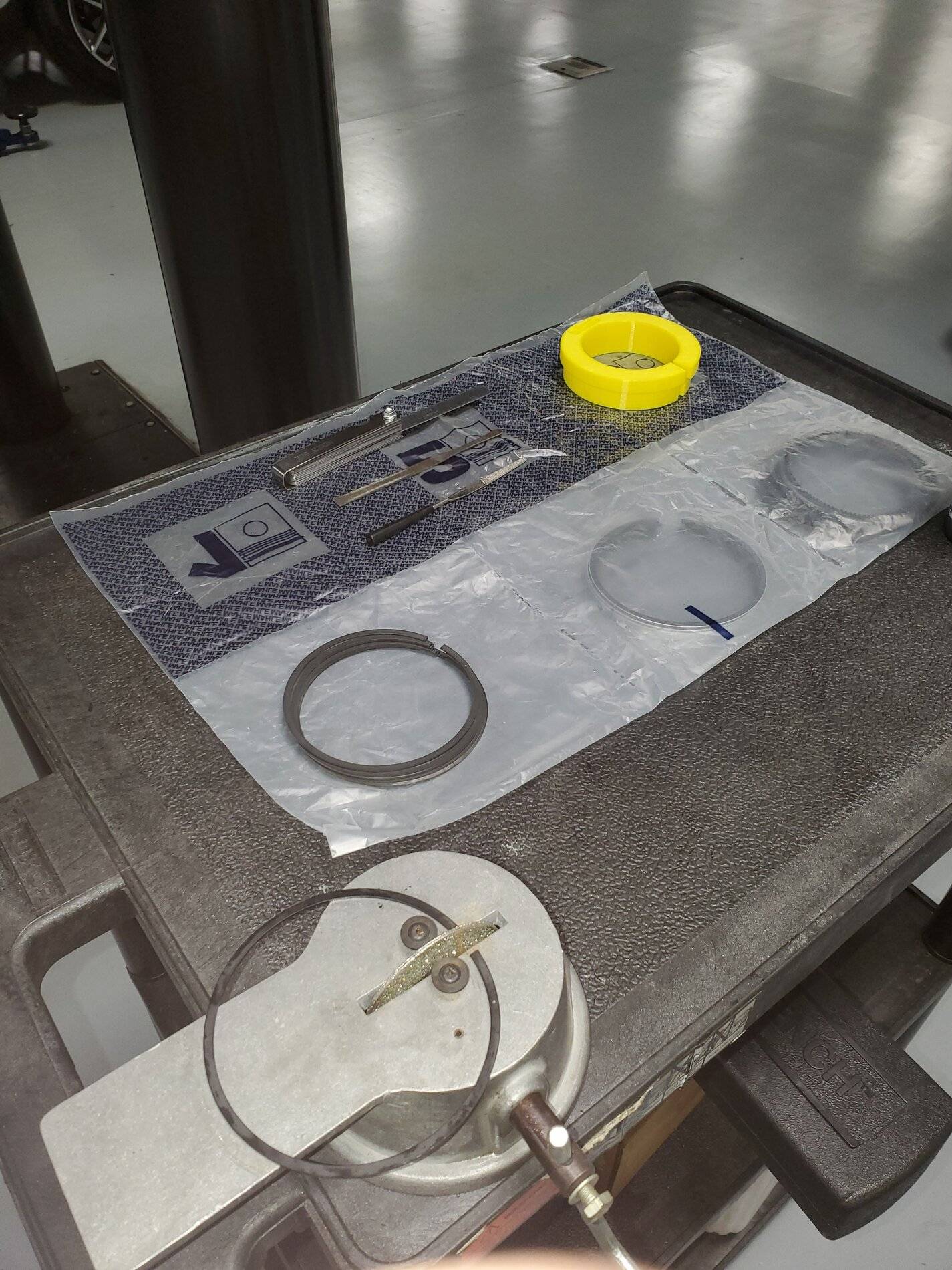

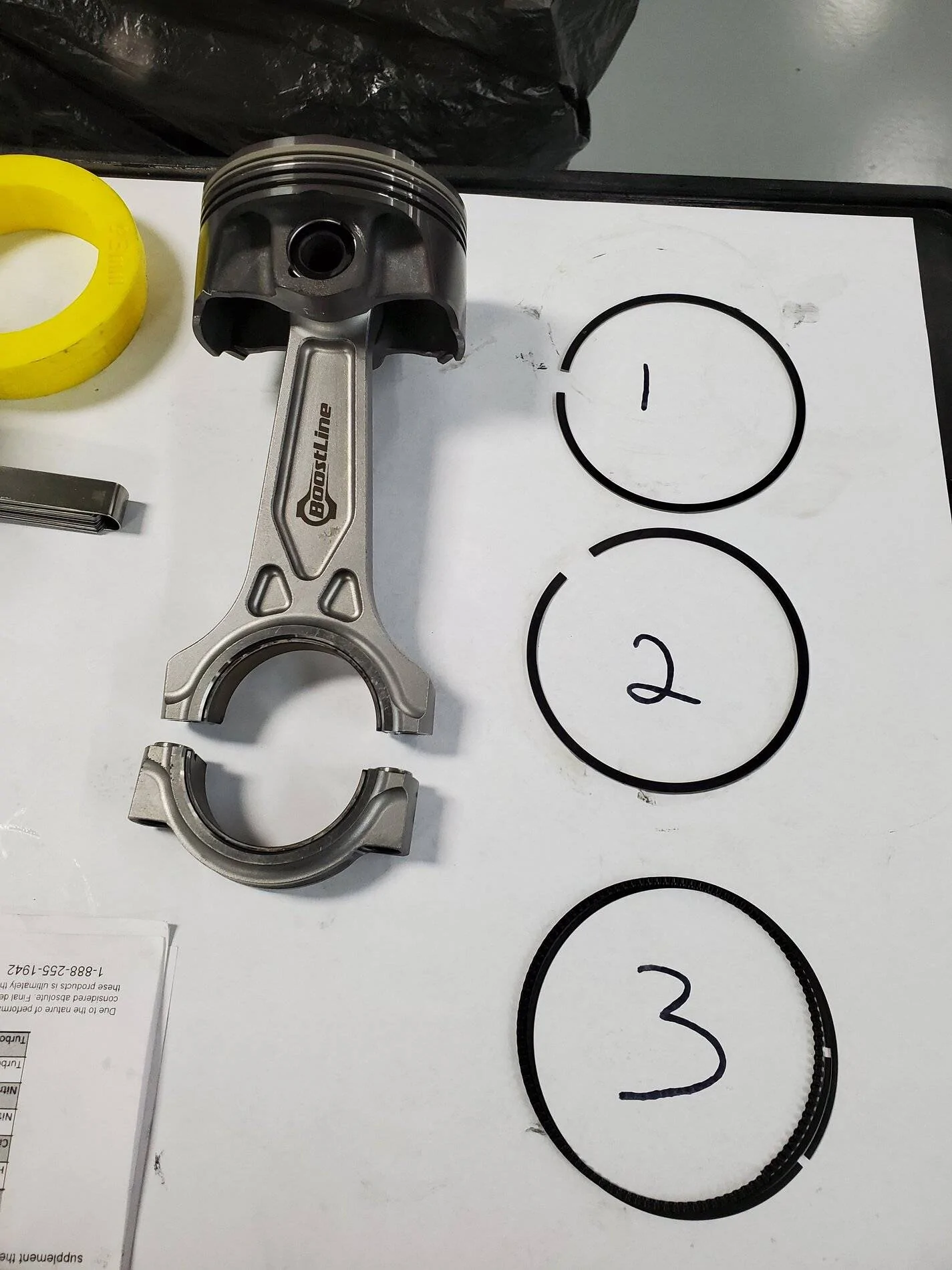

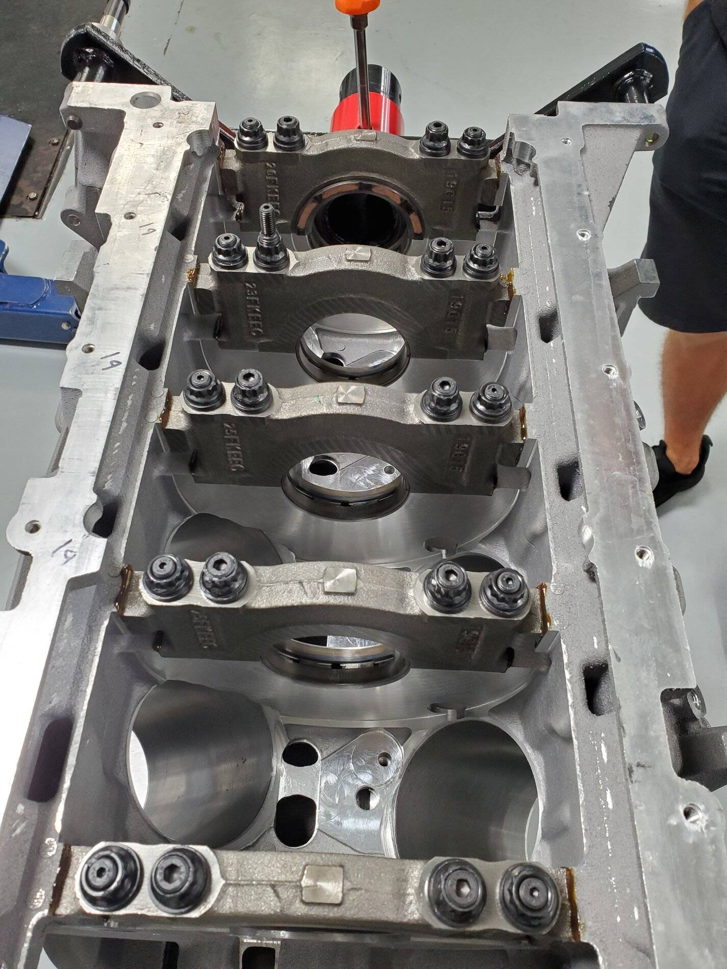

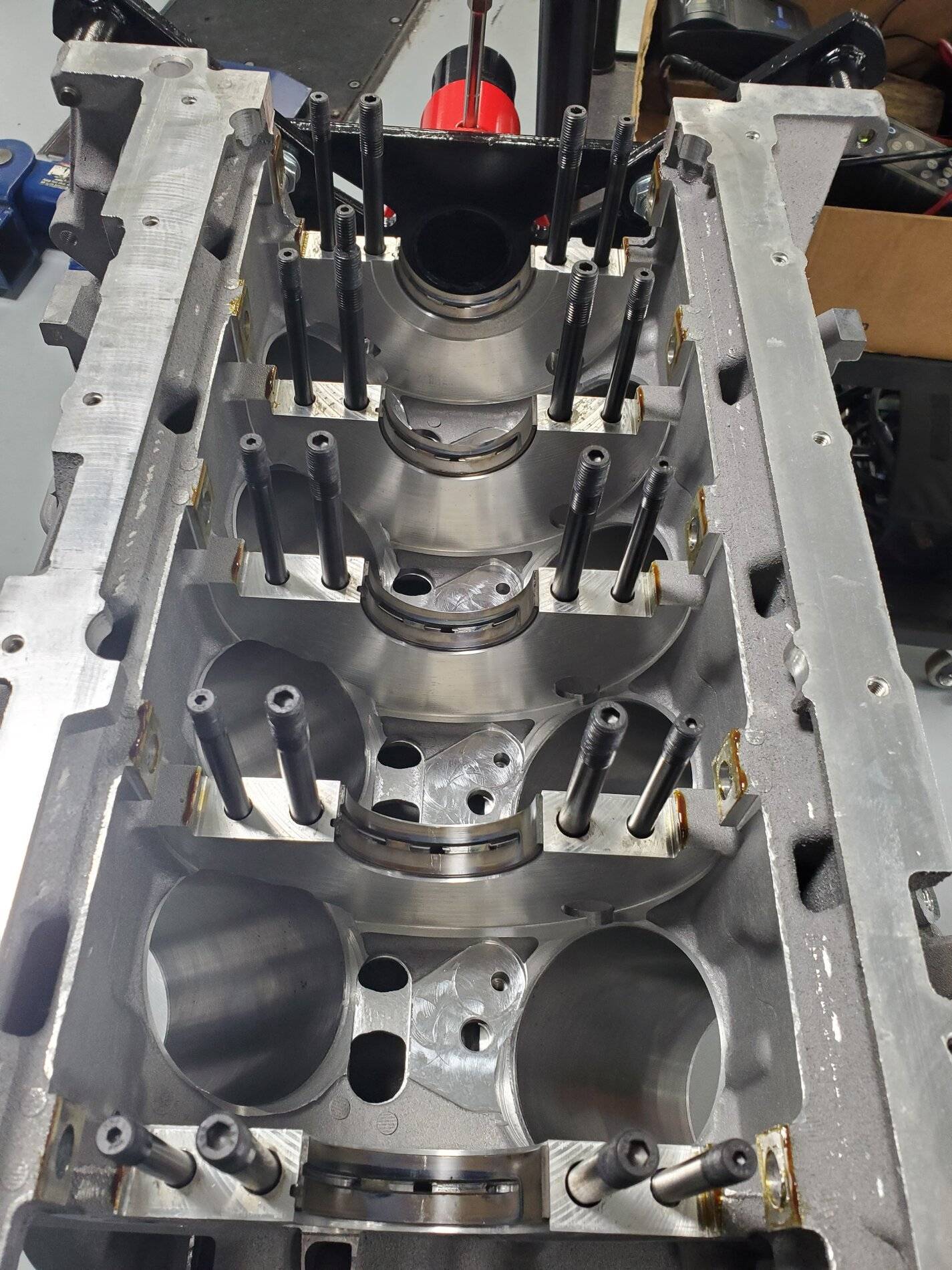

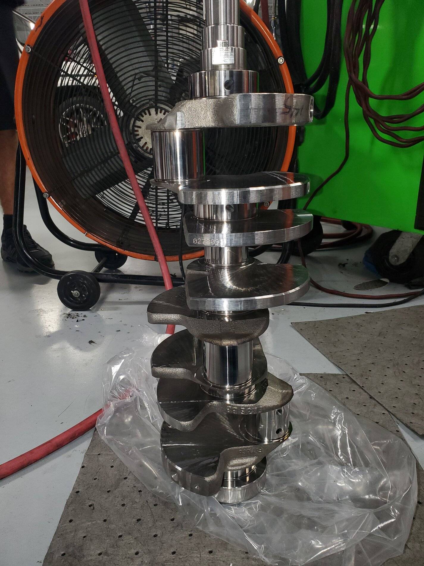

Compstar rods only need 5grams removed from the big end to be in spec with boss crankshaft and Mahle pistons. Boostline rods need nothing. Remember they don’t have to weight the same. They have to have a bob weight within spec. Compstar rods are heavier on the big end but lighter on the small end. This makes a big difference for bob weight

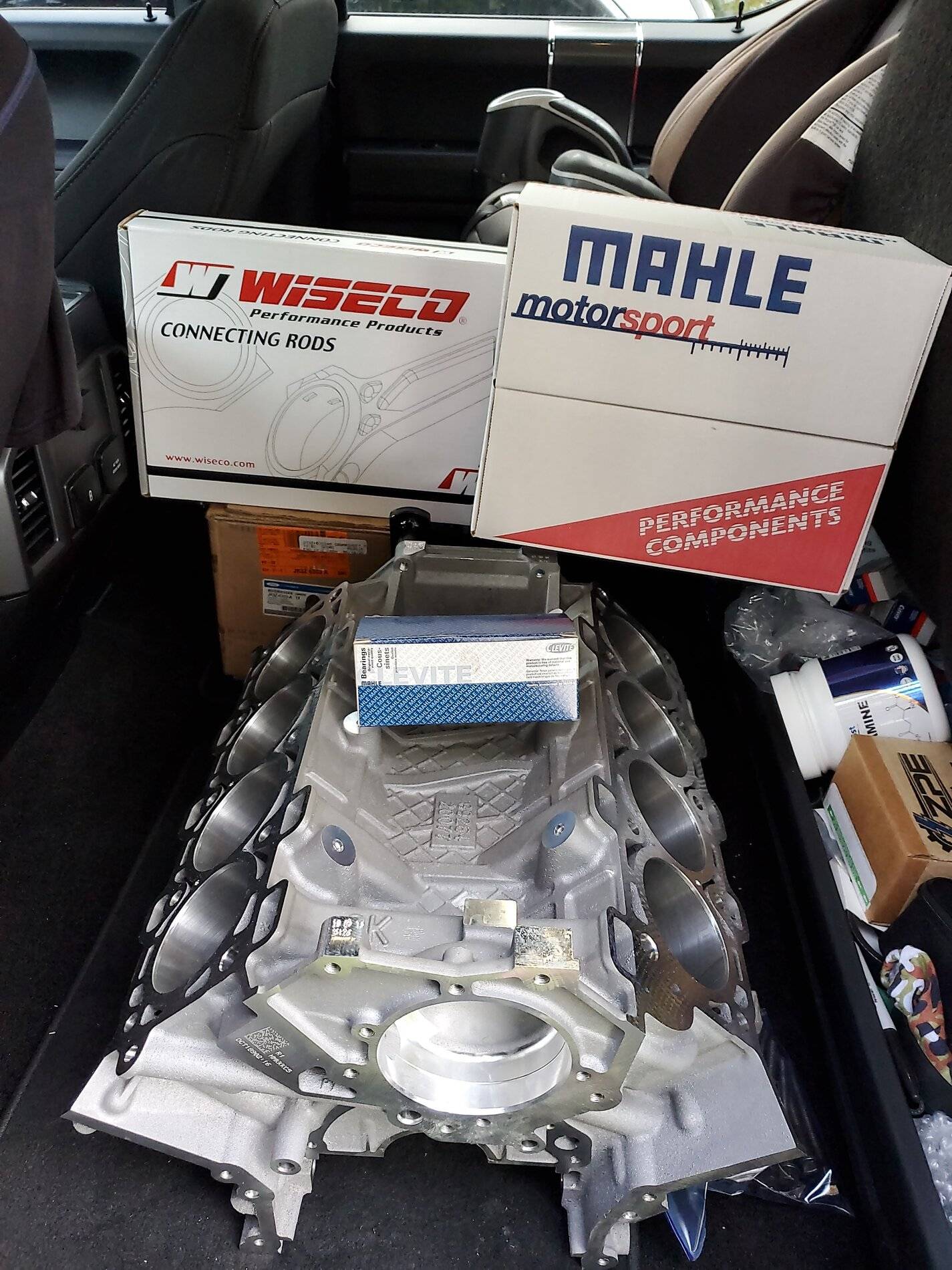

are you friggin kidding me... Tim@MPR had to add 2 heavy slugs to a brand new crank for my boostline rods.. The wiecso rods are very heavy for what they are. why would you try to nickle and dime a performance build. even my brand new block needed machining as they are not square from the factory. I'm all for saving cash, but some times you gotta pay to play. I've been a professional wrench for 20yrs and I know when I'm being taken advantage of. I had no intentions of spending money on brand new block until I was educated. And I'm local so me and tim, which I have used in the past had a face to face and showed me how even new parts need work... espesically when your shooting for 4 digit numbers.

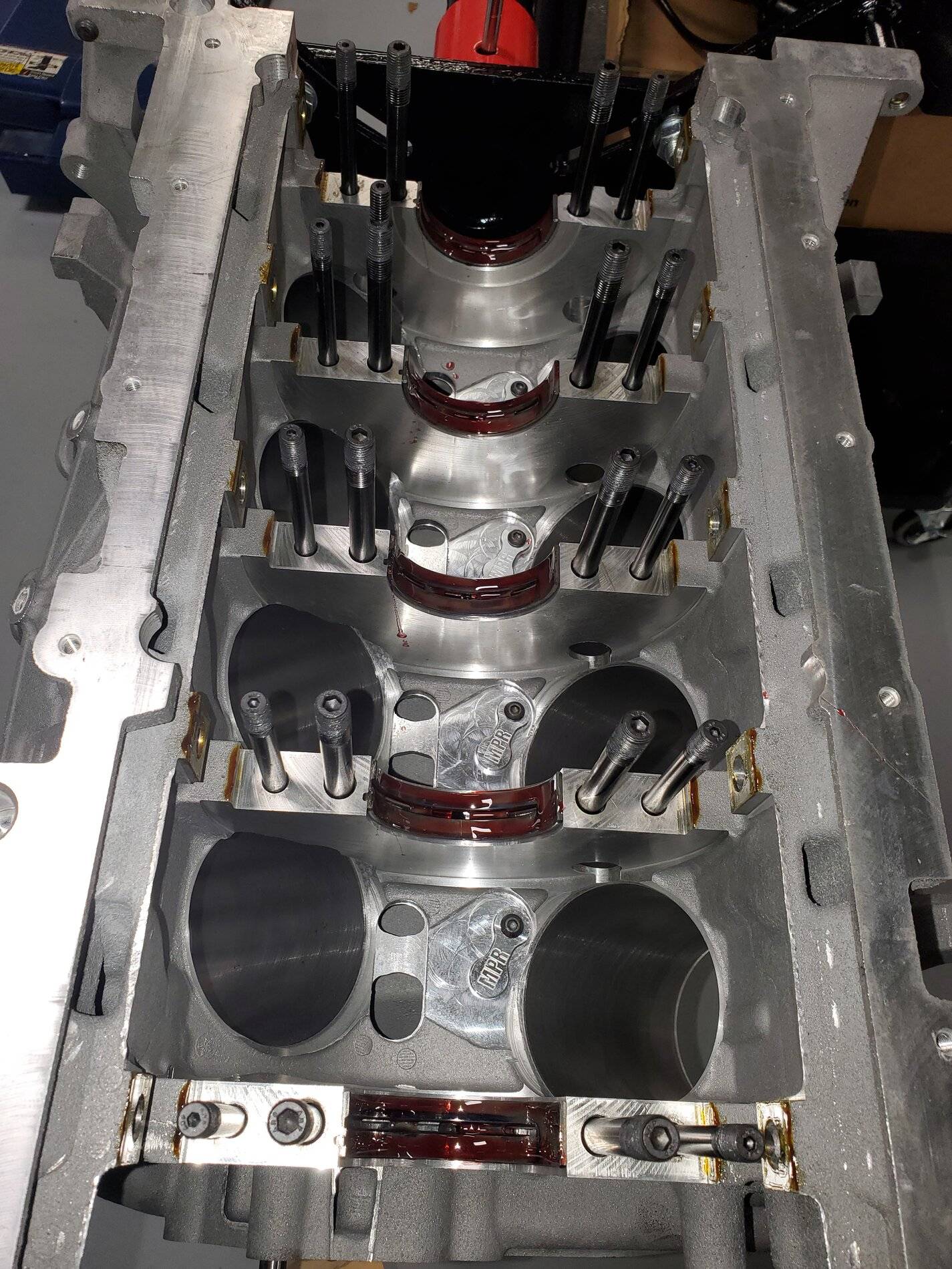

Beautiful pics .
what block is that ?
Gen 3 coyote or 5.2 ?
