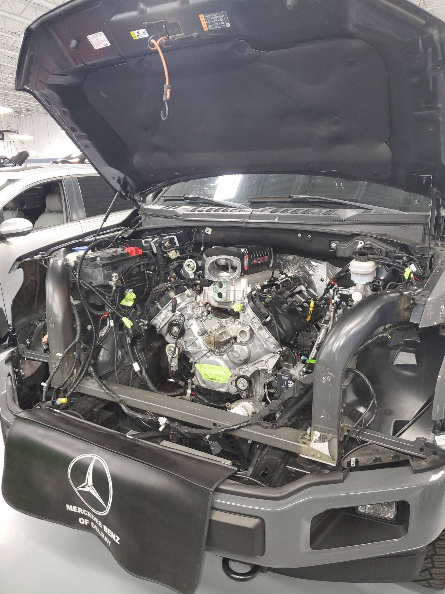

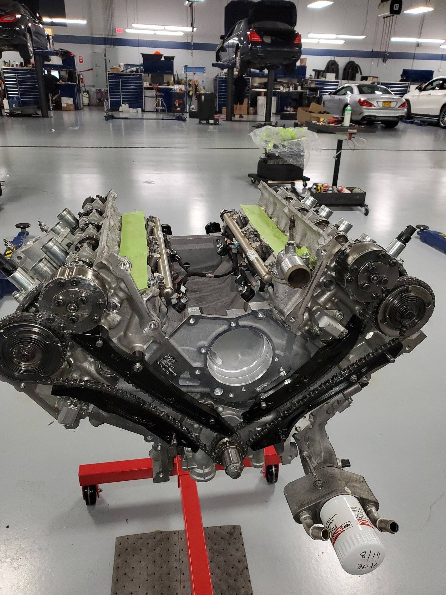

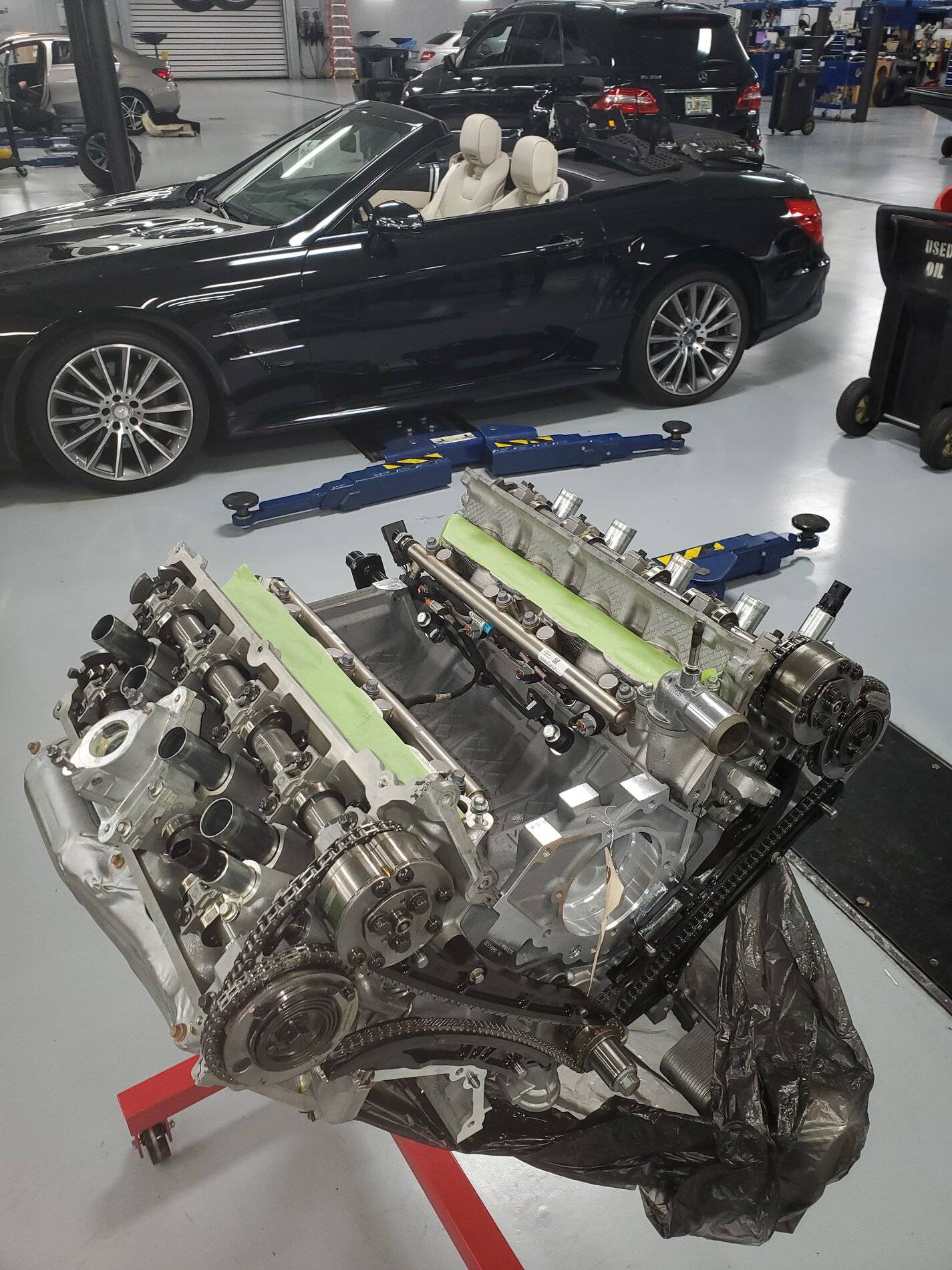

I think what I was trying to get across is there is alot of hidden cost that go into a build. Here are some prime examples.
-a new block does NOT come with a doweling kit or any of the core plugs install. expect 100.00 right there.
-there is also shipping on most of these items. I purchased locally with an employee discount and still still cost close to a 1000.00 with tax.
-if you plan on running any aftermarket piston, you will need oil squirter block-offs. 75.00$
- torque to yield bolts for the valve train and block will set you back another 100.00 or so.
- not a requirement but highly recommended--- boss302 chain tensioners. 100.00
when its all said and done expect to pay close to 5k for a COMPLETE engine without sleeves or headwork.. I went with upgraded valve springs and comp cam timing chains so I could spin this motor up to 8500. I also did all the labor myself, minus the machine work. In the end, 5K for an engine that can live at 1100whp is a deal in my book .
here is my setup about done and she is running good...

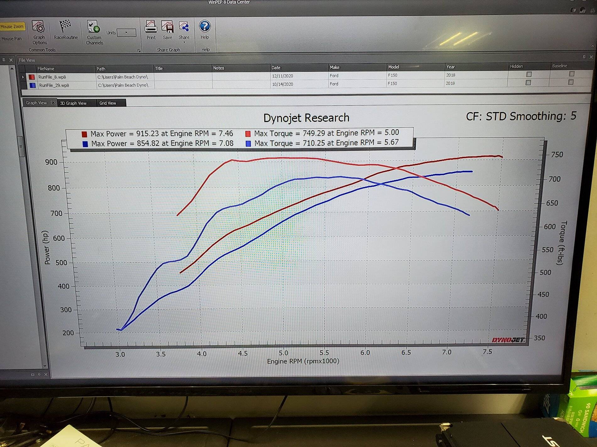

first tuning session at PBD on this setup.. ( i'm down the road from them) Remember it's a 4 door truck and not a mustang. she is a real blast to drive.. hopefully my 5700lb whale will see 9's tommorow.... ( 10.45 is my current best)
