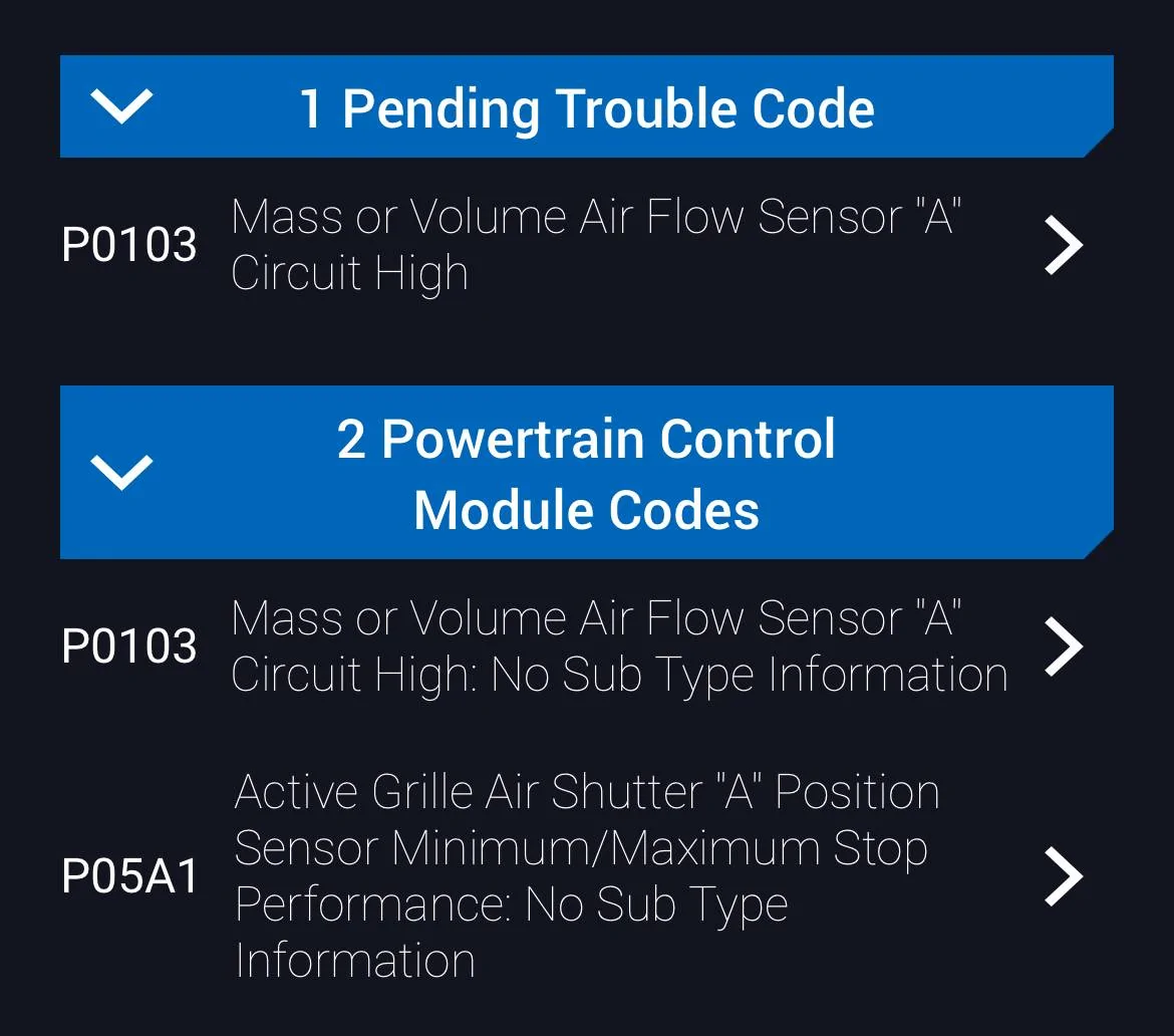

Did you observe any error codes after each incident? Anything at all?
I read for codes immediately after I let her cool down for 20 minutes:
The Active Grill code is expected since I removed them but zip-tied the motor to the front crash bar.
Not sure the MAF code has anything to do with the AdvanceTrac message 🤷

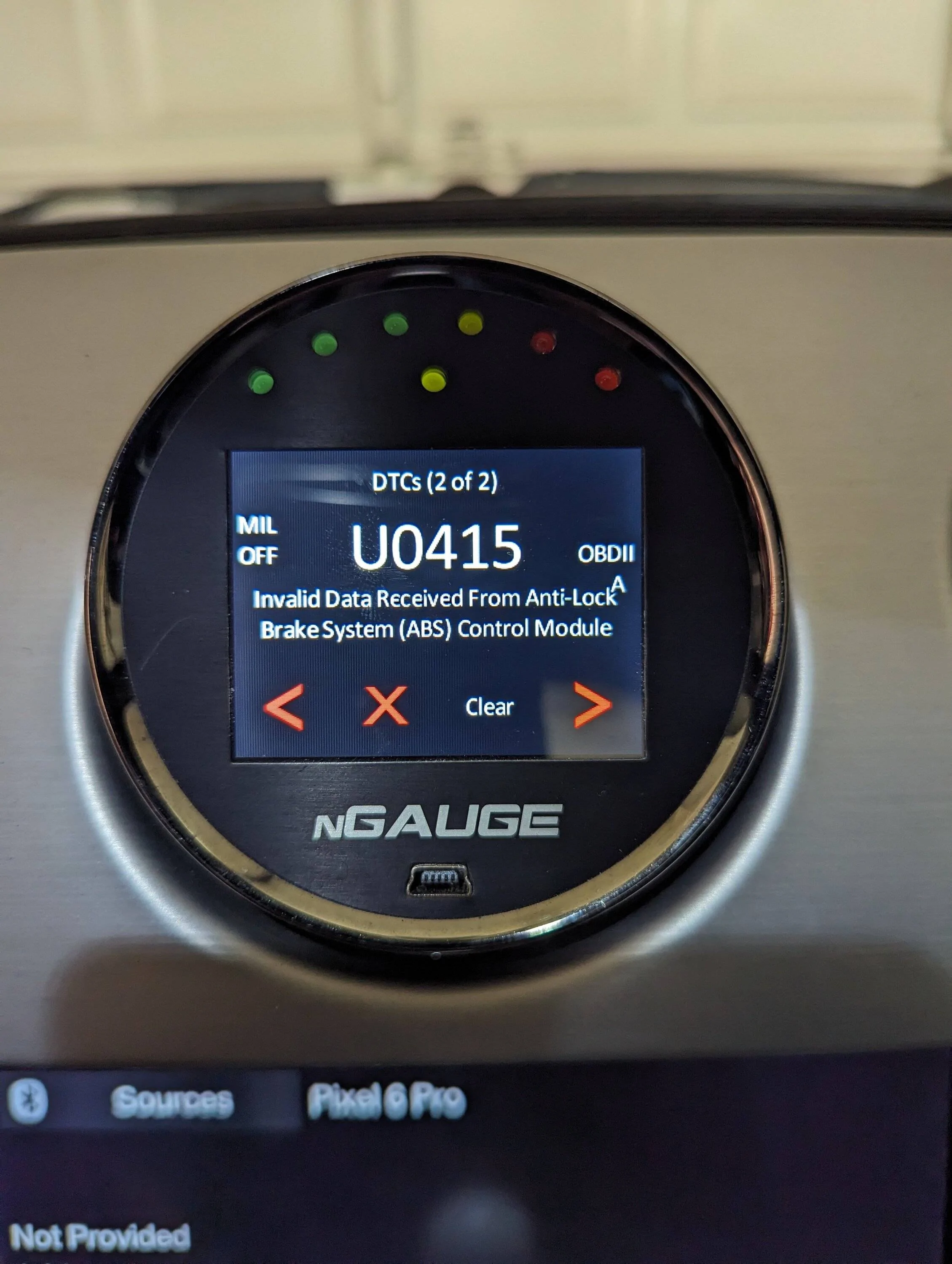

K so shook the hell outta the wheel(s). No movement. Checked the codes U0415.
