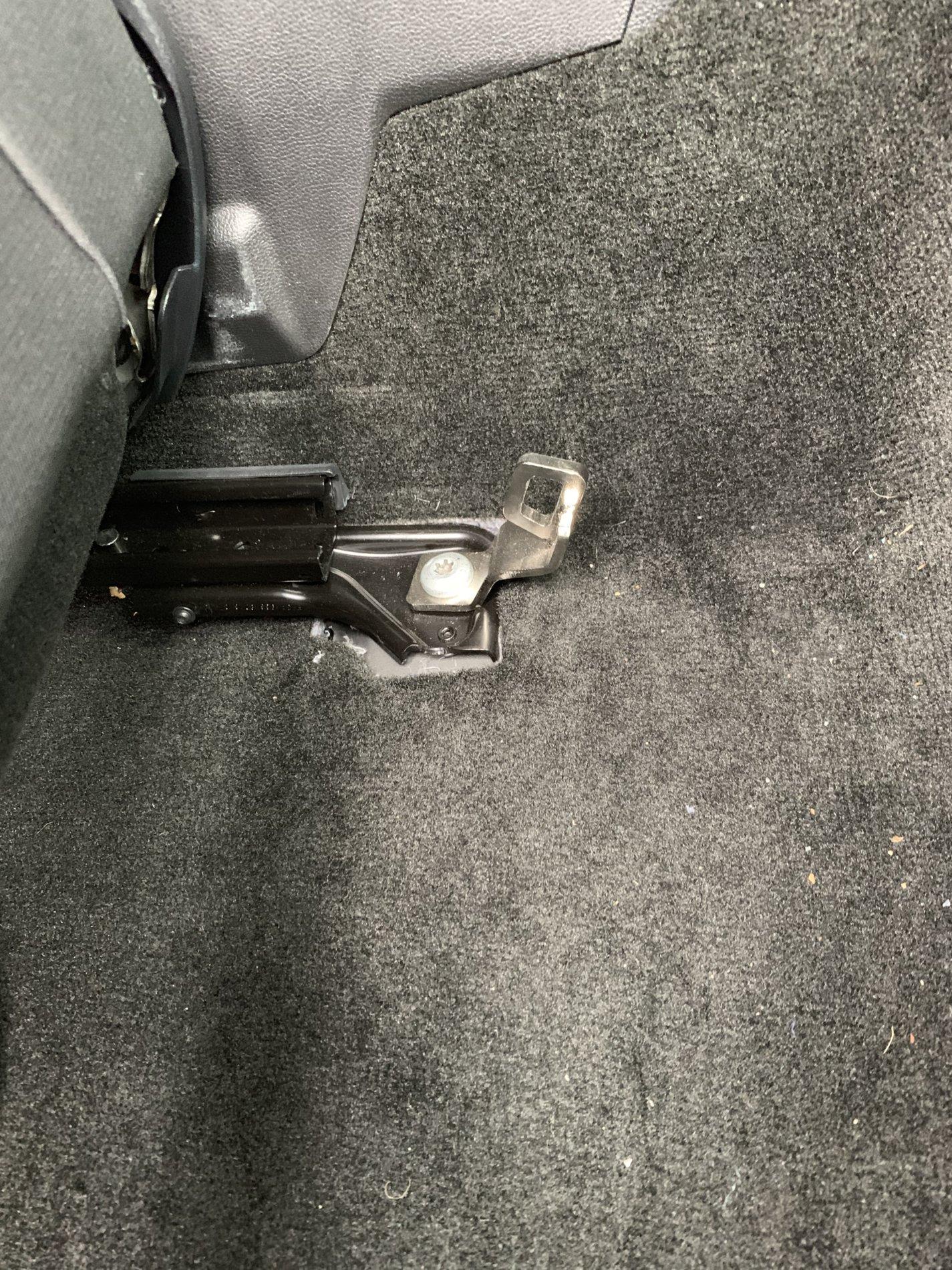

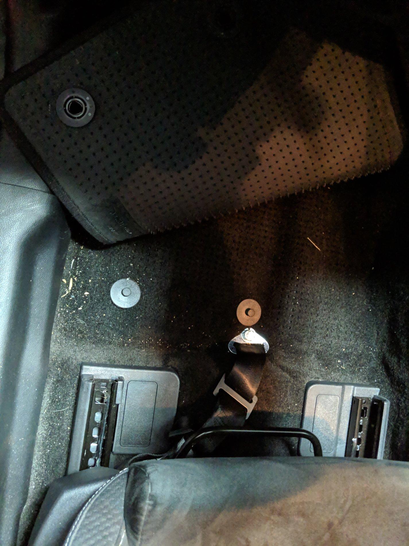

Excellent, thanks! Do you happen to have a pic on how far back on the floor you installed? How much available belt there is for mounting? Using the factory seats?
This is a picture of the floor where I mounted it. Note that the seat is all the way back and the floor mat is pulled back in this picture so you can see where the mount is. I is right beside where the little hump starts. There is loads of belt left for adjustment. You could do with half the belt!
I hope this helps!

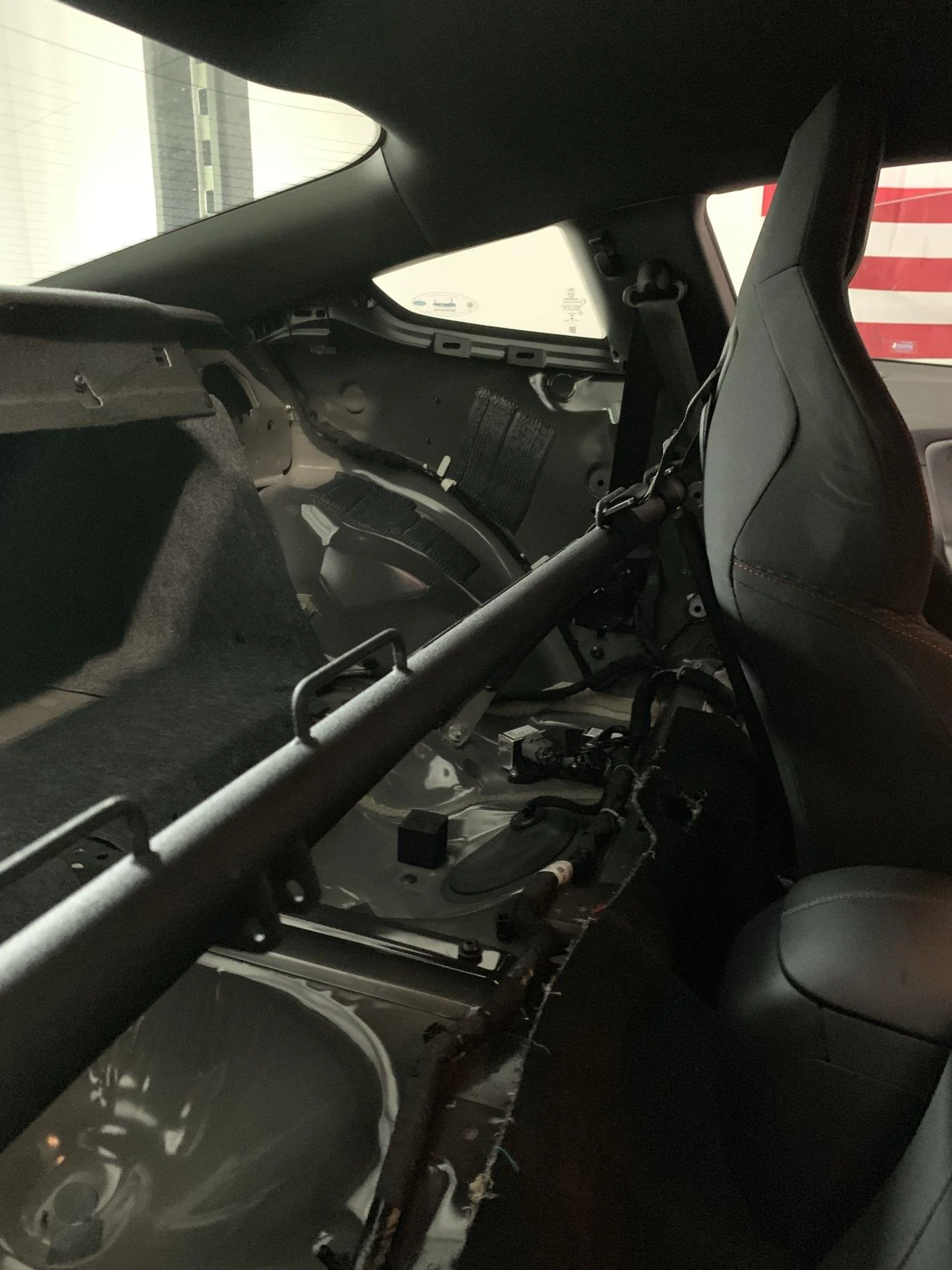

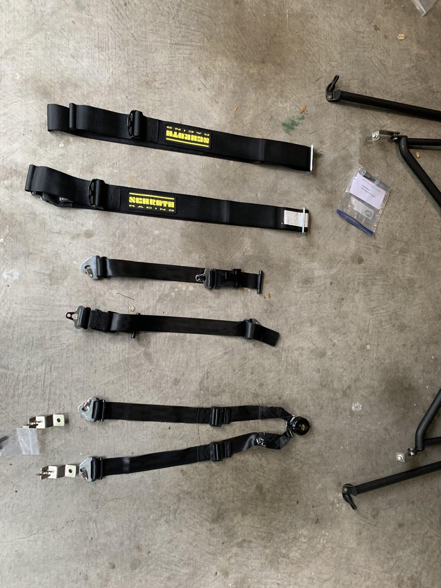

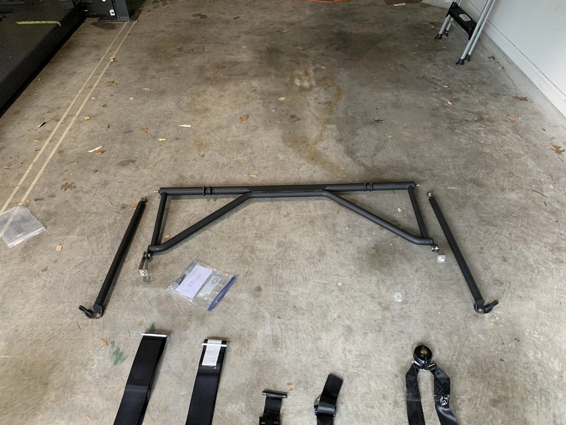

I am selling my set up that is not seat belt or model year dependent. No mods needed.
Bolt in harness bar(Brey Krause)
6 point harness with anchors
Used 6 months
PM for details or questions

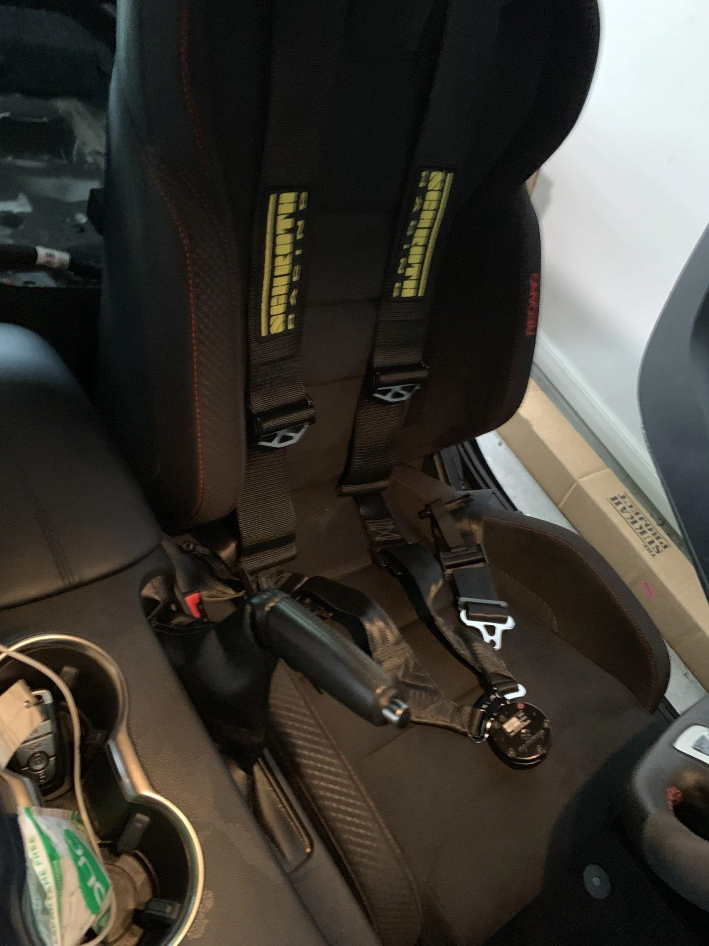

I never put the plastic piece back or the cover to the trunk. I just tracked this thing.
As I remember you would have to cut the plastic trim to make it fit. I would not modify the brackets.
The belt with the round buckle functions as sub belt. It runs between the bottom and back of the seat and attaches to brackets that attach to the rear of the seat track as pictured
