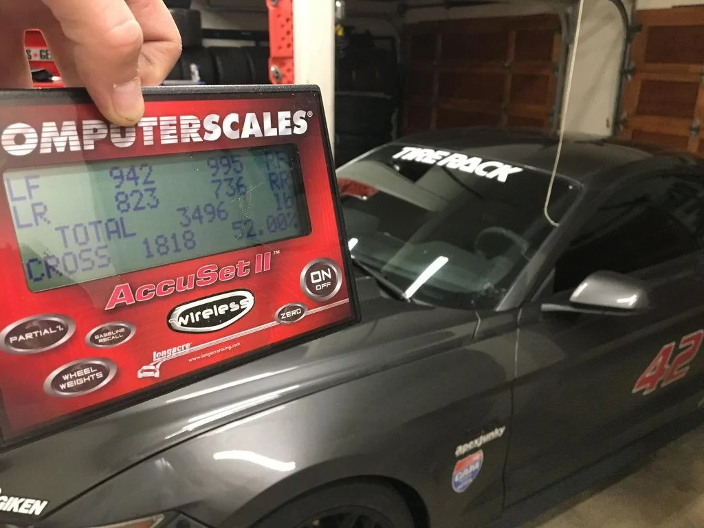

lots of prep the past few weeks (and trials/tribulations sprinkled throughout), but time to celebrate tonight - finally sub-3500!! nevermind the corner weights though (didn't level):
on a 1/4 tank of gas too - won't need that much with the BAP i added last season. still have a about 15lbs/corner in the rear to drop too from the springs. soon..
Do you have a build thread that covers your weight loss?

lol, no worries.
i've never been much for dedicated build threads, but don't mind seeding these autox-related topics with details of the path i'm on - in hopes that it inspires more ambitious builds and resulting competition :)
