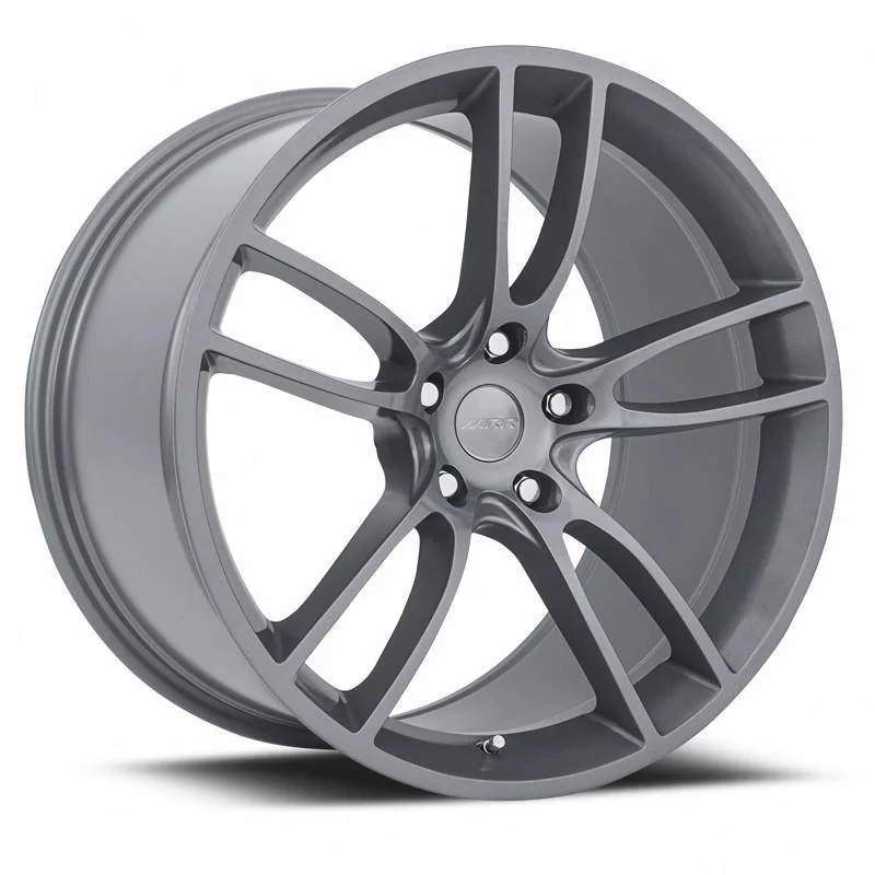

And they are here! Looks like I'll be getting that splitter extension afterall.

I'll have a serious set of wheels for this season of autocross...19x11 square with 305 'stones. Planning on making my first trip to Solo Nats too.
Nice! Did you find a deal on them somewhere this week?
I'm looking at 2ea in 11.5 to go with the two SVE GT7 wheels in 11.5" that I have now.
About time . . . :like: :clap:
That I did. Far too good to pass on. I wasn't planning on buying till after bonus money came in February but I couldn't miss this.
Now I just need some proper CAMC spring rates and the accompanying dampers. :captain:
I think for this year I may stick with my current setup and plan on diving into the really good stuff next year. We'll see!
