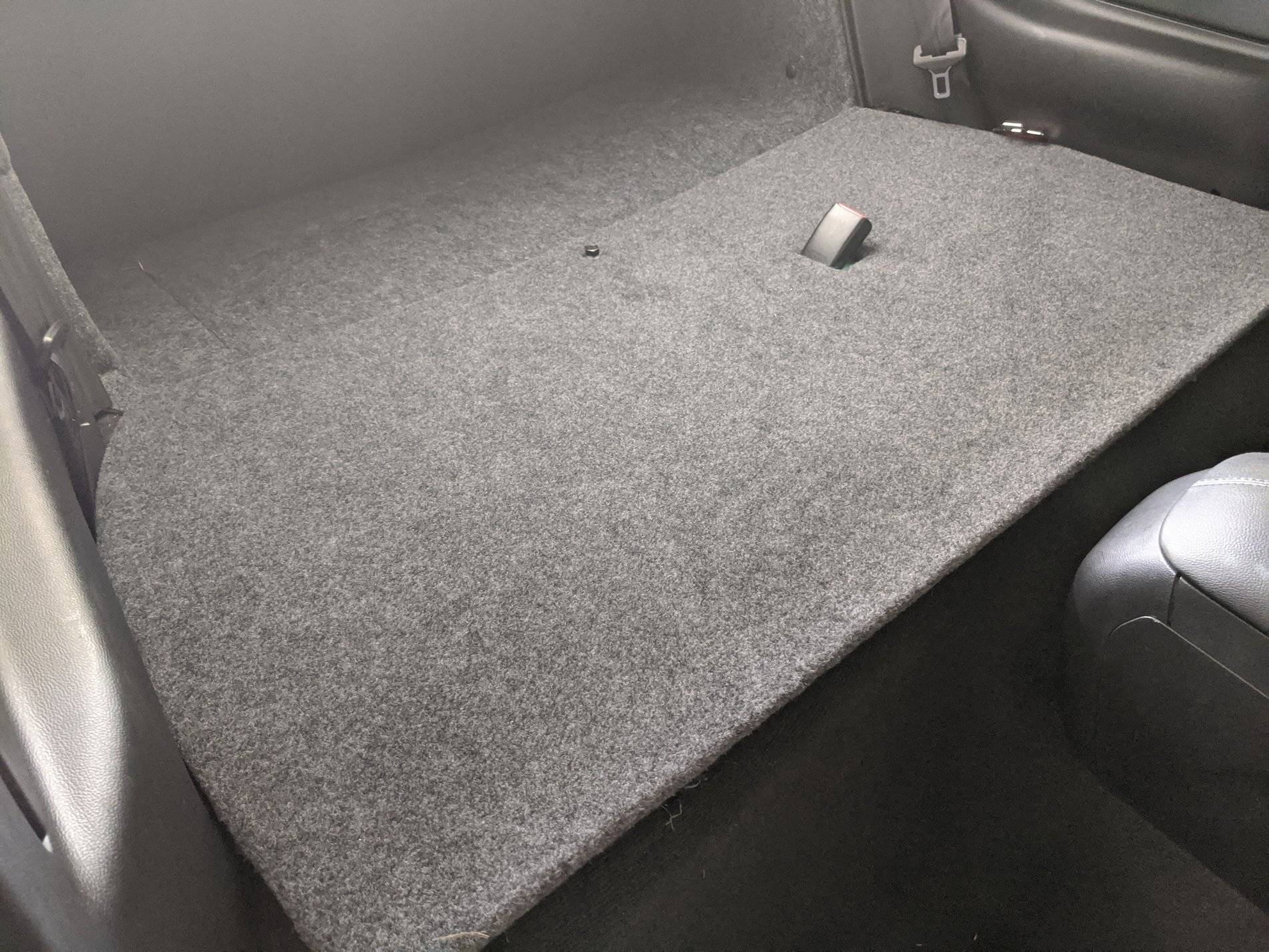

What did you guys do with rear seat ? Or specifically - if you removed it, what did you put in instead if anything ? I honestly would like to remove it to create some more space for carrying wheels to the event but also cover bare metal under the seat bottom..... Seat deletes solutions (which are one piece) don't see to allow too much flexibility...

While my '08 isn't a CAM build, it does get loaded down with quite a collection of track day stuff, so I've occasionally considered doing a rear seat delete.
I have two concerns . . . anything that eliminates the wells under the rear seat is going to cost volume and shape that can be downright useful when you're using the back seat area for carrying tires. And whatever the kit arrangement might be, it would have to provide a foldable panel to at least visually close off the trunk from the passenger compartment, and ideally provide a level of protection against exhaust fumes comparable to the OE seatback.

Coming back to this - why do you think you want the panel to close off the trunk area ?
Flat panel that eliminates wells under the rear seat gets you actually way more space than you've had before - mostly because of how thick the seat bottom structure is. How do I know that ? I've made a DYI delete with plywood, trunk liner off ebay and some high density foam from Joanne's Fabrics of all places stuffed in the wells to provide some support while transporting the wheels. Tell me this doesn't look nice ;-) And it was super cheap...
I'll soon start mass production and start selling them for $100 a piece.... (Joke of course).
Looks great! Nice job.
One reason for a panel to close off the trunk is to reduce drone and perhaps keep trunk junk from visiting you up front in a sudden stop if you drive it on the street much. To each their own, though.
Mainly to keep stuff in the trunk hidden from prying eyes the rest of the time. I have to admit I hadn't specifically considered the matter of trunk junk maybe not staying in the trunk, or anything about the potential for drone at all.
Of course (and not having a seat back either still in place or folded down adds a good bit of useful volume as well). Me, I'd rather use the wells under the rear seat cushion as more storage volume / storage options for the stuff I'm trying to make fit inside the car. I've pulled the rear seat cushion for a number of track days for that reason.
Came out nice, and I like the attitude that went into putting it together.
I've thought about creating some sort of rear seat delete a couple of times myself, without ever getting far enough into the details to do any actual work. It's usually a good thing if I don't go running off in the first direction I think might work . . .
Norm
