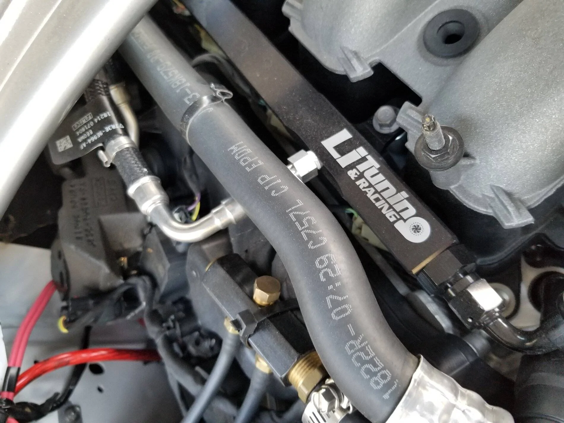

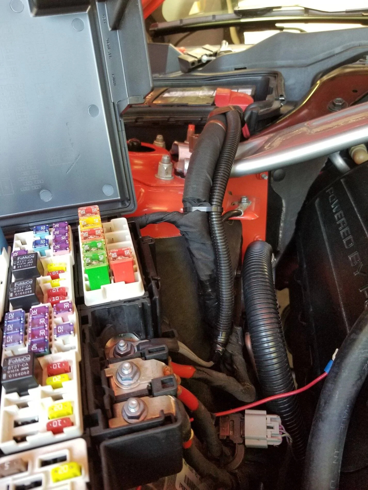

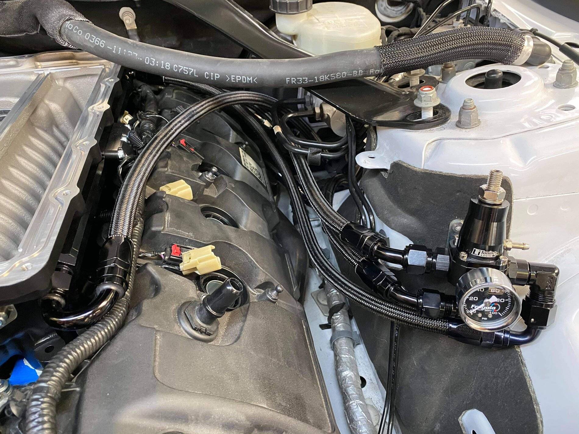

I just installed the sai li kit two days ago. I was nervous about the install for no reason. It’s really simple. Even the wiring portion (which I hate the most) was relatively easy. Cut/splice/run a couple wires and you’re good to go. Don’t hesitate if you’re worried about the install. It’s not bad at all.

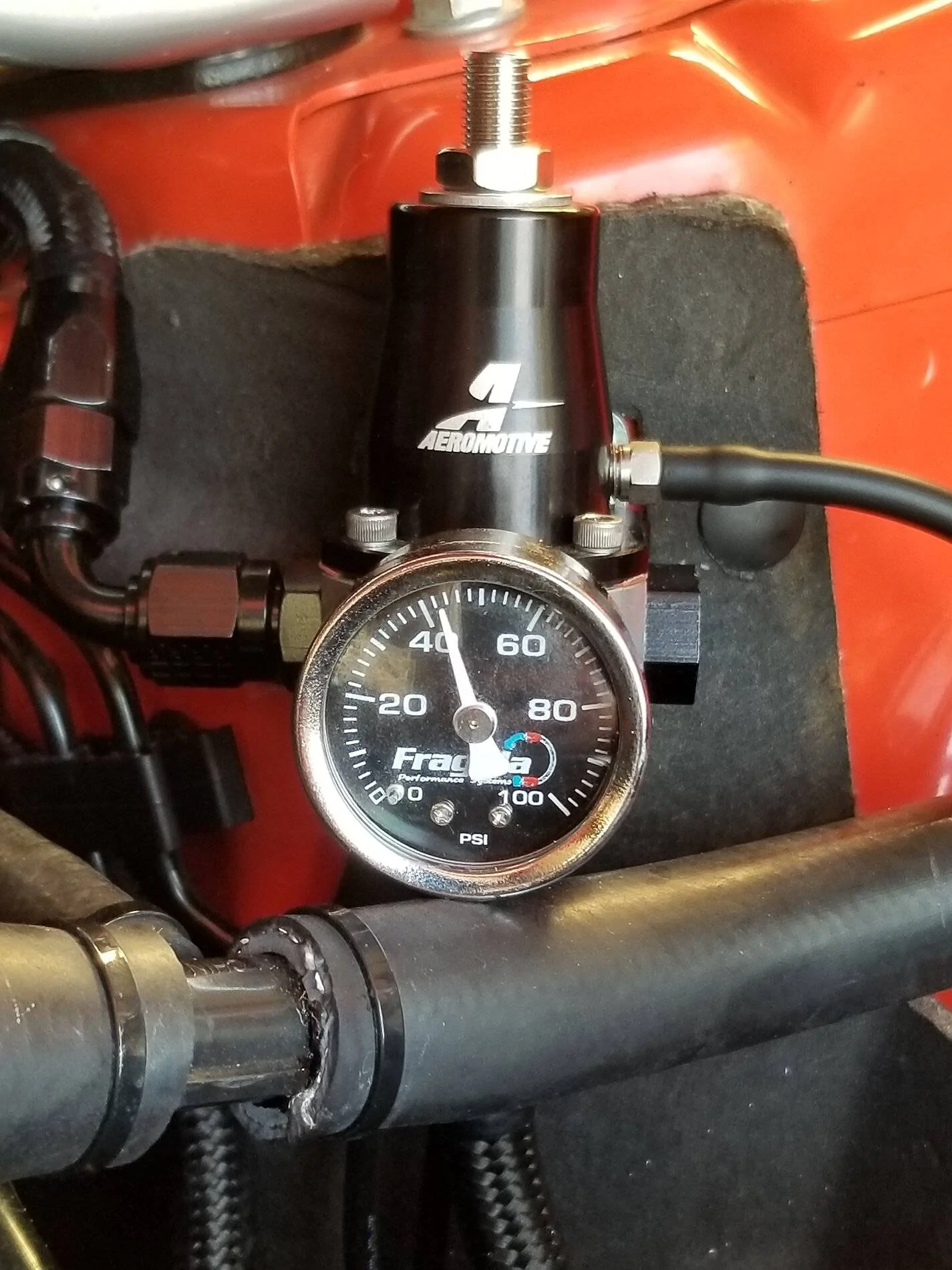

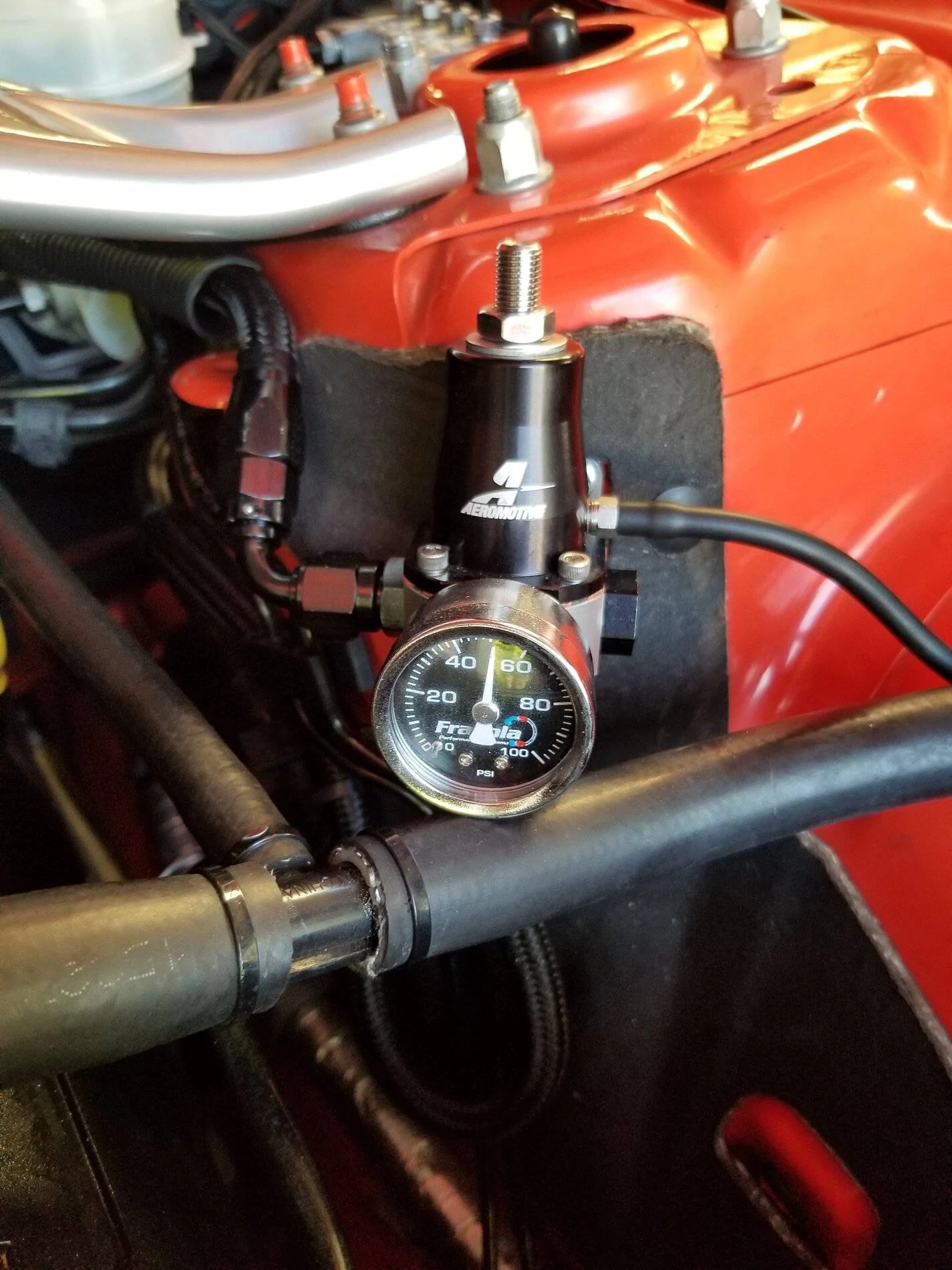

One thing to keep in mind if you do it yourself. The base kit comes with a Holley fuel pressure regulator. Make sure to install the high pressure spring for boosted applications.The regulator will come with the low pressure spring installed from the factory. Don’t ask me how I know this.:blush:

That’s some great info. Little details like that will make it more comfortable installing it. Thanks man.
