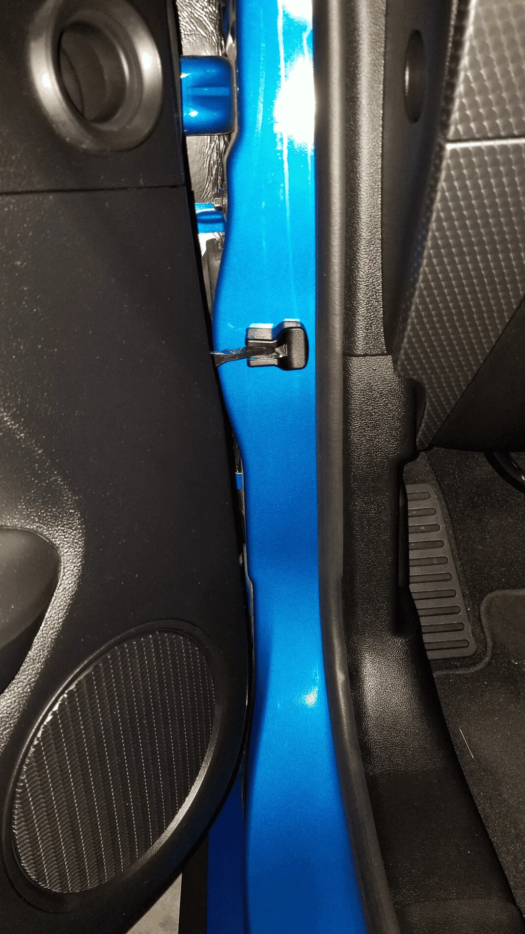

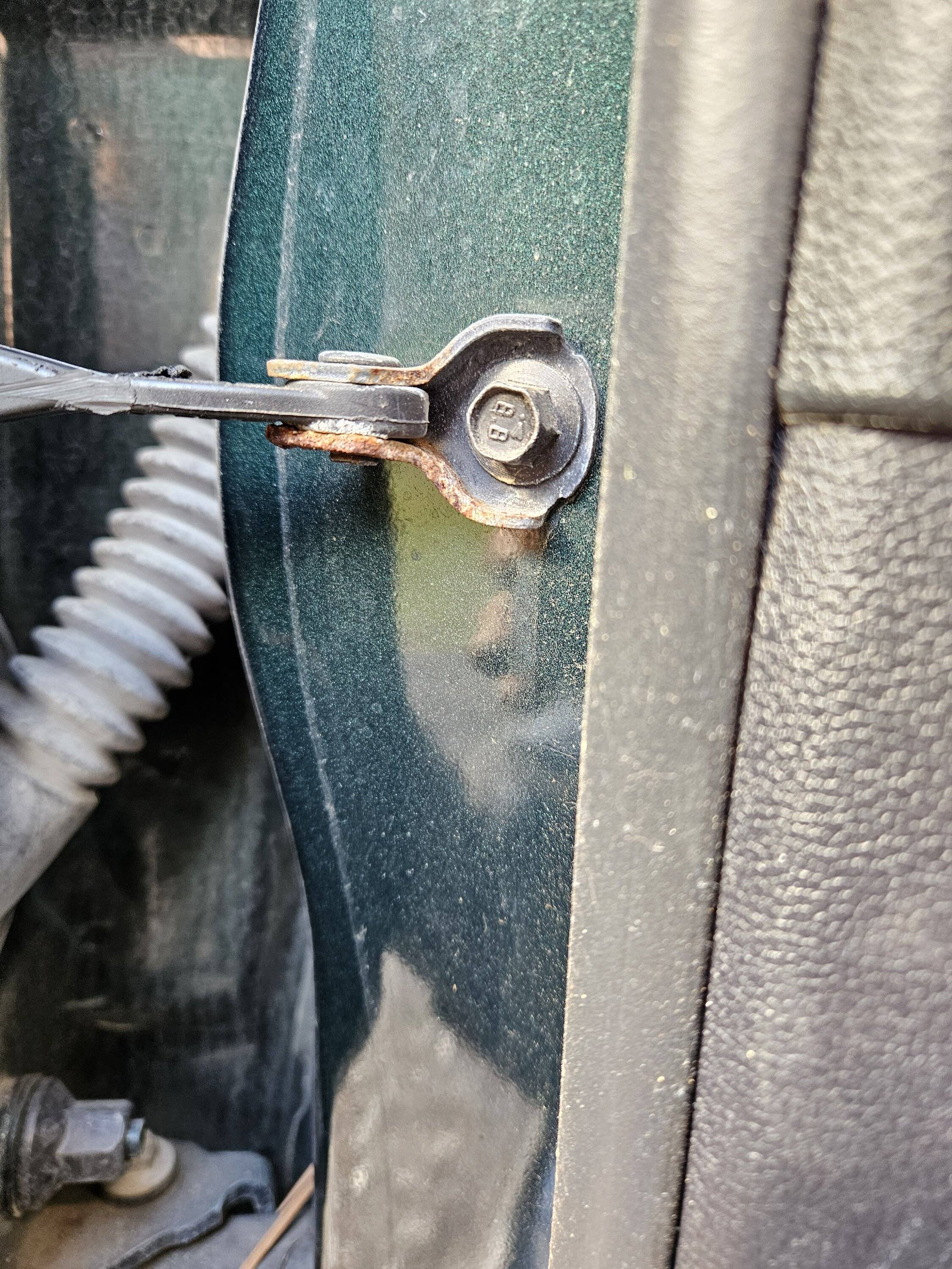

Any thoughts I don't know what to think of this I just realized last night in my driver door hinge just wanted some opinions mine is blank is it something to be questioned....thanks all

Has your car been in the elements a lot? Looks like you should be able to remove the pin in the portion that bolts to the door jamb. Sand as much rust off of the parts as you can, hit them with a rust inhibiting black paint and reinstall. I can’t tell from the bottom, but it may have a circlip holding the pin in place.

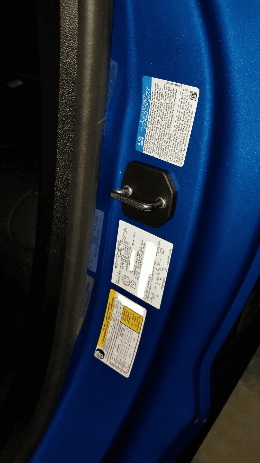

After you clean up the rust you can add these little snap on covers for hinge and the latch: Amazon Link kinda pricy for what they are but they finish the look.

Unfortunately it's common, especially on the UK (damp environment) cars ... :frown:
Clean, grease, and then cover them as per the above post :like:
I did mine from new as I knew what was in store for me if I didn't ...
WD :like:
2015 - 18
Surely they would fit a 2019?

Is the car near saltwaterp?
If it is in a "wet" environment, you can do a light coating of grease over the metal part and do as noted above - get the cover caps (I have them too).

Had the covers on mine from day one, don’t pay Amazon prices!
Just found this amazing item on AliExpress. Check it out! £2.83 29% Off | Door Lock Arm Protection Protector Cover Stopper Buckle Cap Anti-Rust Interior Accessories for Ford Mustang 2015-2020

For my understanding, there was a series of bad plated door check straps.
Replace it (like I did) and you are good to go.
In any case, get these covers, they ad the little extra detail that Ford has kept from us.
Good reply. I got the same when I noticed a little something. Clean it good and cover it
