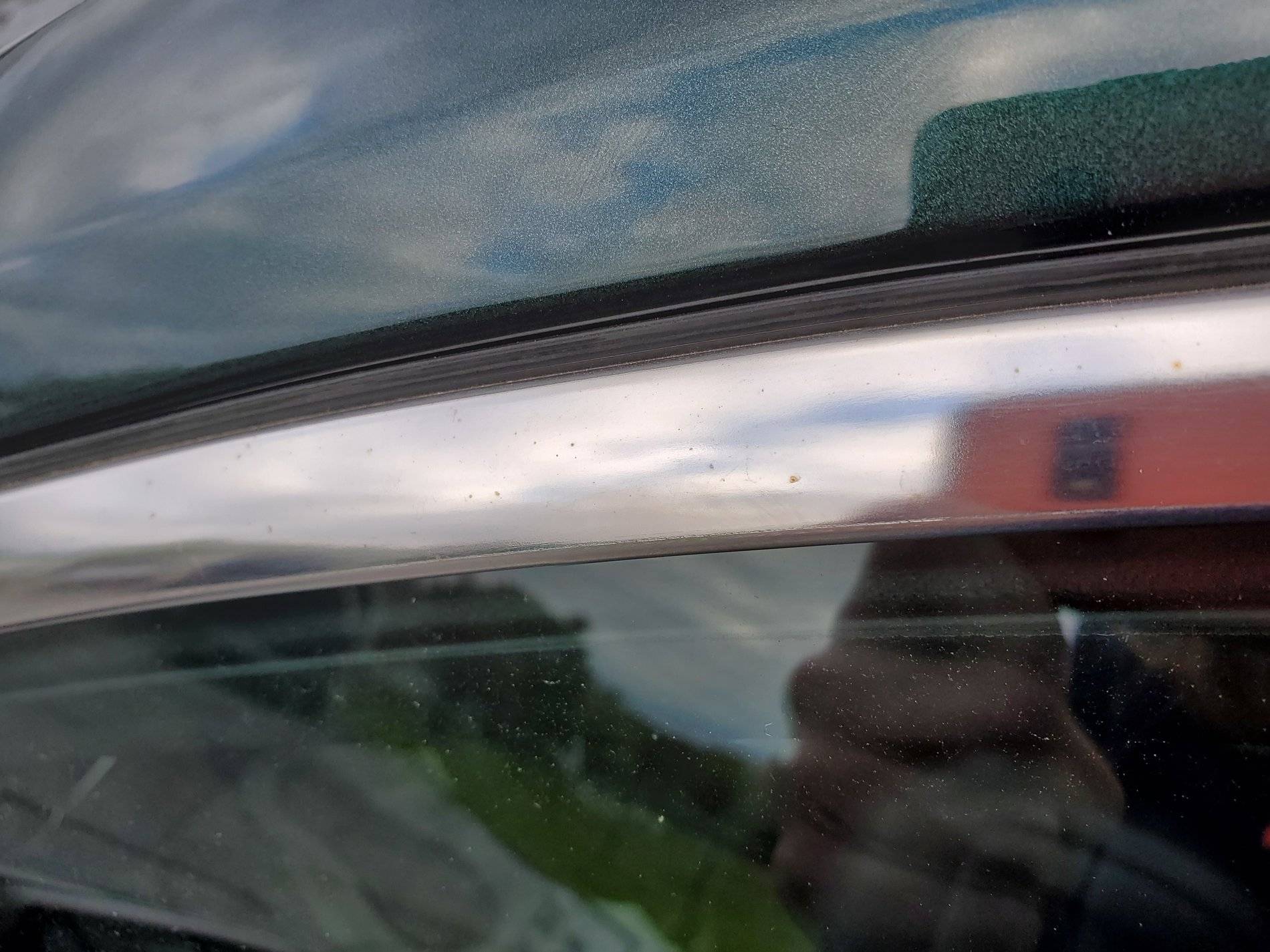

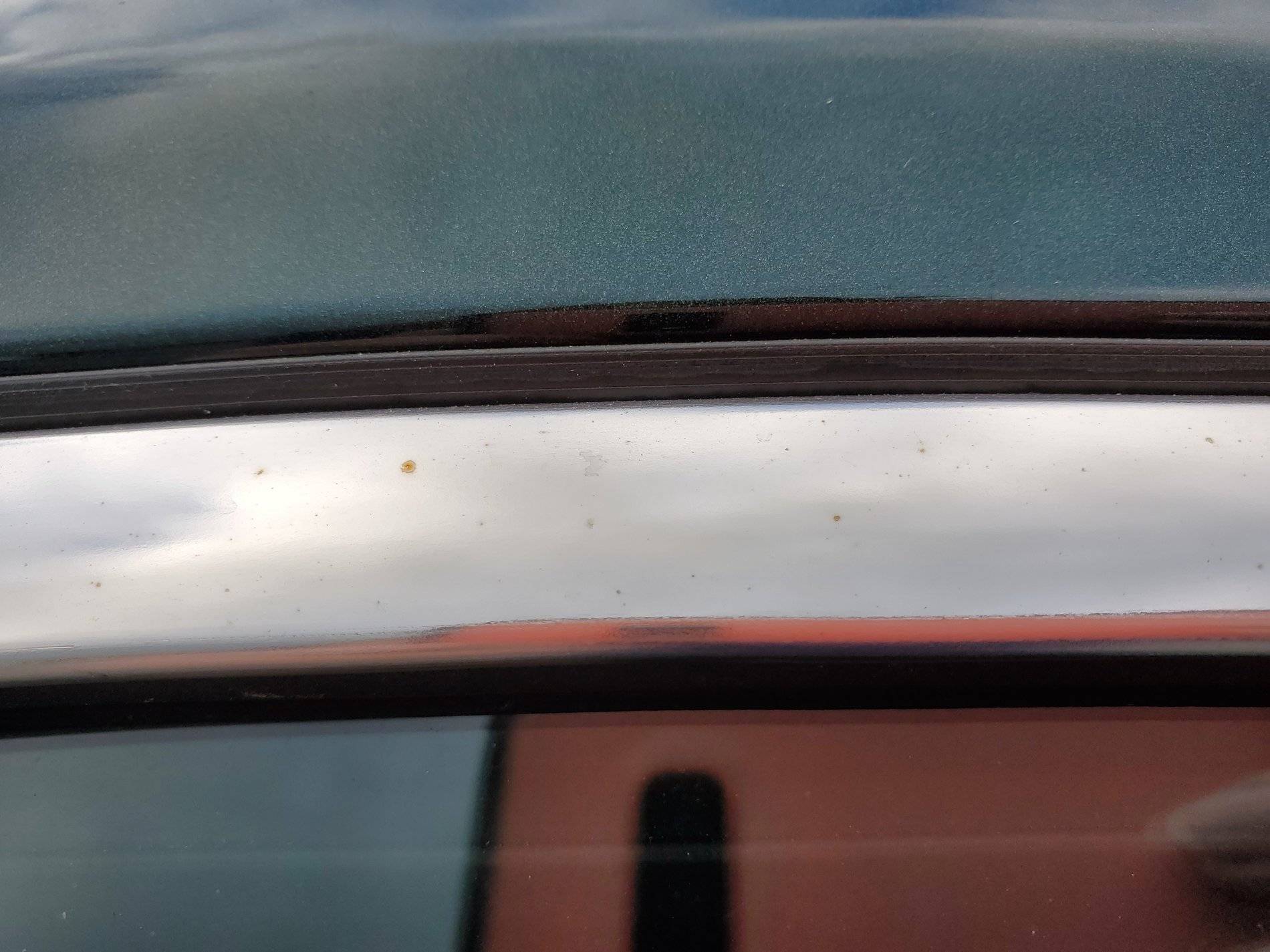

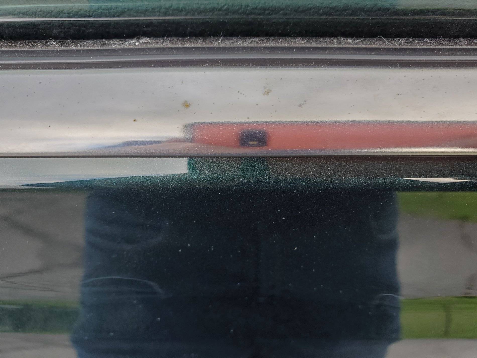

Has any ~2019 Bullitt owners noticed any pitting or rust spots on chrome trim around door/side windows?
The grill appears fine, but plan to Iook it over again as soon as I can, in some sun, when we get some. Rain/Flooding has been bad here for days on end.

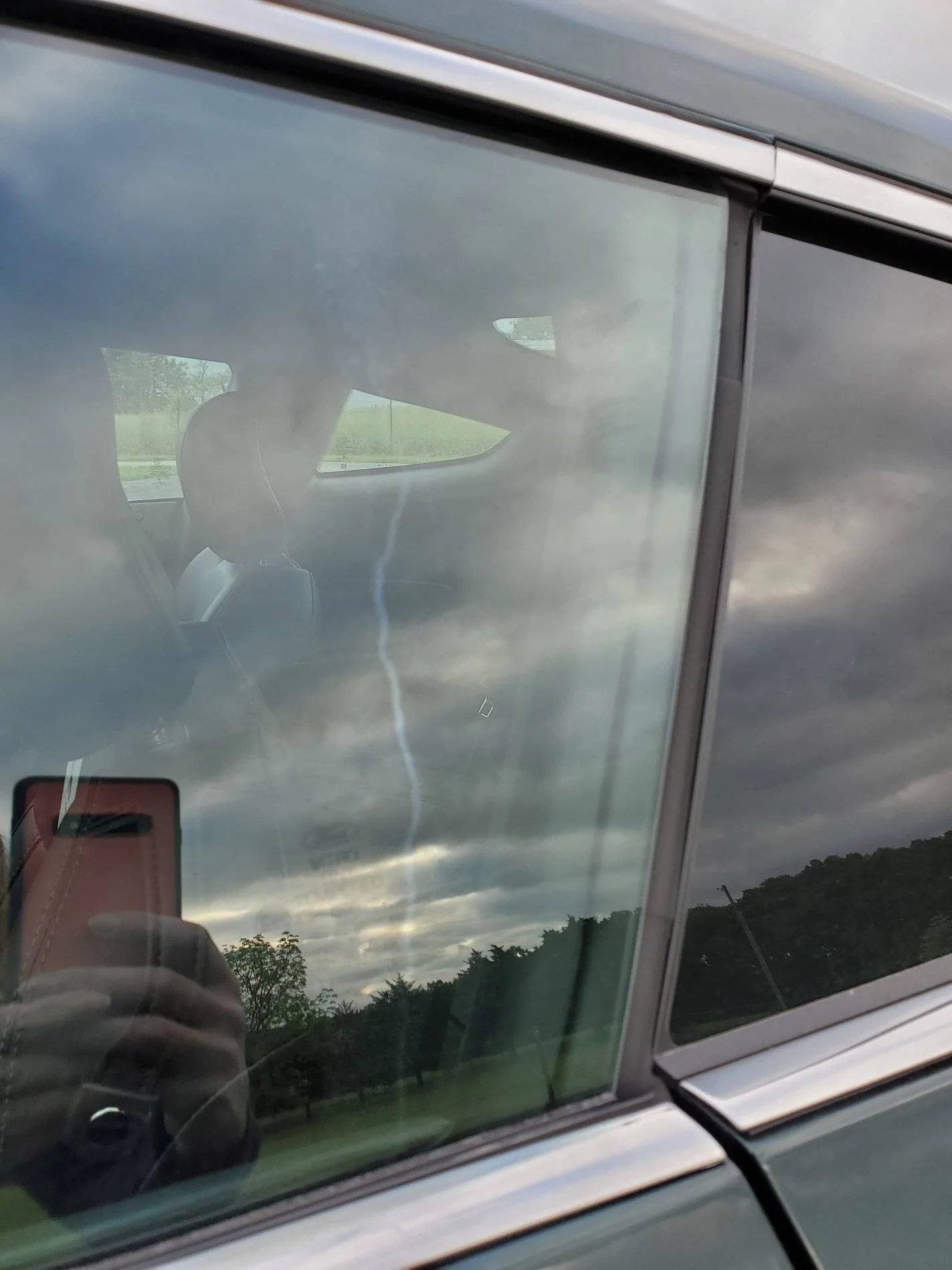

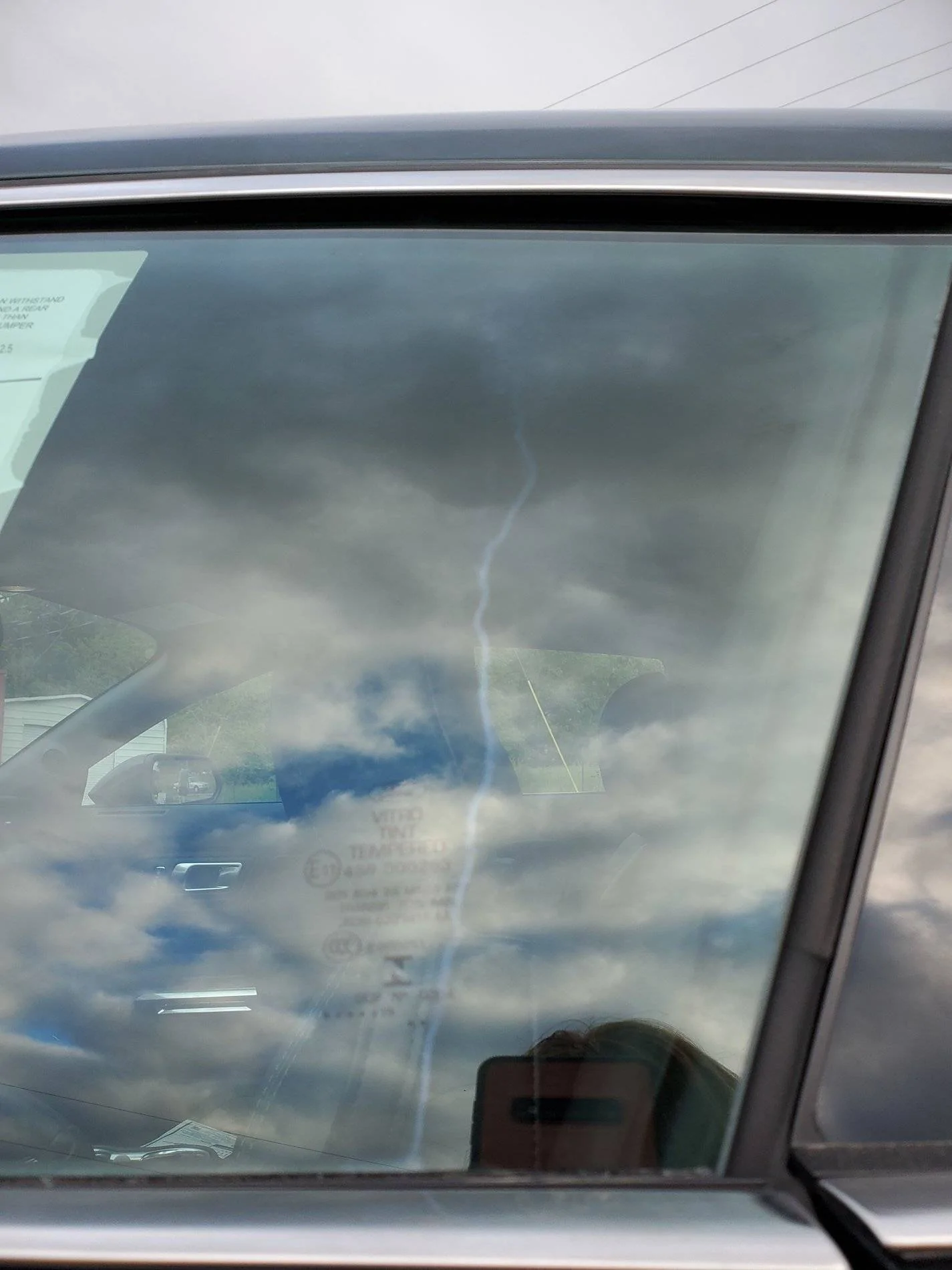

Also, anyone w/s550 have any streaks in glass that are not on outside surface or inside surface, but appear to be within the laminated glass itself?
Its my drivers door window, bk near door handle, and in the right light/ angle,
( lack of light actually may make it show even more) shows up as sorta a blueish/ green colored vertical streak bout ~1/8" wide.
Its just not on inside or outside surface, but I believe within the laminated layers..
Im no glass guy, do Im not able to properly judge it.
This mystery streak is about an 8"/10" long streak line, running vertically above where u grab door handle to open dr.
Does not travel fully, top to bottom, of door glass. Not bubbling, like my 70 stang orig glass edges, but bad enuff its annoying once u know its there.

I wonder if something dripped on the car while it was stored? I bought a 76 Eldorado, was on a lot for several weeks. The owner had written on the windshield, in Glass Wax, the asking price and the year. I cleaned that windshield with everything know to man but I think the sun baked, or burnt, the writing into the glass or the tint, as I could see it from a certain angle.

First off, great screen name! Definitely looks like rust the way it is spreading out from a pin point. Either the chrome wasn't done right or iron contaminated the surface? I've seen stainless steel rust in a similar fashion when particles of iron contaminated the surface. Looks like your window got hit by lightning or it's just plain defective. I would have both fixed under warranty. Other than wear items like tires and brakes, the 3/36 warranty is bumper to bumper.

That looks weird, like something etched the glass. By the way, the door glass is not laminated, like it was on the 2018 F-150 Platinum I traded in (front only). You can easily tell by looking at the top of the window: it looks like a sandwich (with a membrane in the middle). Anyway, try a glass polish; better than let a dealer replace it.

Looks like your car sat on the lot under an old steel lot light. Water dripping down from the light onto your car. Or parked next to a fence that was leaning over the car. I have see both situations in the past. A good retailer may be able to remove the stains I think there are products available for this problem. I bet if you look real real close into the paint you'll see little specs of brown through out.

Nobody seems to have a explanation, other than lighting, @ this time, on glass issue.
That was Hillsndale's suggestion/thought. & a rather plausible one I might think.
Nobody else thus far, - dealer/detailer, ect has an idea at all what it might be.
Rail car brake dust is what my detailer says he has seen cause similar issues in past.
Still, nobody is sure the conditions/timeline circumstances,
can support that possibility, not just yet.

It's definitely iron deposits that are likely everywhere on your car causing the chrome to surface rust. It can easily be polished out with your favorite metal polish. I custom ordered my car and picked it up fresh off the truck. It was covered in iron deposits from the railroad trip. I took it home dirty and cleaned it properly myself. The 16 year old with a soapy broom at the dealership is NOT your friend!
The glass definitely looks like staining from some sort of contaminant dropping on it. You can see the "splash" area and the dripping below it. Use the same metal polish from above (I use Mother's Mag/Aluminum Wheel Polish) and it'll likely remove your glass stain with ease. I've had great luck using metal polishes on glass in the past. It certainly won't hurt anything. Good luck!

Trust me it is not rust ! Stainless does not rust ! Your car has a deposit on is consistent with rail dust like mine had all over the hood roof and trunk when I picked it up . I simply gave the salesman a bad report for handing over a car to a customer in that condition . I took it home and used a good light rubbing compound which removed the spots than a polish and buffer to bring the whole area back to new again . I also voiced my complaint with Ford when they sent out a sails review I hope this gets someone’s attention.

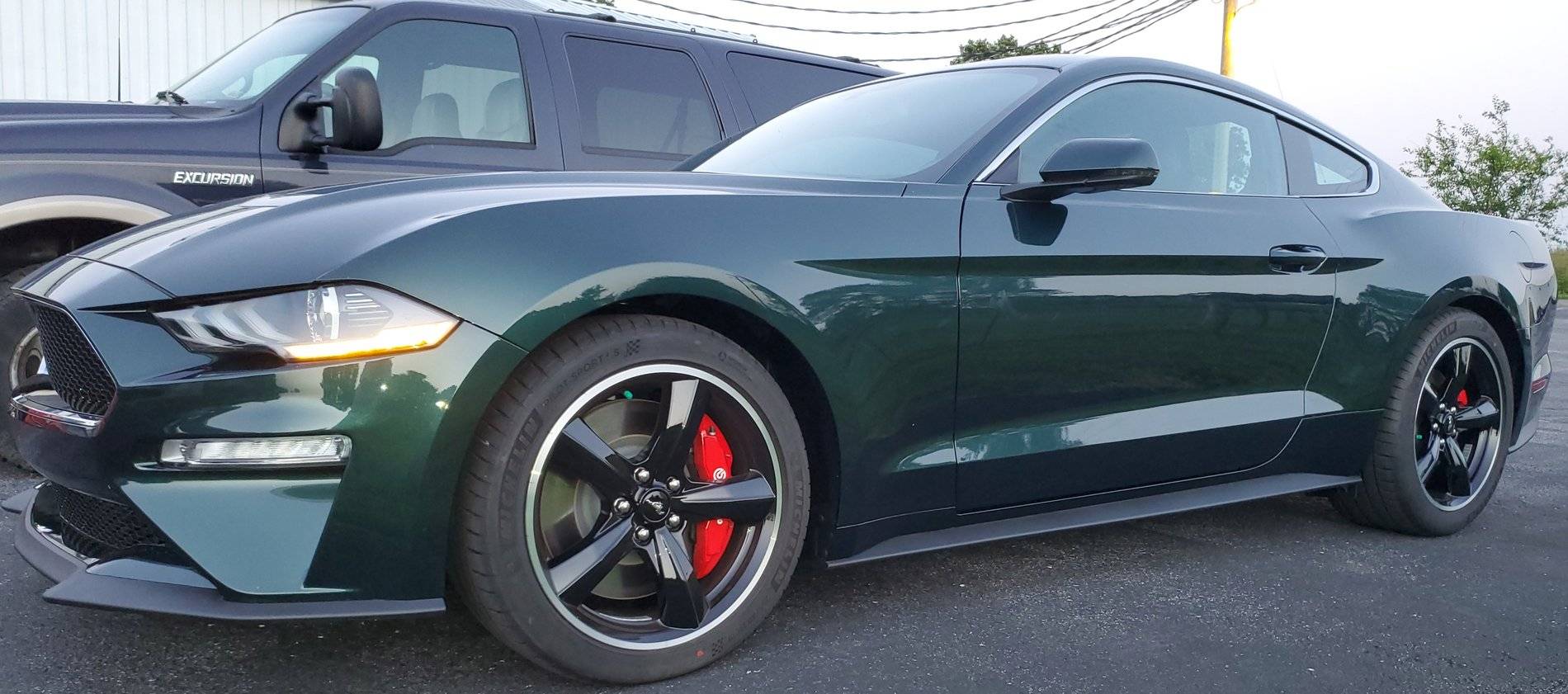

The door alignment on the first picture looks awful

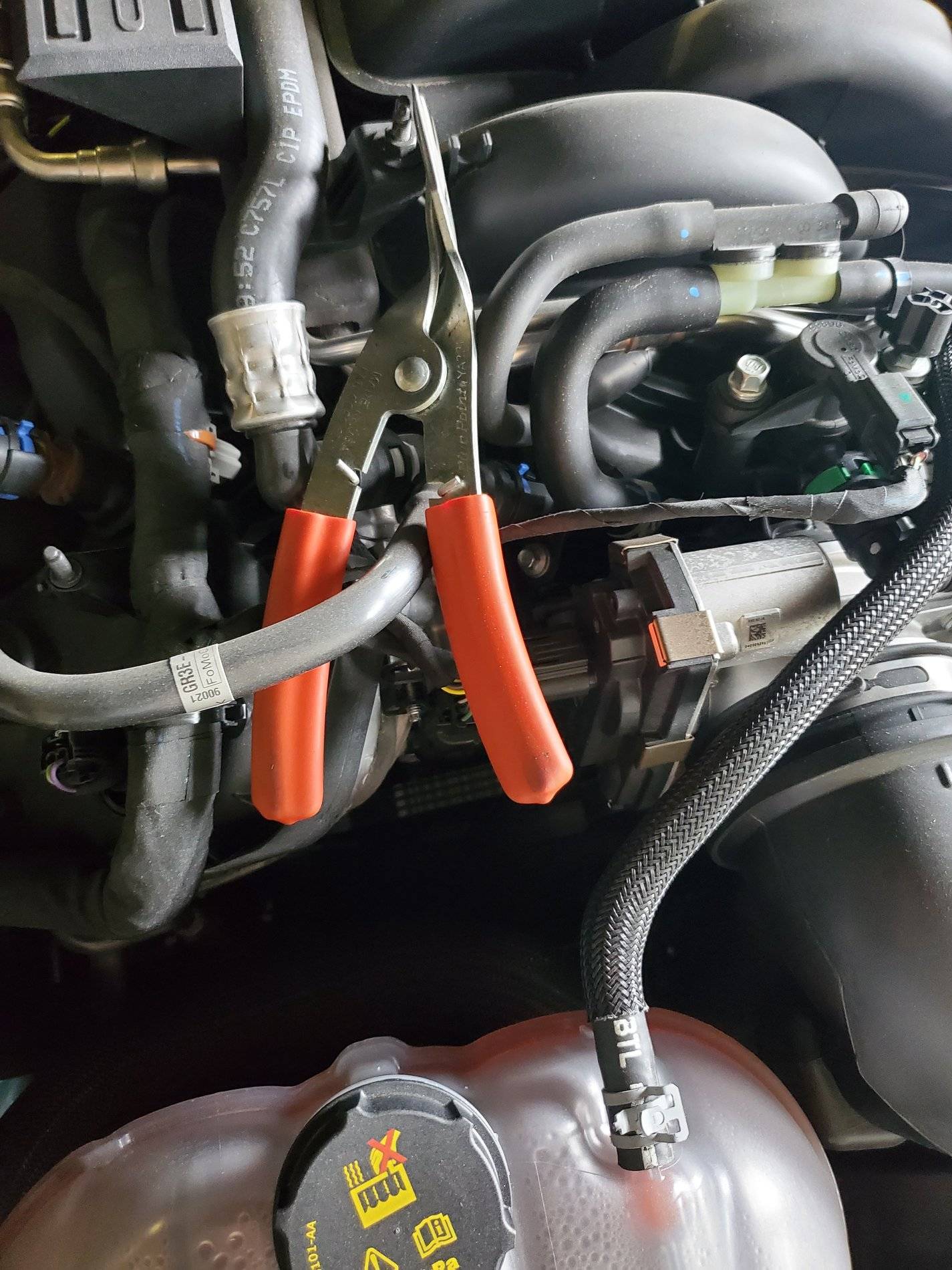

Ohh. BTW..
The pic is of a tool a mechanic left under hood, likely when they chg'd battery for new 1
before release.
I asked for new BATT. to start W/..
& they said it must chk bad 1st. It did.
Cars sitting <new> seem to hav that issue more than 30 yrs ago, < i thk..IMO>
Maybe His/Her specialty pliers are just a
"present" or an "offering" to the Bullitt's GT350 intake, ???
or just the whole car in general. < grin>
Trying to find humor in all this.
Nice surprise (the tool) when we opened hood for 1st time....<laughing>
hey, we are all just humans.
Lord knows I am..
Sorta an alter type sacrifice Id say!...??
Yes, i will return it.. @ 2+hrs away..
Or if they come get car & tk bk,
to make ALL right..
(much more stuff nobody knows about yet)
They can haul the sacrificial tool bk hm w/308.

Damn; glad it didn't fall onto the spinning belt; it wouldn't have been pretty. I'd keep it, for the tech's own good. Ha ha. After he has to spend on a new one, he might be more careful next time :D.
Yeah, nearly every 2019 Stang I've looked at had alignment issues either on trunk, doors, hoods, and the chrome trim that goes around doors on Bullitts.
If u look closely as well, the trim above/below glass, is clearly NOT THE SAME manufacturer's product or the same style of chrome plating/coating as....
Say a Chinese spray on "tan like" chrome job ( j/k ) but clearly it 2 diff chrome process's on my car.
What do u do?
The door body line are right.
I know, part of how I feed myself involves body lines being correct. And it's been said Ford has a tolerance for these poorly matched panels/trim... and if its within there specs..its not fixable under warranty.
Camera angle seems to make it look a bit worse as well. But none the less.
S550s are not the best aligned cars when new.

Our local detailer did an EXCELLENT job on the Bullitt. We are lucky too have a quality team of guys so close to hm.
Detail shop owner resolved all issues seen in pics, on Chrome trim, w/his in-house techniques...,
& on a side note, he suspects the possibility exists that the chromed trim on actual door
<above/below roll up window area>
is more of a type of anodizing, (possibly) than a traditional chroming process. If u lk close, the frnt/rear trim pcs on dr, are not the same appearance of process's, to get the chrome like trim, or perceptive look of it, applied.
Regarding plating strategy of FOMOCO, & its sbilty to resist in depth pitting, his facility was able to remove all the
"Rust appearing" pitting/corrosion areas on the trim on both sides ....
100% gone.. Looks great!!
The door window glass streak, that they were most skeptical of fixing, w/abrasive polish, if I understood him correctly, did infact remove the lightning bolt, upper circular blob, anomaly in the glass. Bird crap? Likely. Rather acidic? Likely.
