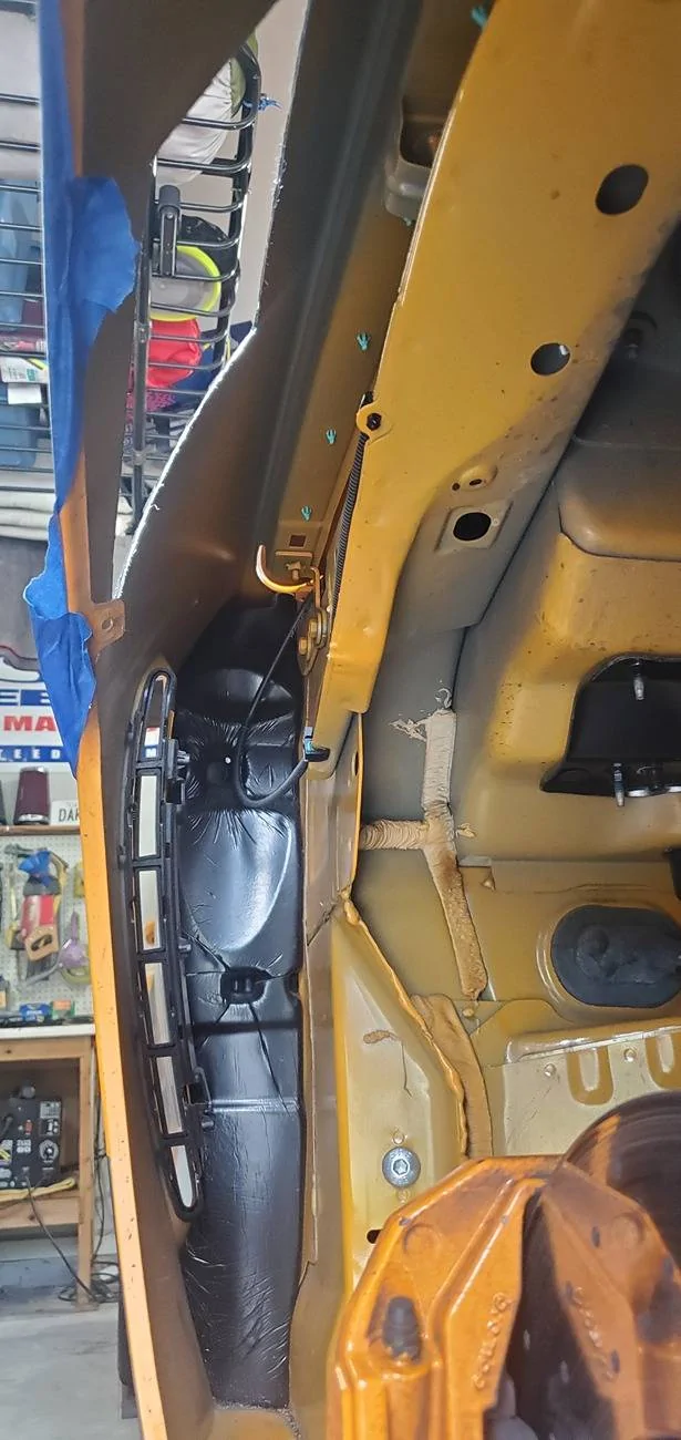

Peter when you open up bonnet/hood curl your fingers over and under the top of the guard/fender you should be able to eel the loom about maybe 2 inches down i couldnt feel it when i put my arm up from bottom behind the liner

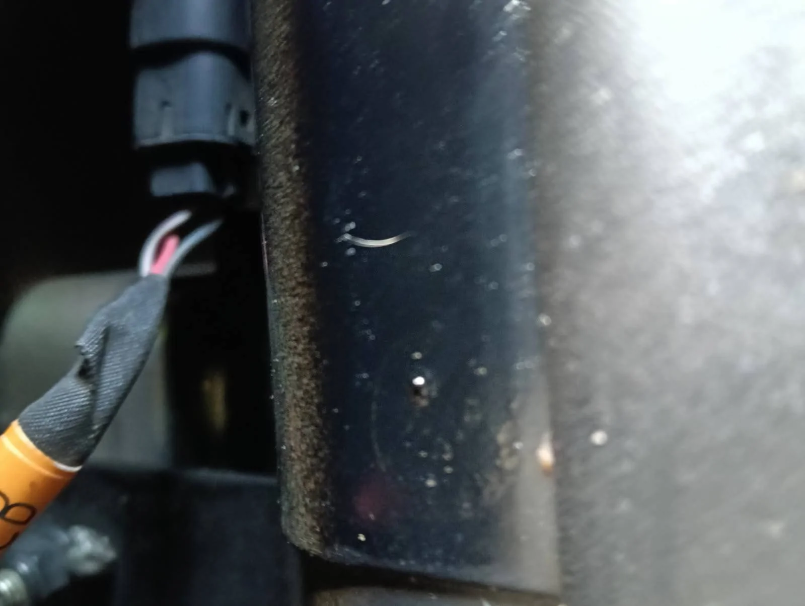

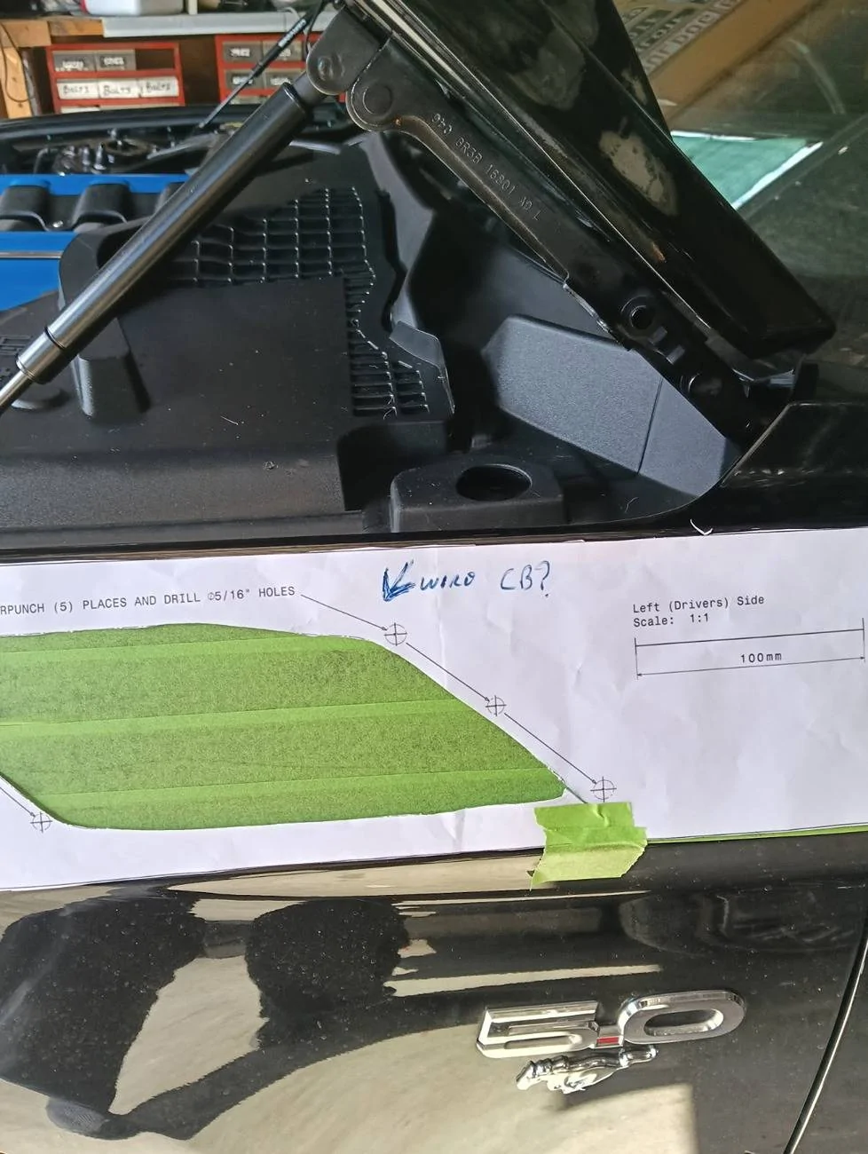

ok heres a couple of pics best i could do of wires
it maybe the heater blower i dont know as yet but it has what looks like old blower motors the wire has CB on it

Dave, I can't quite make out the bottom photo. Is that the liner on the right of the photo. If so that plug is very close. In your case does it clear the cut/drill area or too close for comfort.

hi Peter the pic i took imagine curling your fingers over the guard where in first pic i have "wire" written i dont know what it is the wires are attached to
im going to delve into it later today mine is a 2017 s could be different than yours ??
as i was trying to explain i never work on "late model cars as i dont understand a lot of the electronics
i have to check the clearance i dont know wha the actual part is as yet but its very close to the guard..i pulled the wires away from the guard for pic
my old eyes are straining lol
ps you should be able to feel wires with liner on {clear as mud i know }

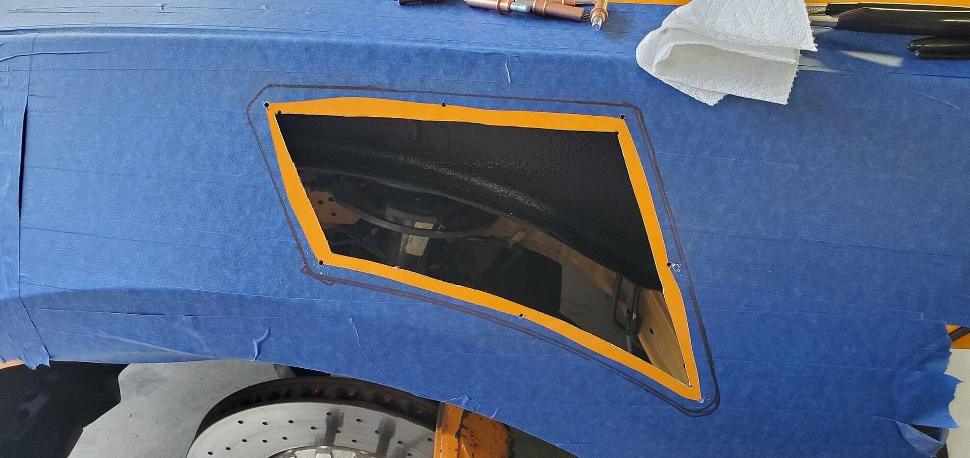

ok Peter here is rough cut i hooked the wire back while cutting it with a wire tie
i cut it using a dremel on 35k rpm
i left about 1/16" to clean up you will see the outline of template is not straight at all
first i drilled the 5 holes using a 1/16 bit later i will use 5/16 as instructed
i would not use a 4" cutoff wheel if you have wires behind like mine
im a bit handicapped at moment had to use one hand my left one which made it a bit harder
i will post link to dremel whls i used

Thanks again Dave. That whatever it is wiring does look close to the cutting. Carefully and not deep cutting will be the go for me. I have the Dremel EZ456 discs which are 1 1/2 inch so probably same as what you used.
