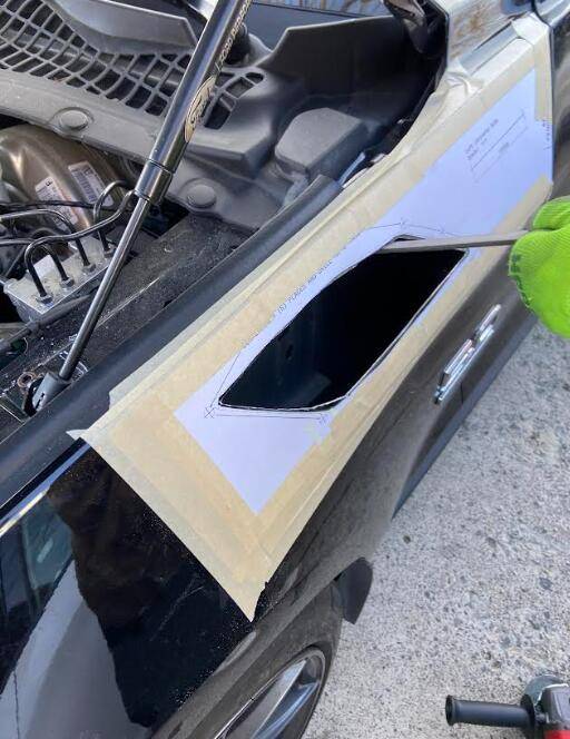

Welp I'm going to install these this Friday. Wish me luck :whew:
I am looking forward to hearing/seeing how this install works for you. Especially what tool you find is best for the cutting of the aluminium fender. Also if you find any problems with dropping the inner liner.

Well my friend only has an angle grinder so that's what we're using lol. I'm thinking for the curves/corners near the drill holes we'll use a drill to drill out and connect a line of small holes.

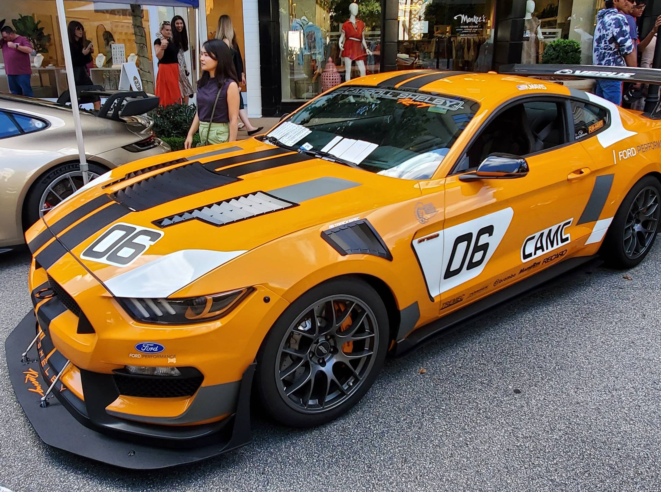

They're placed in a bad spot. Very little air flow inside that area of the fender. You want a GT350 style extractor.
Just as long as the bottom vents are open so airflow can make it through there to upper fender vents are in place where the coolers would be, the air travels through there and upto the fender vents... they act like the F150raptor side fender vents as well. I've had both, Roush had a great design for the stage 3 cars. 👍👌

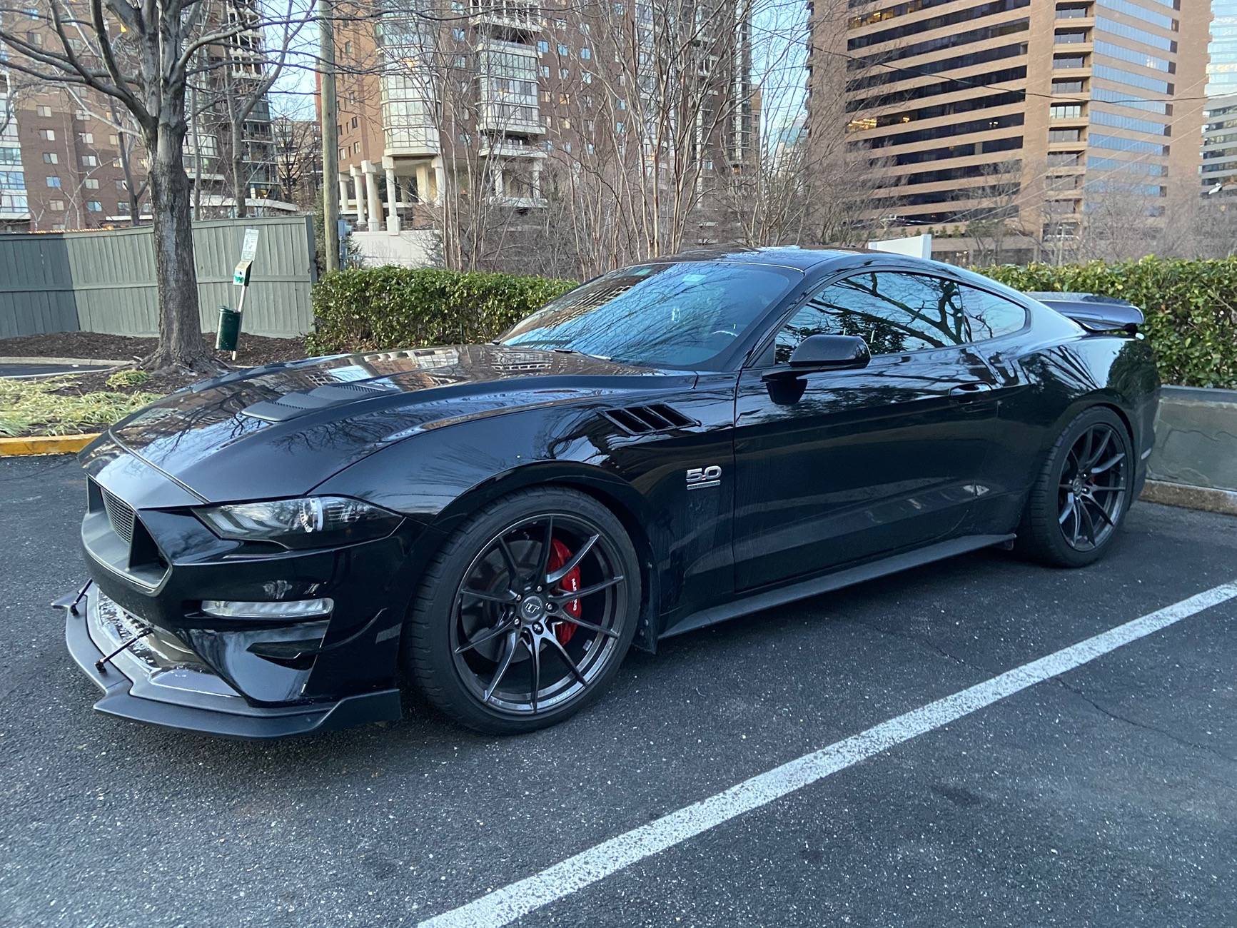

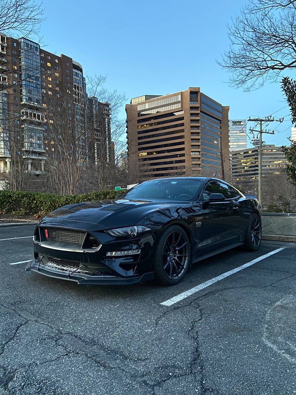

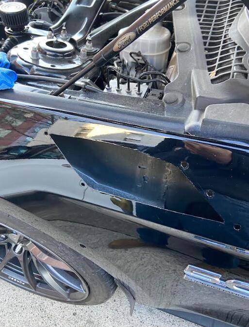

Angle grinder worked for the most part and then to get close to the actual line we used a $2 harbor freight file which went surprisingly well since the aluminum wasn't too hard to cut. Something to note is you don't have to go right up to the line, we were about 2mm away the entire outline. Also the 2 holes closer to the front of the car are pretty close to the big cutout so we went with a smaller drill bit to leave more metal in between.
Used my ford touchup paintpen to paint around all the metal edges
After everything was done we ended up cutting some slots in the fender to let more air flow through, was thinking of adding some mesh grill next time to make it look cooler
Finished project:
I think it adds to all the stuff I've done to my car nicely
Finished project:

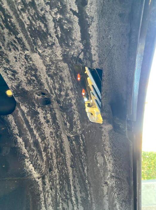

@stannypack, I see you noticed a possible hindrance to good vent airflow. I concur. It appears that in your case you were mimicking the GT350 wheel well venting with your fender liner mod, right? [I could not tell from the photo where you cut the hole in the liner specifically.]

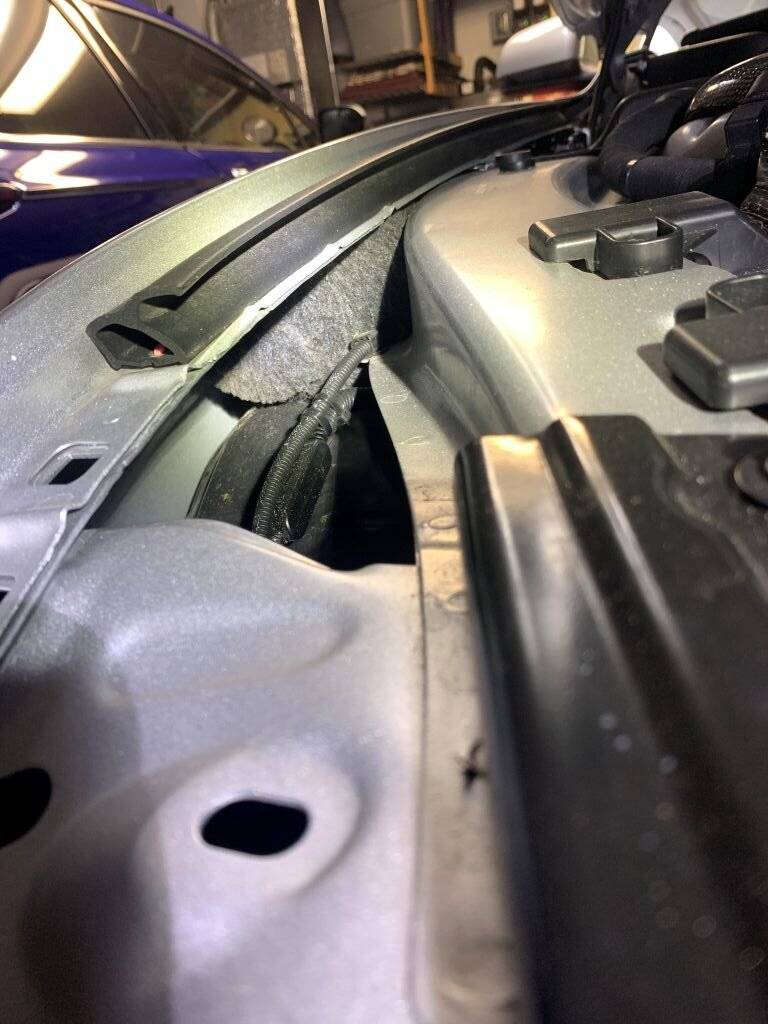

My assumption was that Roush is using the vent to mainly extract heat from the engine compartment. That said, I wonder if on their vehicles, Roush removes the fibrous material between the fender liner and the engine compartment. See pic below for what I'm speaking of.
My plan was to remove that fibrous material to better extract hot engine compartment air through the resulting void. Maybe someone who has a Roush Mustang with vents can tell us if the fibrous material was removed by Roush, thus improving airflow from the engine compartment to the vents.

The slots I cut are just in front of the vents, if you zoom in you can see the fender vents through the slot
