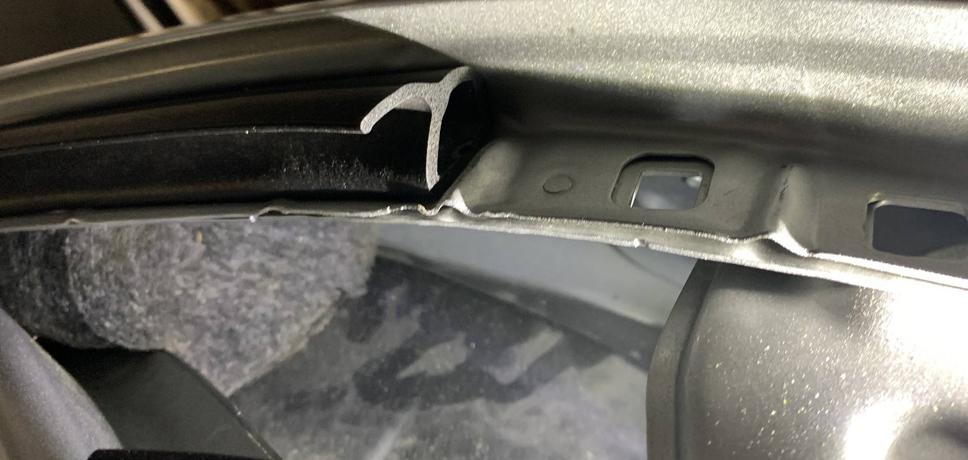

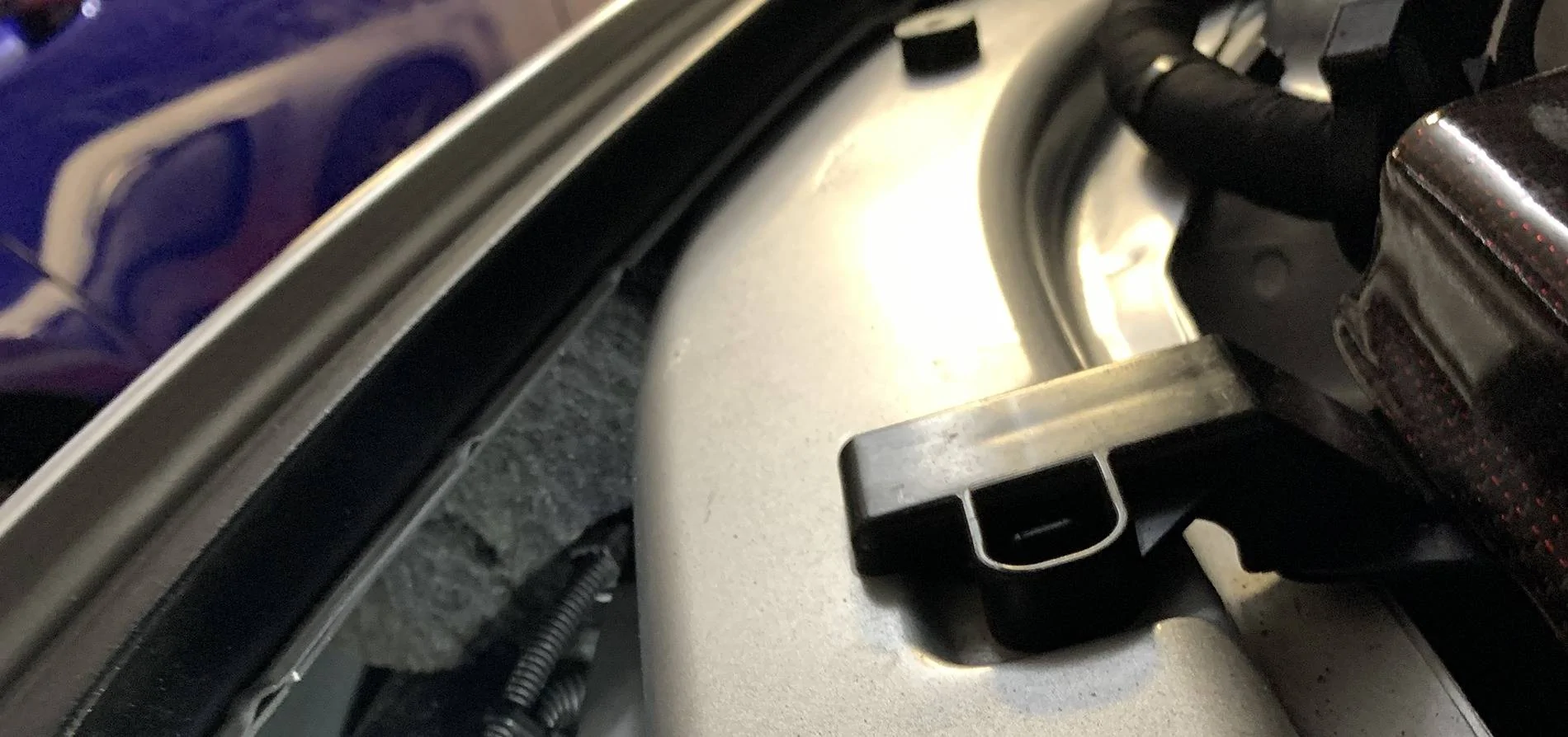

Actually I thought the GT350 fender vent was an engine compartment heat extractor until a forum member enlightened me. The GT350 is for air flow in the front wheel/brake area. You can tell that from a pic of the GT350 inner liner.
I investigated the location of Roush's vent and there would be air flow, albeit it is not as much as I had hoped for to shed more of our Florida heat. The air would mainly flow along the outer side of the structural beam on each side, outboard of the battery box on the R/S and outboard of the brake manifold on the L/S. (There is a foam piece blocking airflow at the top of the fender liner that I believe minimizes air flow on a stock S550.)
For those who have a Roush Mustang, maybe you can check and report if that foam block exists after Roush gets done.
Foam "blocks" on my stock S550:

Cause you will need to remove a huge section of the fender structure to get good airflow w/ the Roush extractors IMO.
I’d be putting holes in the fender liners to pull air from the wheel area, not from the engine bay so I guess we’ll see what we need to cut.
