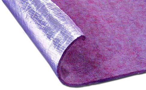

I applied this product under the entire center console (under carpet) and around the shifter. It has eliminated the heat issue for me. Purchased on Amazon.
Thermo-Tec 14130 24" X 48" One Sided Thermo Guard Flame Retardant

Good to know and thanks from sharing!
