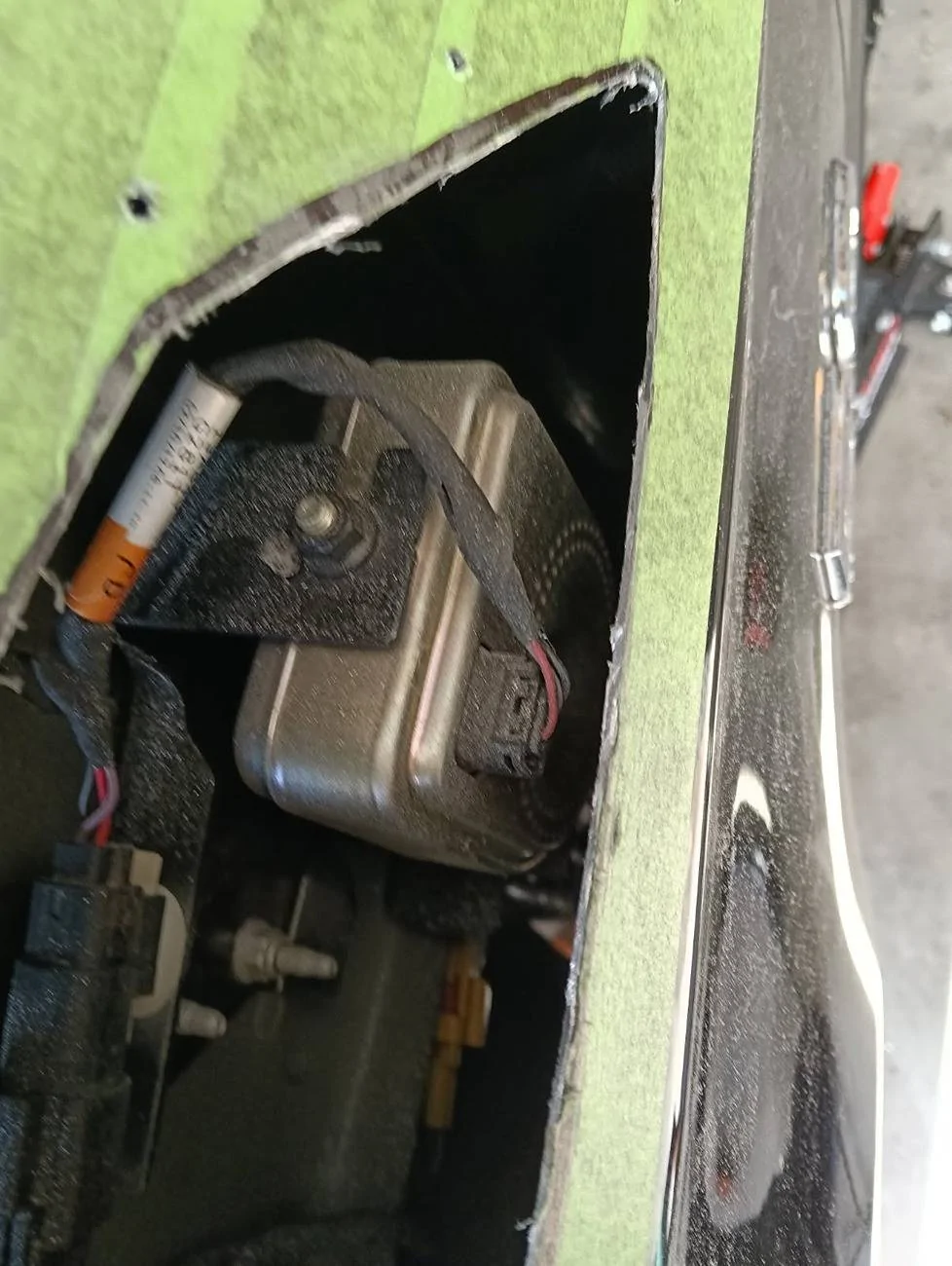

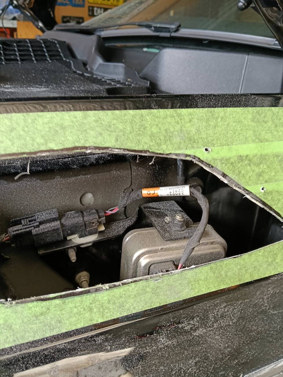

ok Peter here is rough cut i hooked the wire back while cutting it with a wire tie
i cut it using a dremel on 35k rpm
i left about 1/16" to clean up you will see the outline of template is not straight at all
first i drilled the 5 holes using a 1/16 bit later i will use 5/16 as instructed
i would not use a 4" cutoff wheel if you have wires behind like mine
im a bit handicapped at moment had to use one hand my left one which made it a bit harder
i will post link to dremel whls i used
Good catch on the potential cutting issue, Dave. You saved not only yourself, but potentially several others from having a bad day, cutting into those components. Great that you posted pics as well to help. Kudos to you.

thankyou Nathan yes lucky i pulled the loom back it was up against the fender and even tho using dremel it has a shallow cut it would have cut into it for sure
today i will clean up edges redrill holes to 5/16 " and trial fit this one

Wild. I wonder what that component is for? Almost looks to have a speaker integrated i to it or something. Do you have any of the cross-traffic alerting systems on the car or anything that might require a sensor up front like that?

no mate nothing whatsoever like that on car
its a pain where it is i can tell you tho

Could it be the alarm?

good point i wouldnt know what one looked like tho sadly its got CB on the loom its all factory i do know that much
i hasten to add it was a pain to work around believe me im still in middle of it lol

ok mate good luck with it i sure hope the rh side doesnt have anything like the left has
may have changed in 2018 hopefully for you and others
it is a permanent fixture on mine with a bracket on body just for it

Did you have to move the bracket or is there enough clearance.

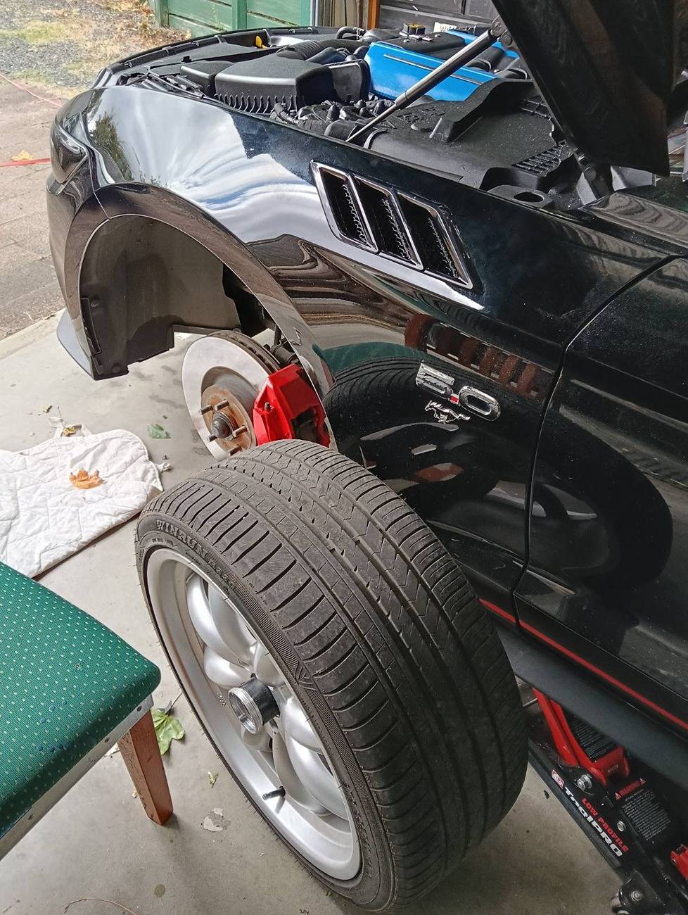

cant move bkt mate is welded to strut tower im finished that side now apart from fitting new push/pins and mounting the wheel
start other side tomorrow

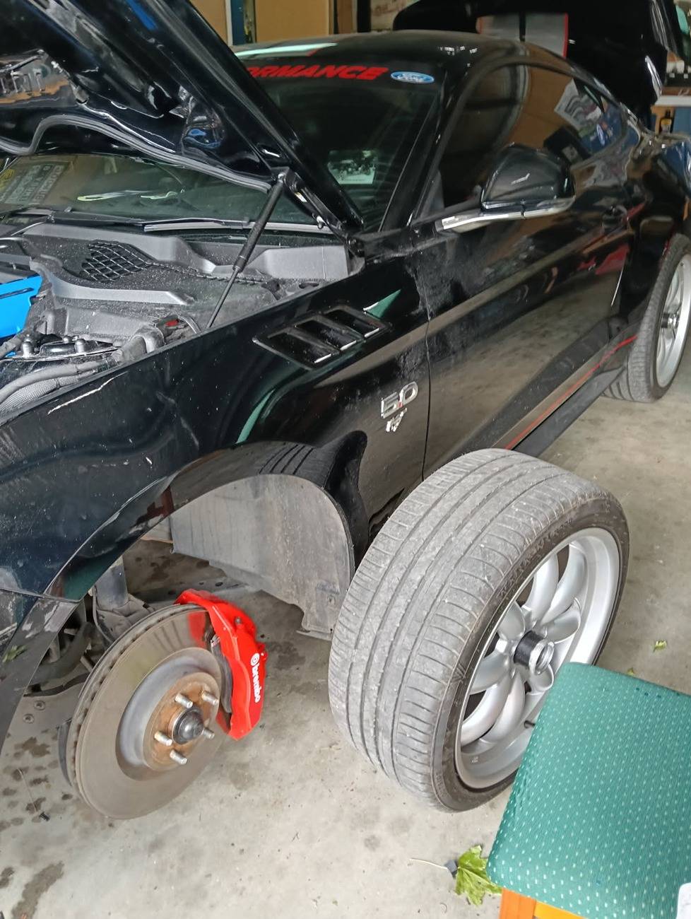

ok rh side is sitting in there but i still have to put backing and nuts behind it
having a prob with my hand at moment i will finish it off in next few days hopefully
