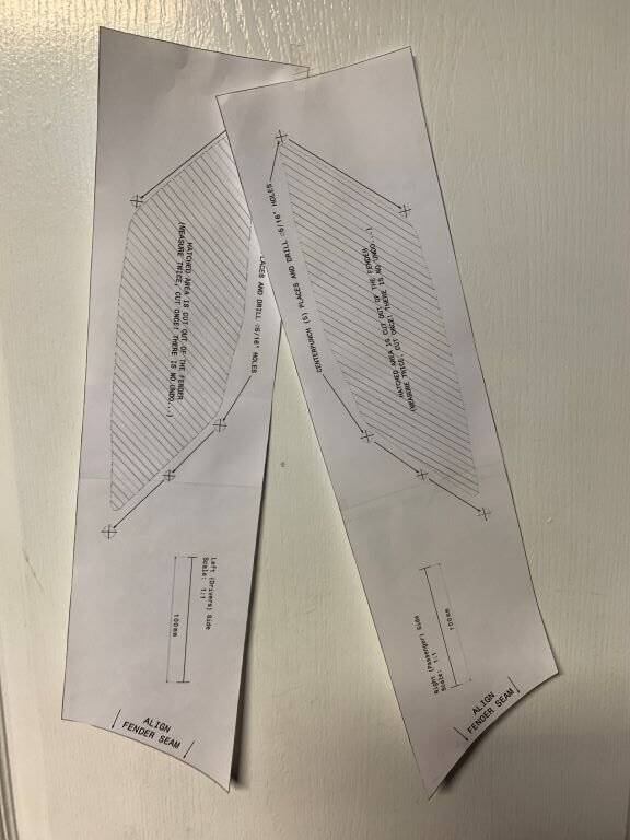

Remember that on the Roush website under directions for these fender vents are temples to overlay so you get the cuts right the first time…you download them and print.
You are correct. They print requires an A2 size paper, which most homeowners, including me, don't have.
So what I did was to use Window's Snipping Tool to get the template off their website. I snipped the left 1/2 of the Driver template pasting the image into Photoshop Elements. I repeated for the right 1/2 of the driver side. Then I repeated for the passenger side template. I cropped off each image's excess white area so the halves would each print on legal paper at a 1:1 scale.
After printing I taped the segments together for each side respectively. And walaw, I have full size templates for each side.
Caution: When printing, CONFIRM the printed output is correct using the 100mm 1:1 scale that Roush provided. Expand or shrink output when printing if/as necessary. Even better, match the template against the part to ensure all features align with the template.
If anyone has a way to process PSD files and legal paper, I''ll be glad to share the files.

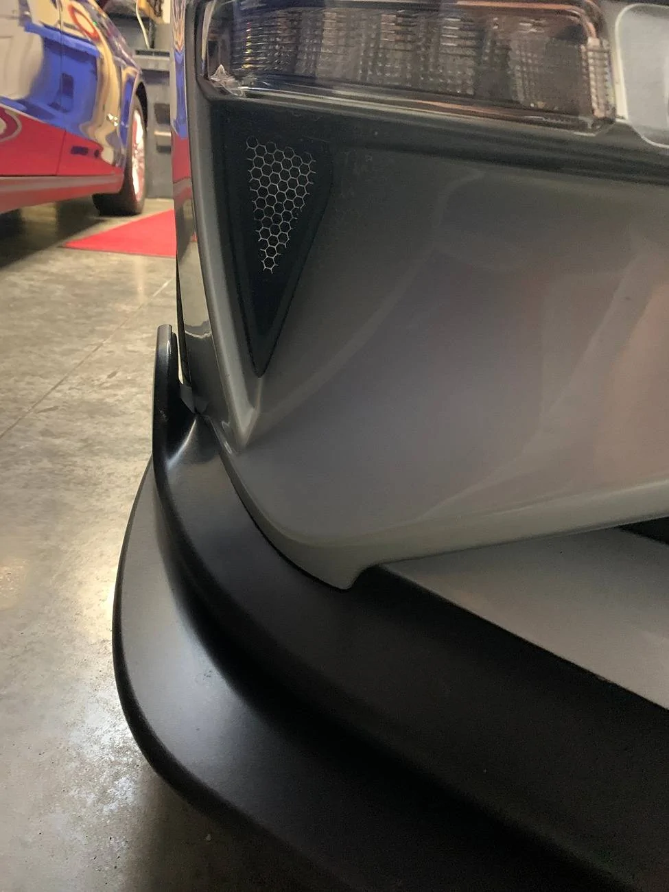

Speaking of fender vents….has anyone noticed the small vertical air vent on the front of the fender well? It’s connected to the front lower side fake vents! I’am thinking you could drill smaller holes in that fake grid to funnel air to wheels/brakes
Is this what you are speaking of?
I learned that some Mustangs (with wider tires, PP packages) have the holes blocked off. On mine, I have the P/N part that has a few holes open into the wheel well. The different part numbers probably have to do with fuel efficiency/air flow requirements relative to aero packages.
Yes…..now in the front of the wheelwell is a narrow slot for air to escape for cooling brakes?
It would be a stretch to be for cooling brakes, but there indeed could be incidental impact. Most likely the open/closed decision is based aero CoF to improve fuel mileage. It is amazing how such small features can make a big difference. I was part of a vehicle development team (not Ford) where it was determined after simulation to omit a hood feature because of the large negative MPG impact that small feature presented.
