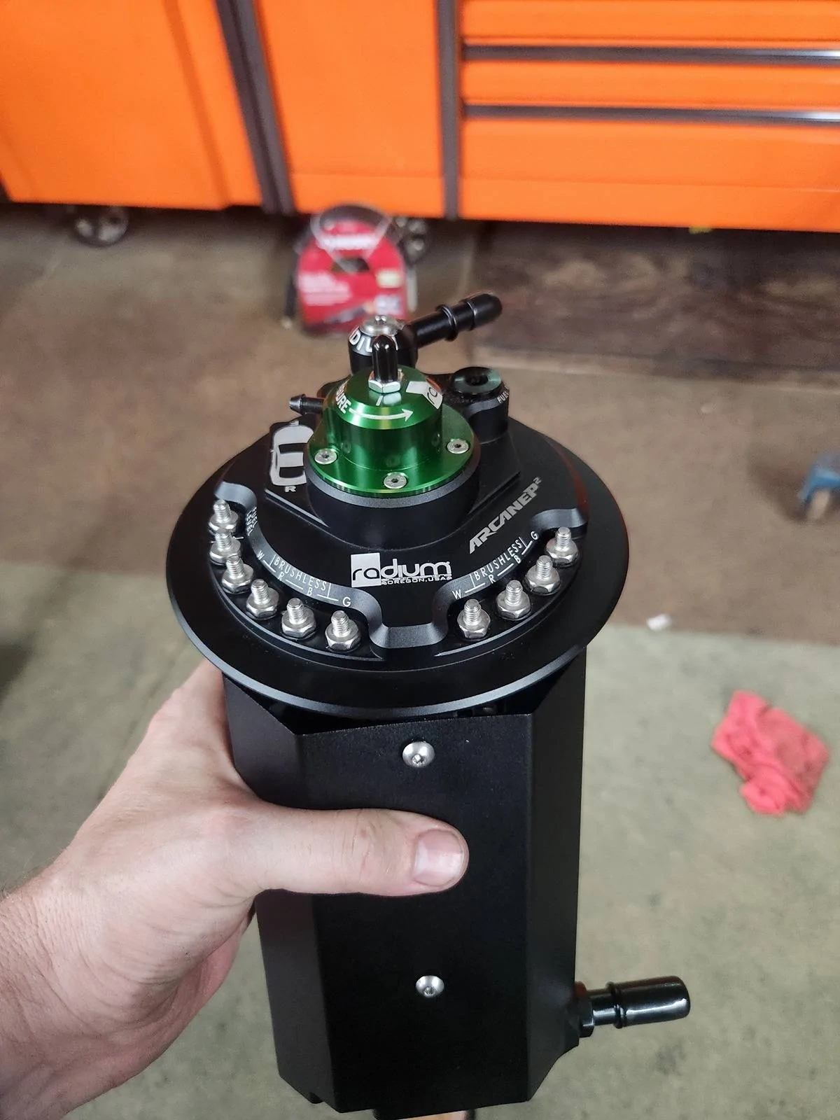

That does make sense. I suppose wiring into the factory connector is for priming with key on and the fuel level. I ordered my kit last November and my bucket is steel.
For my use case, I have zero concerns running the pumps full time. I'm confident this setup will support plenty of power. :)

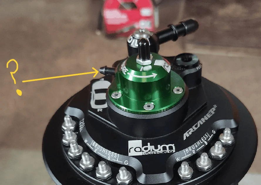

What is this used for?
Midwestracer
Midwestracer
Feb 28, 2024
82
46
Fayetville Arkansas
chris
2018 mustang gt whipple
boost reference

It would be a curious experiment/study to see if the return style with the regulator at the hat has less, more or the same lag time as a return less setup. In either case, in order for the system to supply more fuel to the rails, there's a distance between the pumps and the rail that must be tuned in, either preloading the pumps (to run harder in anticipation) or smoothing out the fuel delivery through adjustments to the injection pulse based on pressure/duration.
There are a couple of advantages to return side dumping back into the bucket. First, no return line is needed. Second, it heats the fuel less (than sending it to the front to a hot engine bay and back).
But there are also a couple of drawbacks. To get an accurate boost reference that far away, you're going to have to run a large(r) vacuum line all the way back there without kinking or bending it. And as I wrote earlier, you'll still have to run the pumps slightly over-tasked to account for the sudden spikes in demand at the rails and it's ability to ramp up output and send more fuel to get to the rails.
