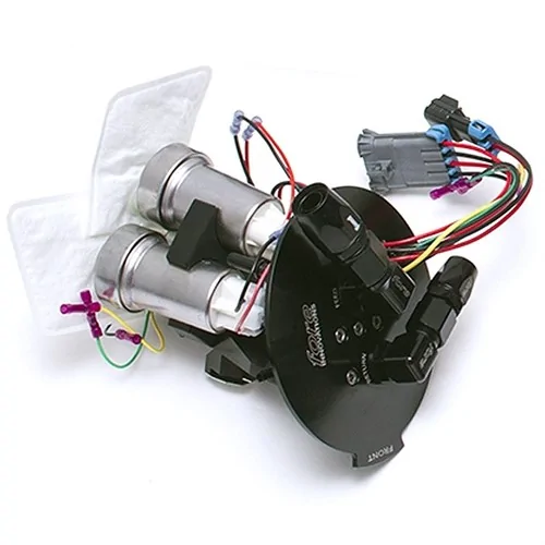

I'm going to be using a Fore dual pump hat with a -8 feed. Are there any negatives from using a -6 return line instead of a -8?
I would spend a little more and use a -8 return. Depending on your hp goals, you might also consider using -10 feed. That’s what I used on my Fore setup
turbojay
Aug 15, 2017
78
Illinois
20 GT A10
Thanks for the fast response. My hp goal is 700-800. I already have enough-6 ptfe hose and fittings leftover from another project. I was thinking it would be fine for the return, but if using the -6 will have a negative impact on my fuel system, I'll just but more -8.

the 6 return should be enough for you if you already have everything at that power level
I ordered the fuel hat and my wheels from you the other day. I should have them tomorrow. Much faster shipping than I was expecting. Thank you.
I'm probably overthinking this return line (I do this to almost everything I do), but when does the return line size become an issue? My thought was it would become less of an issue the higher you go in hp because you are returning less fuel to the tank.

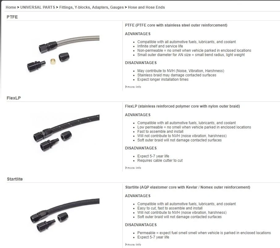

I’m running a Fore Stage 2 triple hat with two pumps and fc3 controller so all I need to do is add one more pump on a Hobbs down the road if I need it. I called Terry direct and got the lowest possible pricing around with fast shipping for free. There’s no instructions, but installation is really straight forward. My buddy brought some black factory loom we ran over all the braided ptfe lines which made them blend right in.
Only “con” about the Fore system is cost, but in all honesty, you really do get what you pay for and fuel delivery isn’t an area you want to try and save money.
Do you have any cabin noise on the drivers side due to the braided ptfe lines?
This post is 7 years old so you may get limited replies.
However, to mitigate any line noise near the brake booster, I placed an outer rubber layer around my fuel line. Essentially, I cut a similar sized rubber hose length wise, and placed it over the PTFE. You can do this in any location where the PTFE may be inducing noise.

7 year bump, nice! I do get some minor pulsing noise at idle with my setup. I am going to do what @LOL WUT mentions above and insulate the PTFE better.
