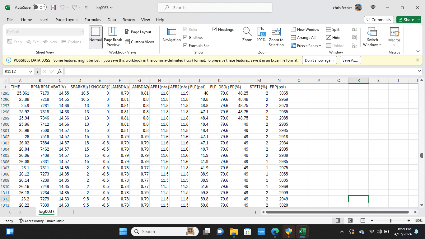

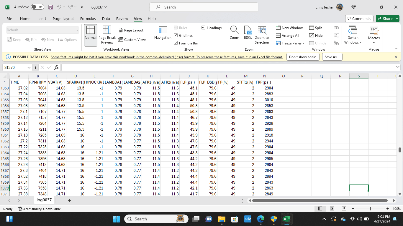

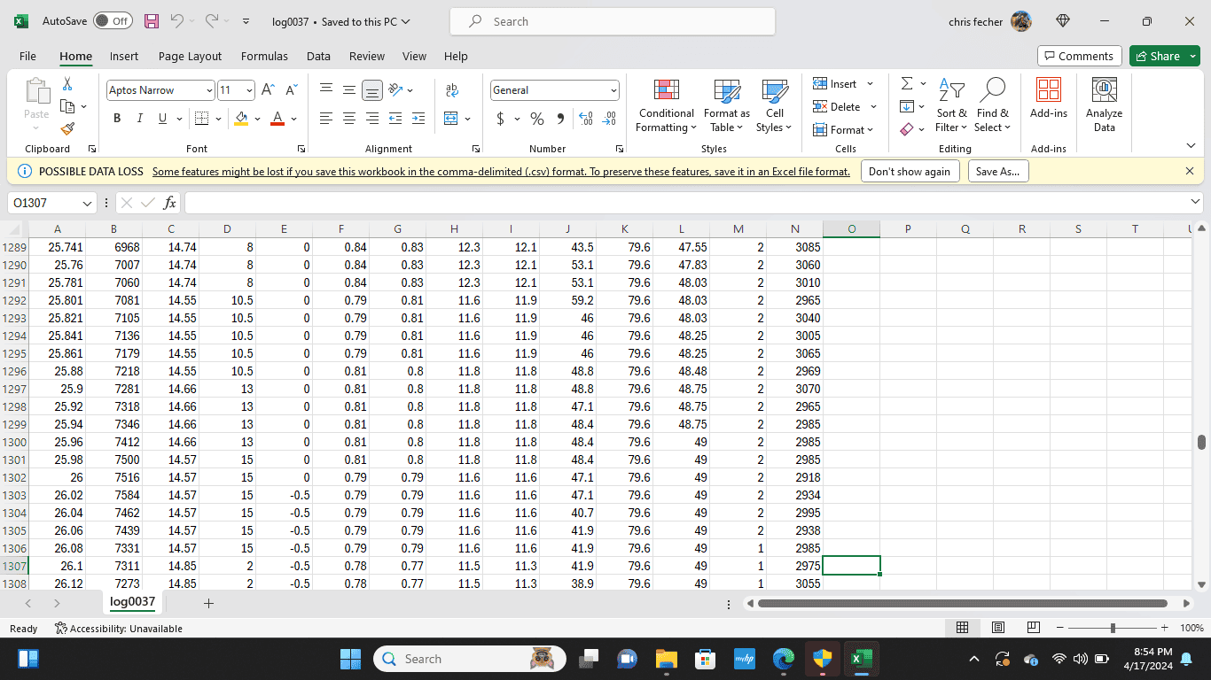

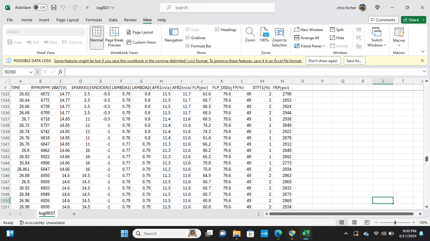

The easiest way to post logs on this site is to put them in a zip file.
