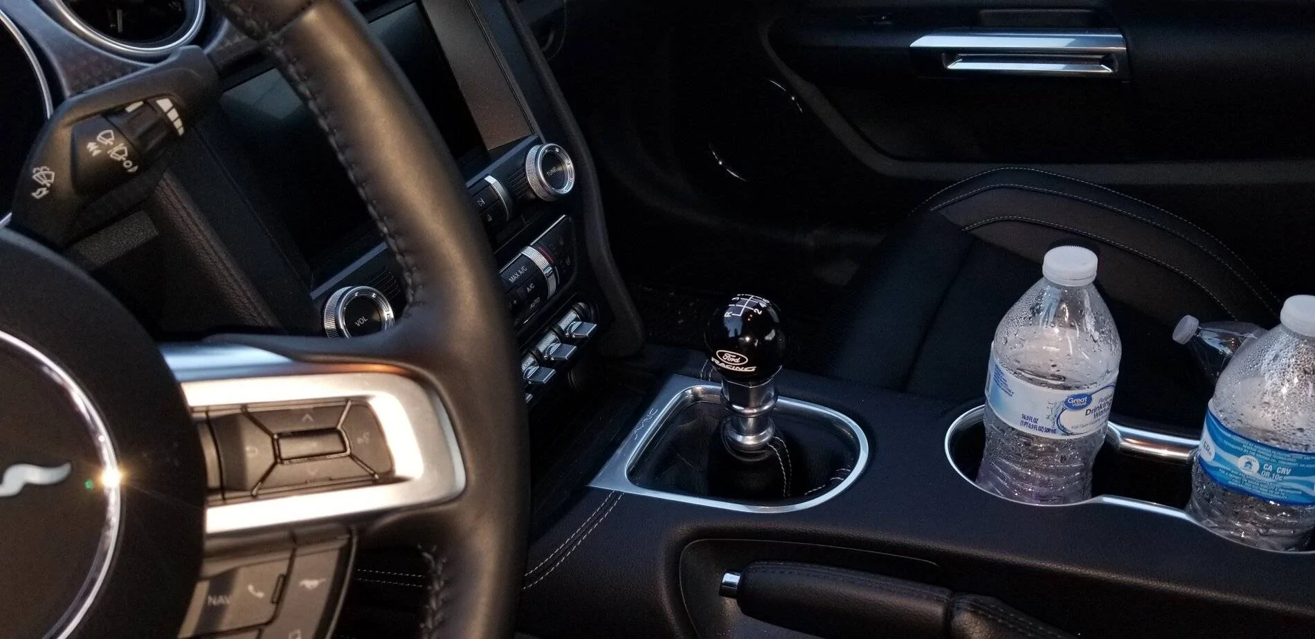

Hi folks
I'm picking up a 2019 GT PP2 and really want to replace the stock shift knob with the black "Ford Performance" one.
Are they all the same?
How hard to install?
What vendor here sells it?
Nice wheels. I did the Ford knob as well but I wanted the old School ā€œracing ā€œ one my 19 PP2 and it was super easy. I purchasEd from Summit Racing when they had a spend $200 and get $25 back sale.
I used a CJ pony part video to guide me took about 15 minutes with blue loctite. I let it cure overnight and what an improvement over stock for look and feel. No issues 1 year later.

I put the FP knob on with nothing more than blue loctite (243).
I put it in reverse so the collar was up, screwed it down, then backed it off until the engraving was approx level, put it in third, levelled it fully and then let it sit overnight.
My OE knob was secured with nothing more than loctite and it was ā€˜shit I’m going to break it’ tight.
