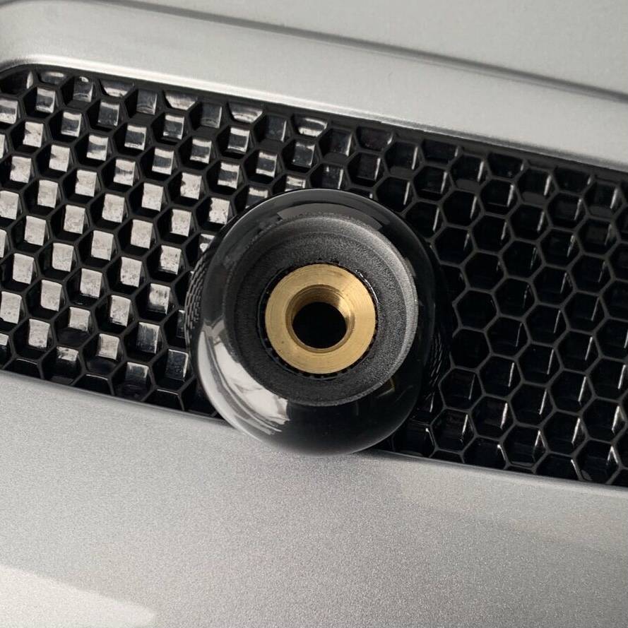

Ref my comment further up this thread, here’s the underside of the FP knob with the brass insert :
That might help you make a weight guess compared to the all resin Bullitt knob :like:
Photo shamelessly pinched from @Iconicgt ā€˜s for sale advert :like:
WD :like:
