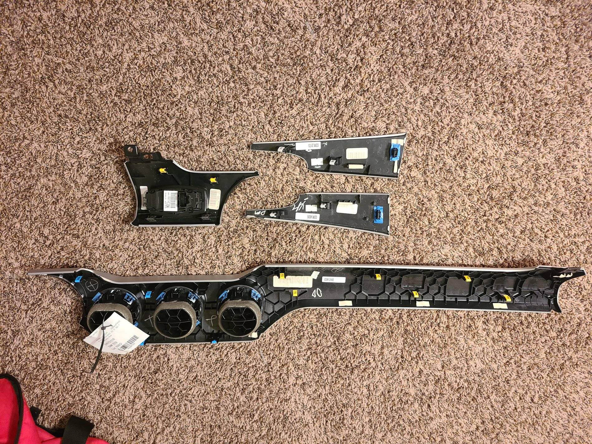

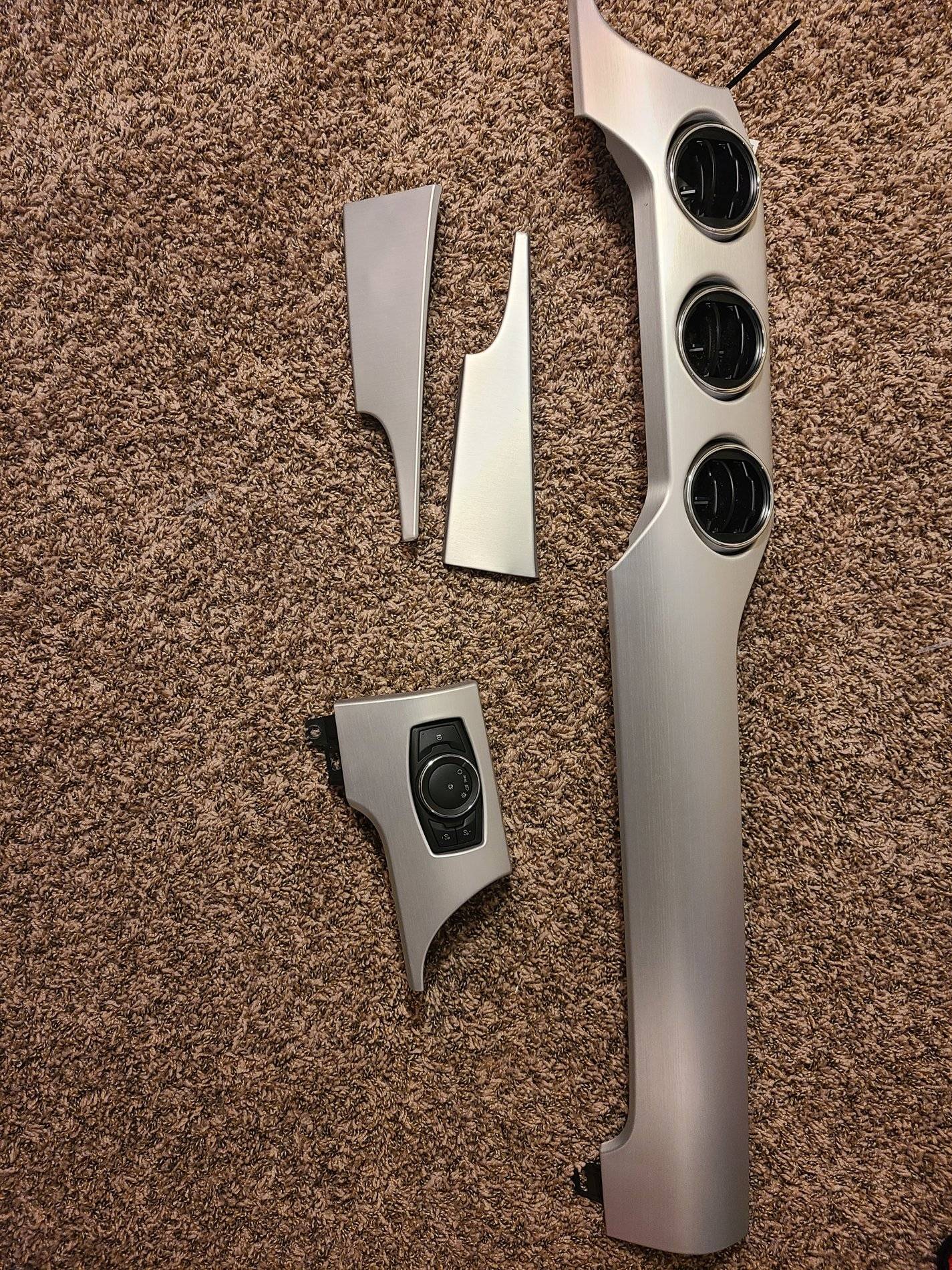

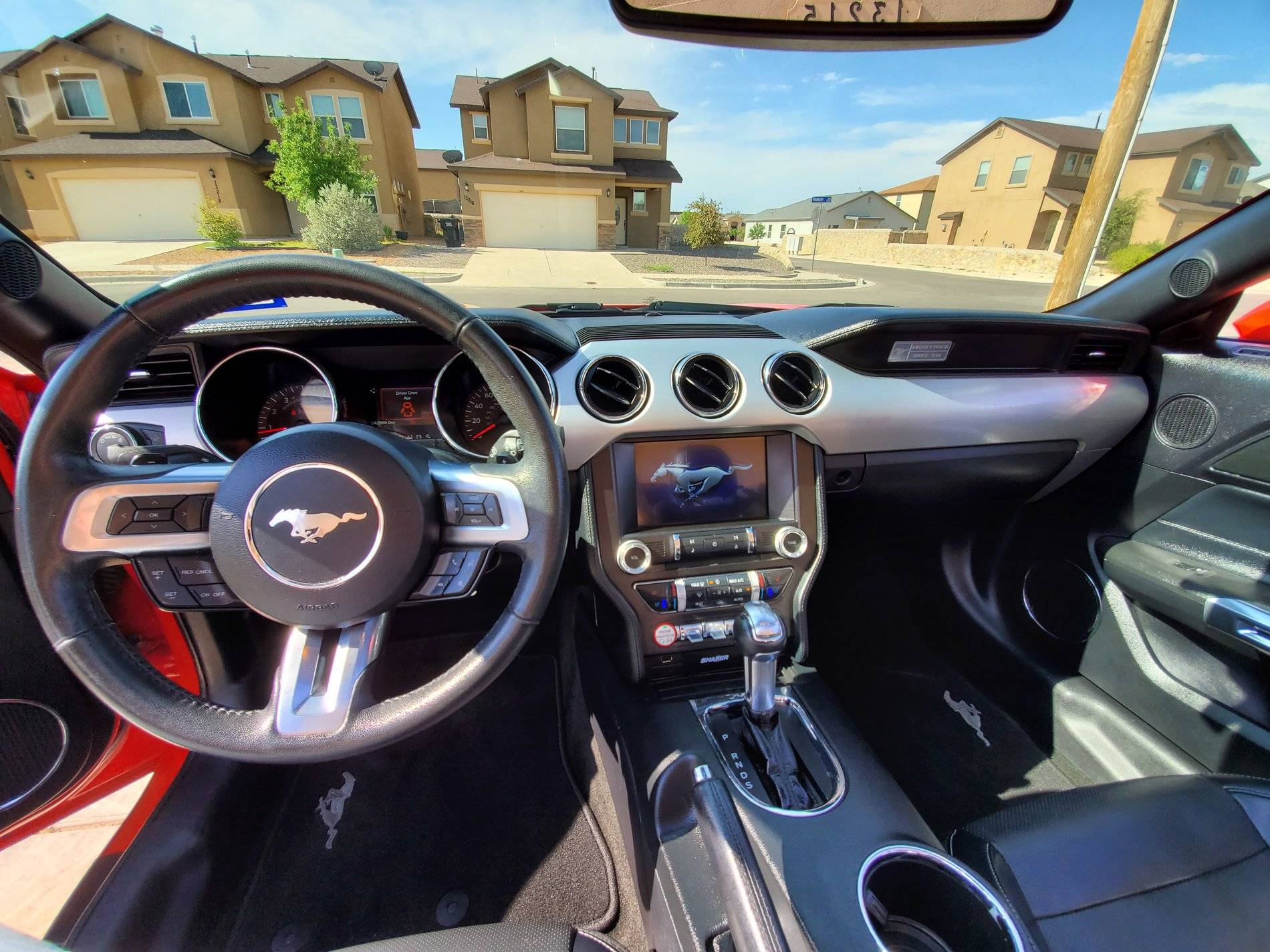

Hello everyone, im newly registered here but have been browsing this site for the past 2 years. I purchased my 2017 Ecoboost Convertible about a year and a half ago and these forums have been really helpful so I thank everyone for that! So my question today is about the interior dash trim. When I purchased the car the silver dash trim looked awful. It looks as if someone used harsh chemicals to clean it. When its clean and the top is up its not too noticeable but when the top is down it looks awful. I've been dealing with it since I bought it but recently my girlfriend broke one of the AC vents so I decided it was time to just replace the whole thing. I found a used set on Ebay for $100 which I thought was a good deal. My question is how do I replace this thing? I do 90% of the work on my car but I haven't dealt with interior components with clips and tabs and what not. My car is at the dealership for a repair and I pick it up tomorrow morning and I would like to purchase whatever tools I may need tomorrow to get it replaced. Is it a simple job or is it best to take it to my body shop guy to get it done? Any help from this awesome community would be greatly appreciated!
Also the picture I posted of my car is before the AC vent was broken. You can't see ugliness I talk about in the picture but maybe when I get my car back I can take a picture to show how bad it really is.

Well if anyone's interested at all I replaced the trim and it was the most uneventful swap I've ever done on anything haha. I thought I was gonna have to wrestle this thing off but it took me all of 30 seconds to take off and maybe 10 seconds to snap on. Idk if I got lucky but after removing the bottom right piece the top long one came off with no problems. I didn't break any tabs and putting in the replacement, everything snapped in place and was tight and flush with everything. It looks great and is a huge upgrade over the old one. I didn't replace the pieces on the left side of the dash because they're in good condition and match the stock set i purchased. It may be stock but i think it looks great in the car. I forgot to take a pic when I was done working on it but it honestly looks like any other stock ecoboost out there. I was a little nervous about swapping these out but you guys really helped me out. Thanks!!
