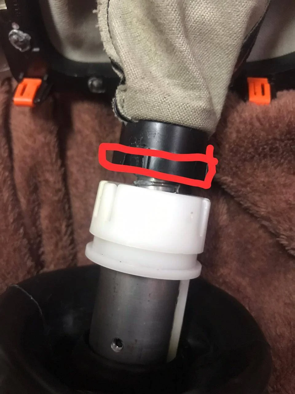

Hey WD Pro,
just installed my X-spec few days back and since then I've been struggling to unscrew the shitty Roush ball !!! it is firmly stuck and tried every possible way ? Any advice would be appreciated.
So the car is hanging out with the MGW stick and driving it in that status is real pain!
Thanks!
Mine from the factory was very tight, but I still managed to shift it by hand (after giving up on the first day I tried it for fear of breaking something).
If your handgrip isn’t good enough, maybe try one of those rubber kitchen tools for jar tops ? Or one of the rubber strap wrenches ?
I read somewhere that someone had wrapped the ball and then used grips, but I would only use that as a last resort and only if your not concerned about the condition of it once it’s removed - the chance of damage seems quite high with that method ...
Heat breaks the loctite bond, but I’m not sure that’s a viable option for that location without damaging something else.
Good luck whatever you try
