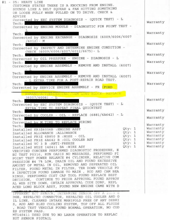

In this thread, on the previous page, a recent recipient got a rebuilt motor as proven by the dealer receipt. Have a look and I suggest you take a screenshot to put in your amo box for when you talk to the rep.

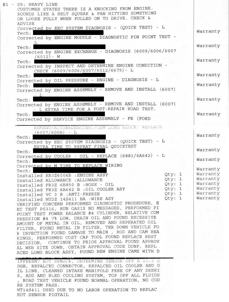

That is not a reman engine. KR3Z 6006 B is a new engine. That is generic line description highlighted.

From this weekend.
The rep was very careful to say that I will recieve a Ford factory spec engine after I told him I didn't want a remanufactured engine. The people who placed the order at the dealership told me it was a new long block, not a remanufactured engine. Who knows what the hell will show up.
I have seen that line a couple other times and i believe @btown93 is correct and supposedly they’re all new. Pretty confusing they’d have that on the sheet for sure.
