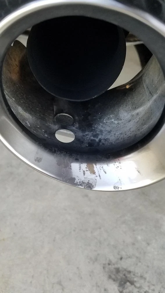

Those with high oil consumption, do you have "carbon splats" on your exhaust tips? I'm not talking about a dry powder look, I'm talking about a black splat look. (I can upload pics later) It's mainly on the inner exhaust tip not the outside tip as much and I drive with the valves open.
I have 2300 miles on my GT350, no track time, just street driving, but I drive it hard once it's above 190 degrees and I followed the break-in procedure. I have noticed my oil move down the dip stick approaching the lower hole in the last 1k miles.... no change the first 1k. The first oil change was at 1100 miles.
Just curious if those with high oil consumption have this phenomenon on their exhaust tips.
FWIW I have driven my car nearly 2000 miles and have added no oil. My exhaust tips are as clean as they day I bought it. With that being said, I have not tracked the car and have driven it like a wussy.
Thanks for the feedback. I can drive mine for 15 minutes and it looks like this. I think this is a sign of considerable amount of future oil consumption. I think the "carbon splat" look is from condensation mixed with carbon, not 100% sure. Wondering if there is a correlation between high oil consumption and engine replacement. I believe some of the engine replacements are due to catastrophic component failure.... not related to oil consumption, but I believe others are due to burning oil so drastically that people don't realize it until it's too late. That's why I check my oil every fill up.
Next question would be why does mine produce so much condensation?
