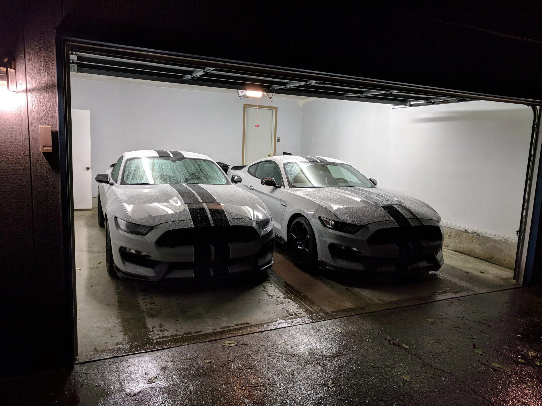

I know this was posted almost a year ago but H3298 was my car. I bought it from a dealer in Wisconsin and had it shipped here. The car was indeed a buyback, but not due to oil consumption - nor did it have its engine replaced. In fact it didn't have any engine issues at all and it never required oil. It was bought back with 983 miles on the clock due to a an extremely poor warranty paint repair.
I have the owners kit for it and would like to find its current owner.
H3298 is on the left and H3460 is on the right.
