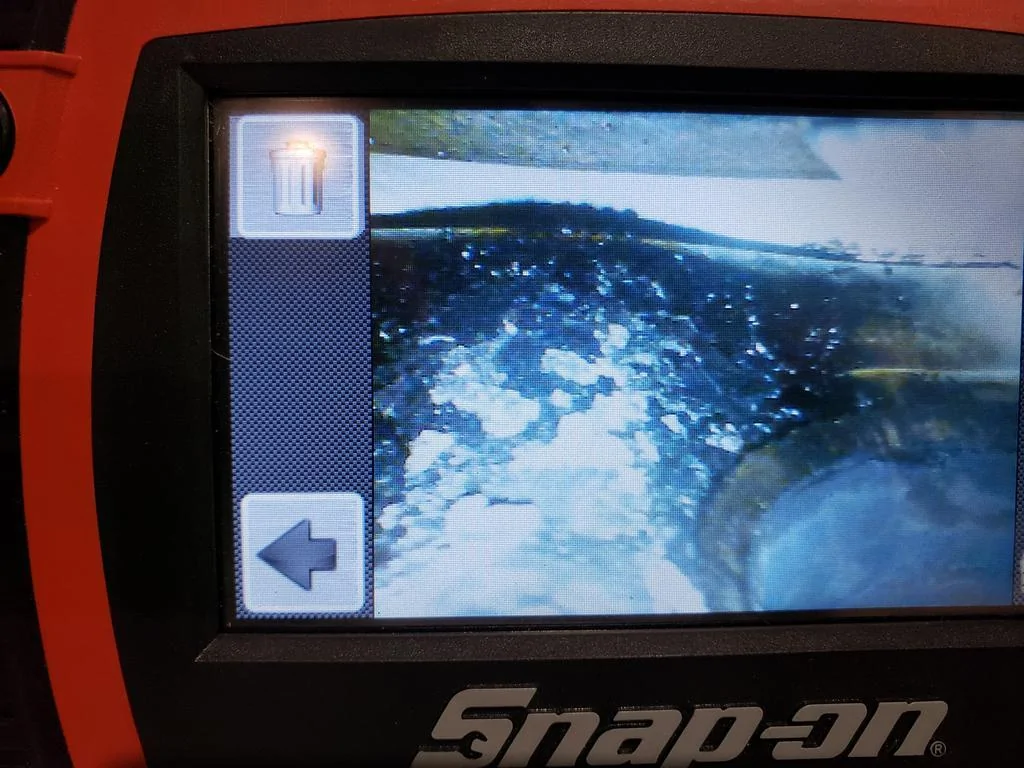

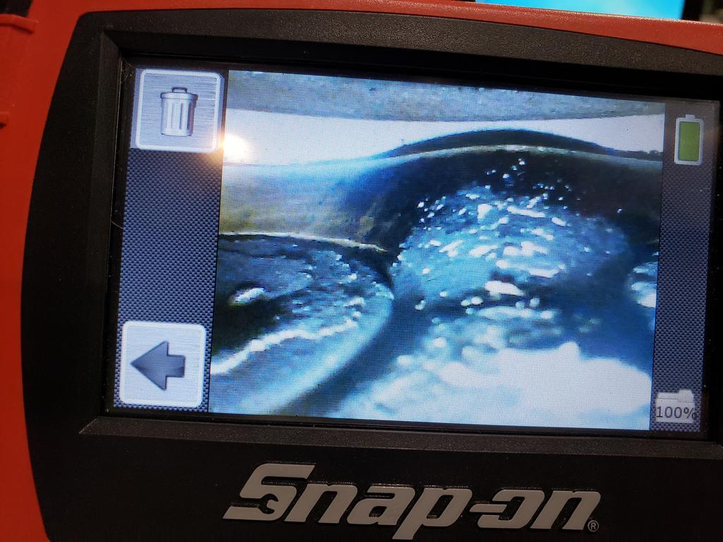

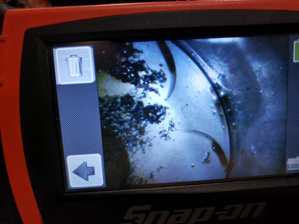

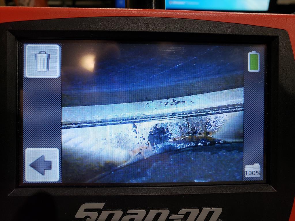

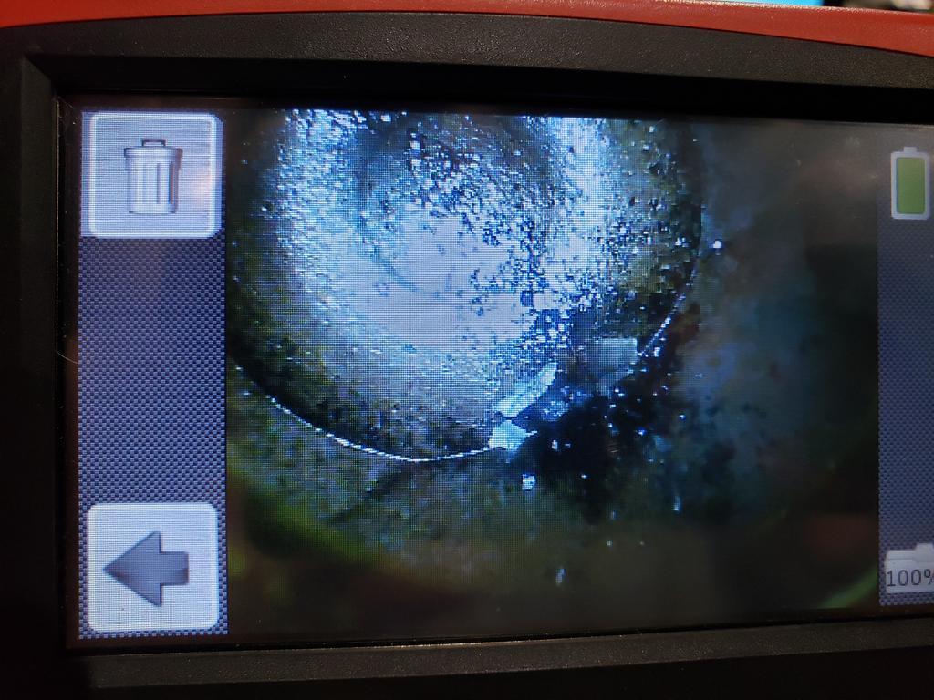

I took pictures of the Borescope images.
Remember this engine had 9500 miles on it.
I believe this is the Head, near a valves
Not sure but he was pointing out the metal chunks
Notice the oil pooling
This is the Cylinder wall
The tech that the rings did not seat properly Cylinder 2 was the worst, 3 was almost as bad and 1 was the least damaged.

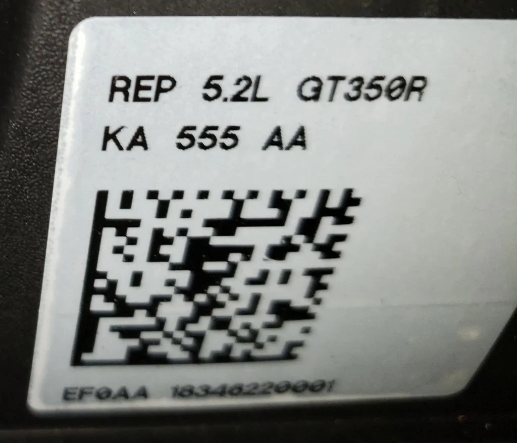

He also pointed out that the engine is a different part number.
Said that some of the sensors had to be replaced with GT350R ones ???
