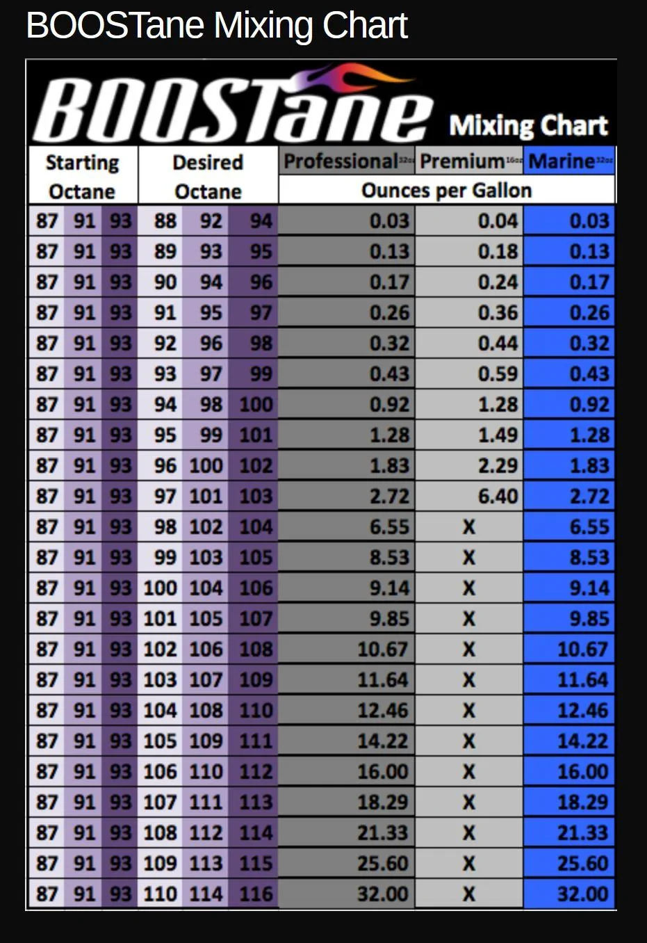

I went back to 93 yesterday. I filled it up with 13.7 gals of BP 93. I will keep a closer watch to see if I can really feel any difference. Has anybody tried Boostane or Torco with factory tune to see if it made any difference? Just curious as I am NOT sold on the snake oils known as octane boosters.
They aren't snake oils. They do actually up the octane in the tank. Doubtful if you're "feel" any difference. But I can tell you that I've datalogged several different cars on the track and all of them were able to take more timing when the octane was upped via using VP Racing Octanium.

Octane booster works, but not in any real measurable amount, unless you are using a lot.
"10 octane points = 1 octane level at the gas pump. Gumout Octane Booster increases the octane of fuel by 8 points or by 0.8 levels. Although this may vary depending on the amount of fuel treated and the source of the gasoline itself."
https://gumout.com/faqs/how-much-do...increase-the-octane-rating-of-fuel/?locale=en
If you want to spend $30/can, this stuff should do the trick. Wouldn't be bad for dyno tuning or making some passes at the drag strip.
https://vpracingfuels.com/product/octanium/

Comparing Gumout Octane booster to Octanium (or Boostane) is apples to oranges.

It follows the "you get what you pay for" theme. Gumout technically works, but not in the way you think. It's also much cheaper, so when you don't notice anything you aren't upset because you didn't spend much.
