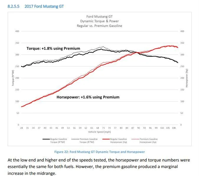

Actually, it's quite small in the midrange.
Per the report:
"At the low end and higher end of the speeds tested, the horsepower and torque numbers were essentially the same for both fuels. However, the premium gasoline produced a marginal increase in the midrange."

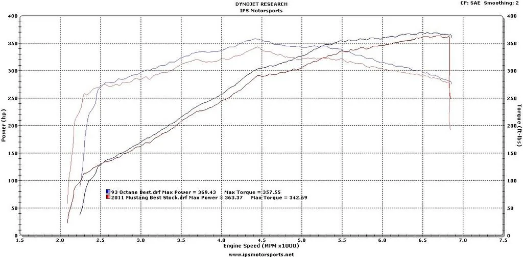

Disclaimer, Gen 1 Coyote. Below is a dyno graph showing the difference between 87 octane and 93 octane. According to the shop, no other changes were made to the car/tune/etc. Similar weather for both passes, carat normal operating temperatures.
Note: 6 RWHP peak difference. Not that much, but look at the difference in the mid range, especially 4500-6000 rpm. Looks to be ~20 RWHP difference in places (corresponding increase in torque, of course).

I've seen that dyno before, but I'm sorry...the AAA report is much more accurate as it uses scientific method along with standardized testing procedure (same room temp, same engine temp, same warmup duration etc.).
Per the report,
"All runs were averaged using a Bessel Spline interpolation with no extrapolation of data. The averaged data was then graphed and integrated to provide the numerical comparisons for dynamic torque and horsepower produced using premium compared to regular gasoline."
