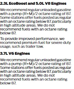

This is straight from the Ford manual, 87 is the tune baseline why would it retard timing if its tuned for 87 it only advances timing if higher octane is detected, I think they know more about their engines than anyone's opinions. It's clear they tuned it for 87 with optional higher octane, if it were recommended it would of read 91 recommended with 87 being optional, of course you get more power from higher octane if the tune allows for it, the V6 gets no benefit from anything higher than 87. I run 91 for improved performance but that doesn't mean opinions becomes facts.
Thank you, I've read the manual. So, let me rephrase.
Ford recommends a minimum of 87 octane to prevent your engine from being damaged.
Ford recommends a minimum of 91 octane to gain the maximum performance your engine is able to provide.
Same word, different intent. This is why Ford specs these engine using 91 gas.
