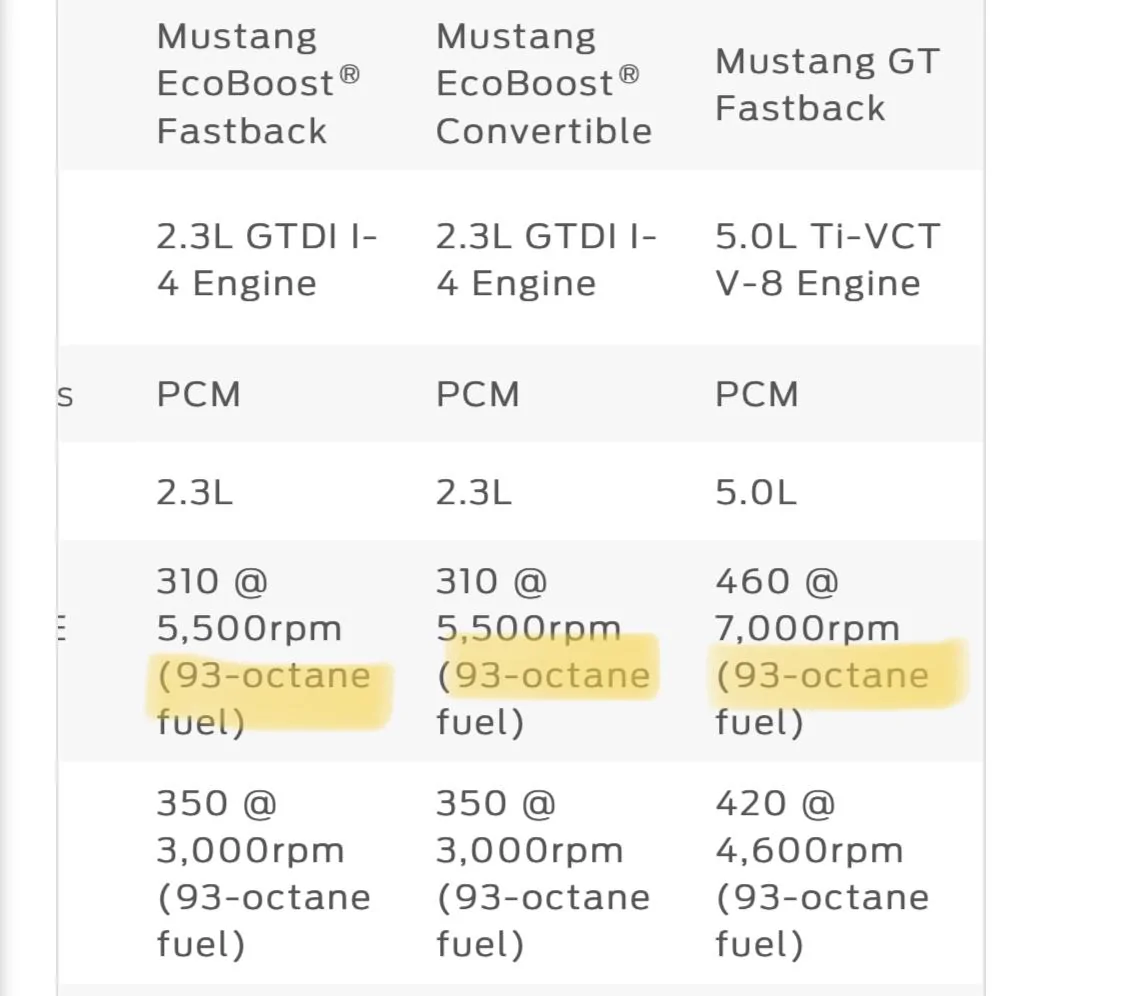

Everything I've seen says 91 octane is what Ford used to achieve their stated HP. Short of asking a Ford engineer, there is no way to tell if they also tried 93 and got better results, but chose not to state them. You'd need some dyno time to prove otherwise.
As far as I know it’s always been 93. You can look it up under specifications on their website and then the sub category engine.
Where did you see it say 91?
Perfect thank you that helps as it seems the cars power was determined with higher octane than 91.
No problem, happy to help. I have no idea what kind of a different 93 to 91 has but I would assume less than 93 to 87.

Interesting that they'd recommend an octane level that's not available everywhere. I guess the folks in CA don't get all 310 horses.
That is not the recommended octane, just the octane the used to achieve max horsepower. Minimum octane requirements remain at 87.
As for horsepower on the 5.0, the 2015-2017 GT was down around 10HP on 87 vs 93 during. For anyone doing a SOTP test, 10hp really is negligible. My guess is the 2018+ 5.0 having both port an direct injection is going to be similar.
