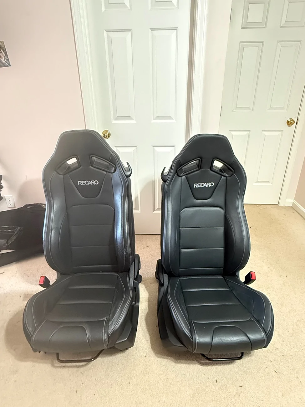

Just trying to get some solid info on selling my Recaros. Just did a seat swap with some Mach 1 leather seats. It went great, I love them. Other than the seat going back every time I shut the car off, I'm happy I made the switch. Now the question: What is a fair price to sell the very good condition recaros for? Ebay has them for an outlandish price, I'm not trying to gouge anyone. Just want to be fair and recoup some of the money I spent on the other seats.

Here are the ones that came out. 2021 Mustang GT.

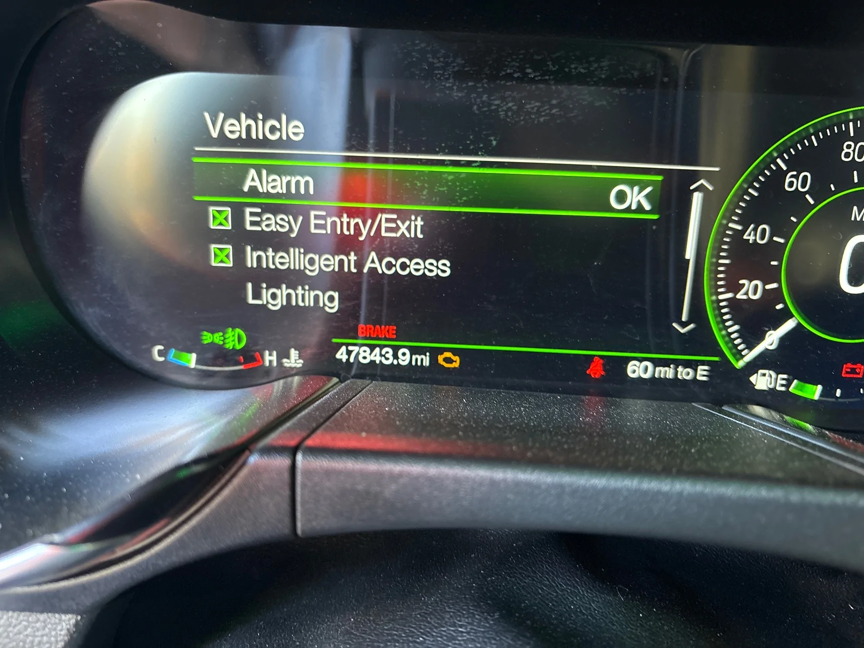

BTW. You can turn off the seat moving on shut off in the settings. Advanced Settings - vehicle - easy entry/exit.
The problem is, my car came with recaros. My settings don’t have that option.

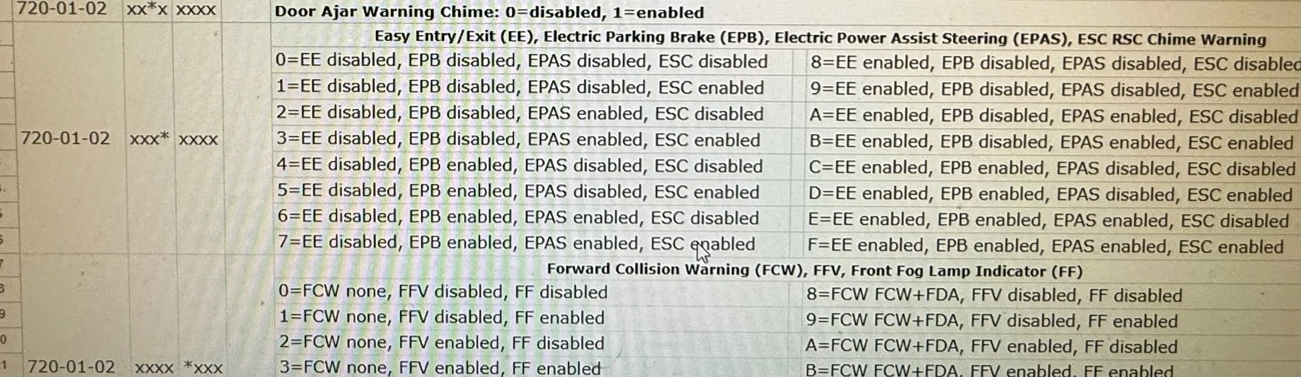

I think you need to look at the IPC section in ForScan and enable the option on your dash. Then you will just turn off the easy entry from the dash menu.
But I don't know the codes for that. Maybe they are in the spreadsheet in the big ForScan thread.
