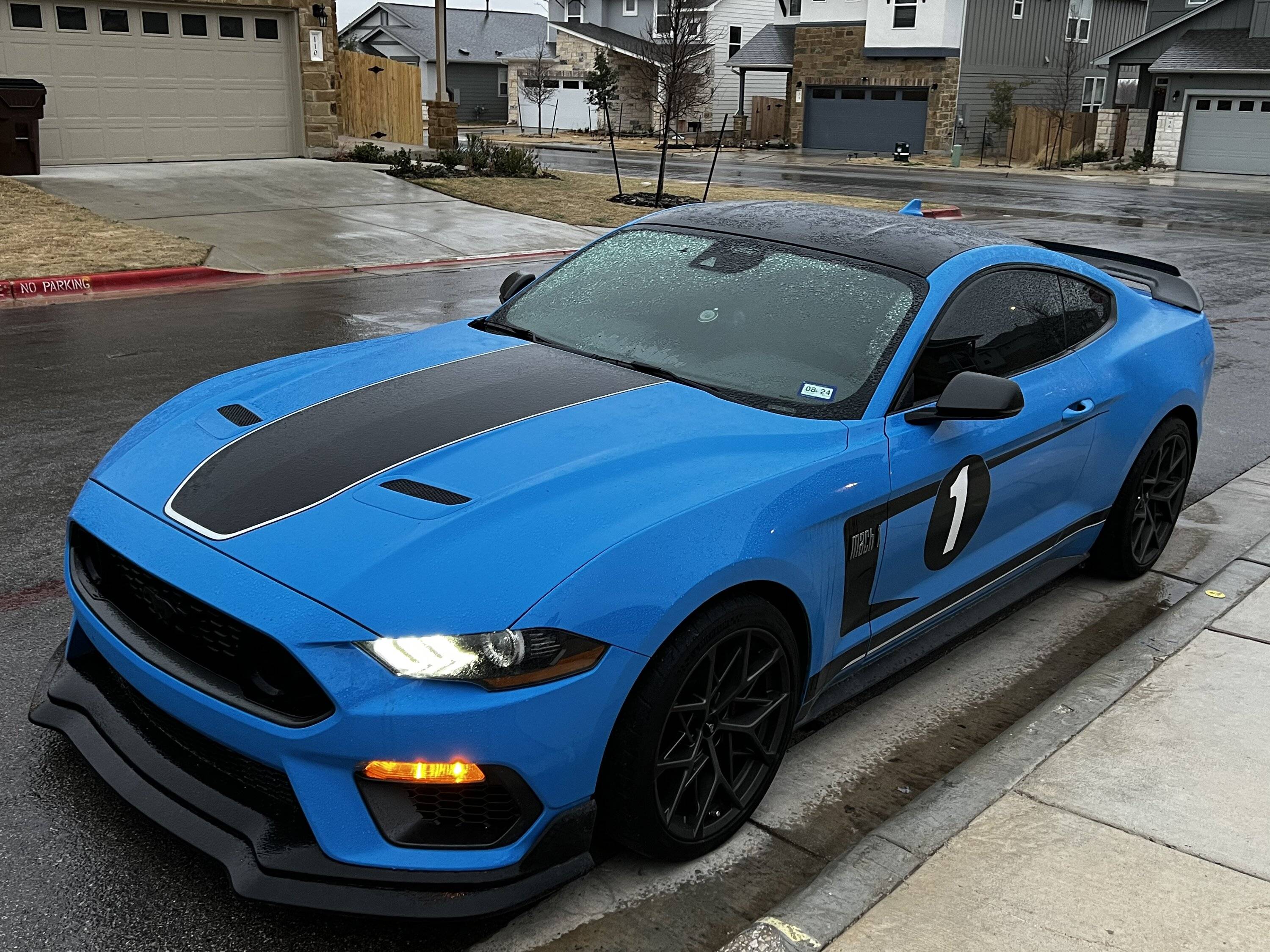

Currently my vehicle is stock except for a whipple stage 1 and double x pipe resonator delete. I’m tired of the cup 2s already as I use my car as a daily. I want to swap out to Michelin pS4S which I know are good tires, but I’m debating as to how wide I can go. I’ve seen some people go with 325/30r19’s and be fine, but I’d like to get to 335 or 345s if possible. I have the handling package, and I don’t want to change anything suspension wise. What’s the max I can run on 19’s without rubbing and also keeping my Speedo reading decently accurate?

That number 1 on your car sure looks good. Best addition I have seen on a Mustang this year. I hope you find tires you like.

I can’t help with your tire question and in fact I’d like to know myself.
I can tell you though that your “stock except for a Whipple” comment caused me to spew coffee on my keyboard. Consider yourself the master of understatement!
And great looking car!
