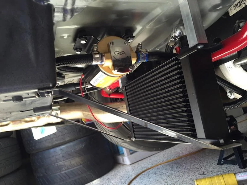

Testing my home made cooler this weekend during the Chin happy hour end of day session. I have a temp controller set to come on at 90 deg C (195 deg F) at which point the pump starts to circulate the oil. I'm running 75w-85 oil.
Will let you know how hot the oil gets, my temp controller monitors diff temps full time.

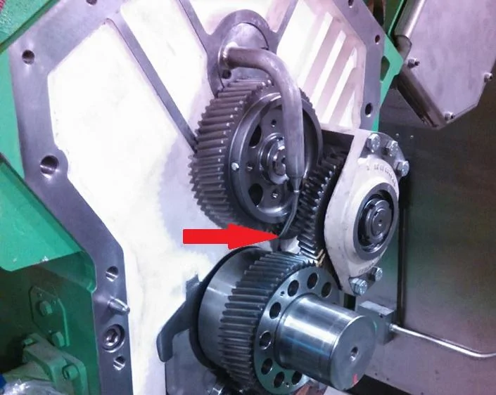

Input speed from pinion overheats the bearing. Why is shows up immediately on 3.73 cars and [MENTION=22207]steveespo[/MENTION] with 3.55's (I think) run's a lot of high speed tracks.
This is honestly making me think about adding a nozzle inside the cover to flood the bearing with cool oil as it returns from our cooler. We have done this before on the industrial side to eliminate failures, focus oil to critical load points when splash lubrication was not cutting it.

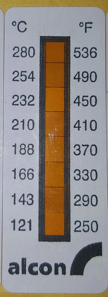

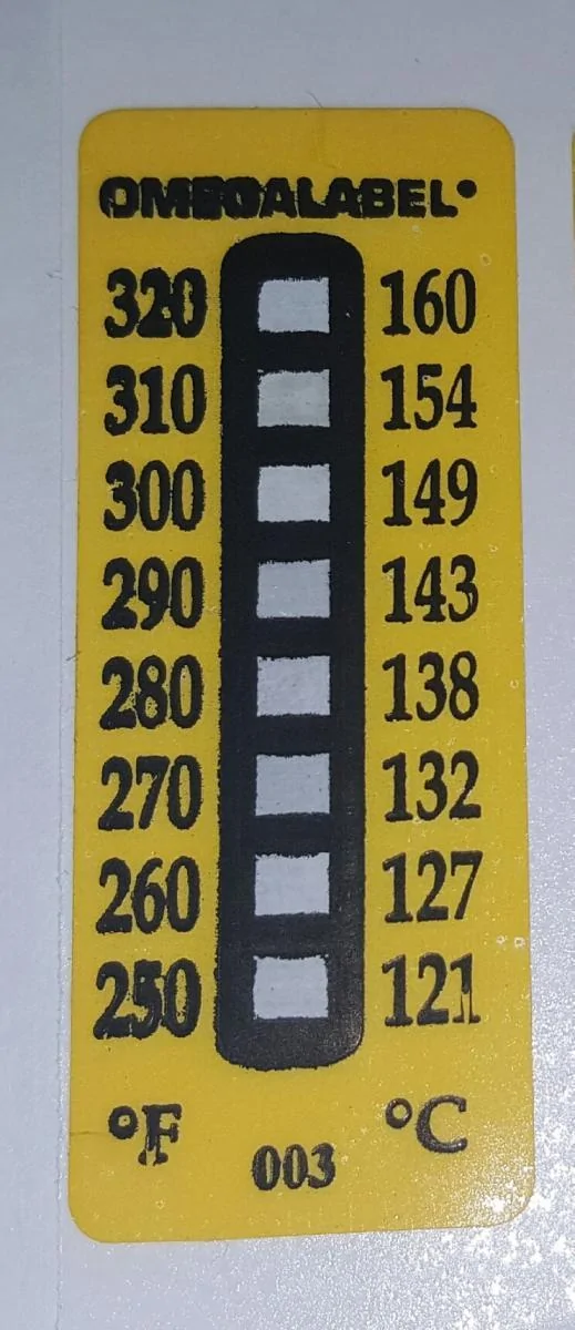

We've added a couple one time use temperature strips to our site. Two ranges, one is the industry standard Caliper Tape from Alcon and the other one is more for under-chassis temperature monitoring.
Alcon 250-536F STRIPS
OMEGA 250-320F STRIPS
The Alcon has a wider range but the OMEGA has a more focused temperature window.
It's a relative cheap and easy way to get a fairly accurate ball park on Transmission Temp and Rear Axle Temps.
They simply indicate peak tempertures so you want to check them as soon as you pull off track so you do not read 'heat soak' temps.
