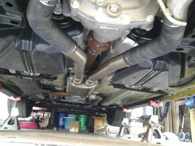

Thanks to this thread, I changed my diff oil to 75W140, and wrapped my exhaust on either side of the diff. Hopefully the wrap is still on there come Saturday, which is my first track day.

No, my non-PP 2016 GT does NOT have the temp sensor, which is precisely why I am taking the preventative approach.
If I am in the spirit on Saturday, I may see if I can crawl under the car (w/o stands) and put my K-type temp probe onto the diff case after some laps. Otherwise, those temp sticker dots that I referred to would be more convenient.
