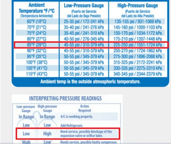

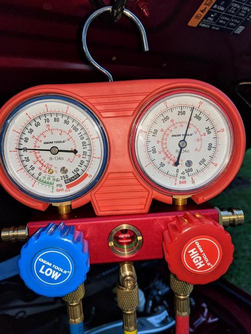

I utilized the "rent a tool" from AutoZone and rented a set of a/c manifold gauges and got a can if r134a in case it needed recharged.
Hooking up the gauges, the readings on both the Low side and High side were both low to start. So, to me that would explain the random performance cutting in and out, because the same thing just happened with my house just a couple weeks ago...
So, I hooked up the r134a can and started to recharge. However, after recharging, the HP was reading correct, but the LP was STILL low. As a reference, the ambient temperature was 85degF
After consulting the pressures chart below, and the indication of the results...it seems that I need to take it BACK to the dealership, as this may be pointing to something else that might still be going wrong with the system itself and not just the refrigerant level. :( But, at least I will know against taking their word for "the pressures are fine" story....
