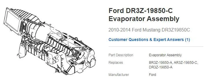

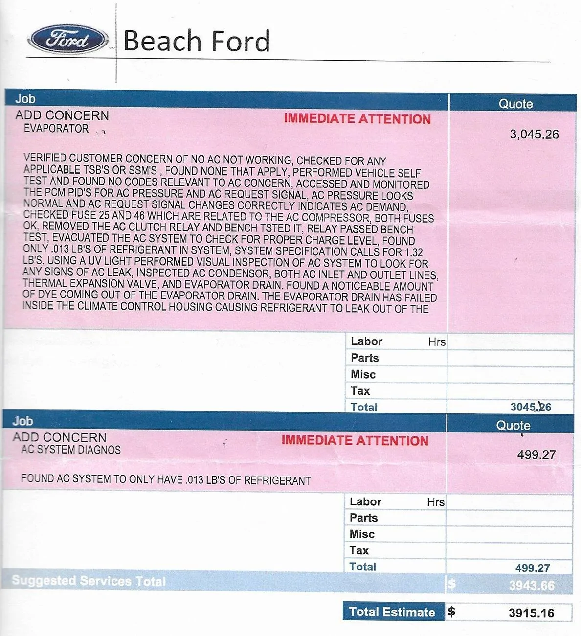

My 2011 Mustang GT is now having this issue at 77K miles. Every place lists the DR3Z-19850-C Evaporator Assembly as discontinued and I can't get it anywhere....going to have to refill as I go.
