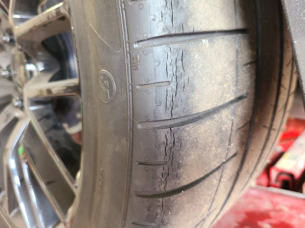

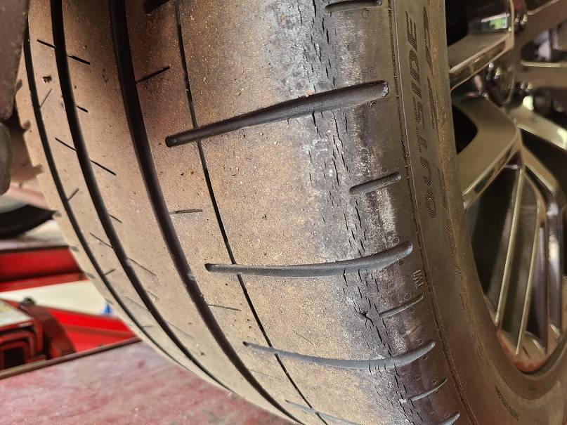

They will crack if you mount them after enough time. I bought 2 pairs of used pzero corsa F tires , one pair made in 2018 one made in 2016. The 2016 sidewalls cracked when I mounted them on my rims.
They still work fine but its kind of sketchy and I will be buying ~3 yr old tires at max from now on. Definitely would never put even properly stored 7+ year tires on a vehicle imo.
You know how Paul Walker died right? His Carerra GT had super old original OEM tires and they hardened up leading to the vehicles total destruction and he and his friends death.
In other words, use them while they are good I think they would just be a hazard if you keep them and remount them years from now.
