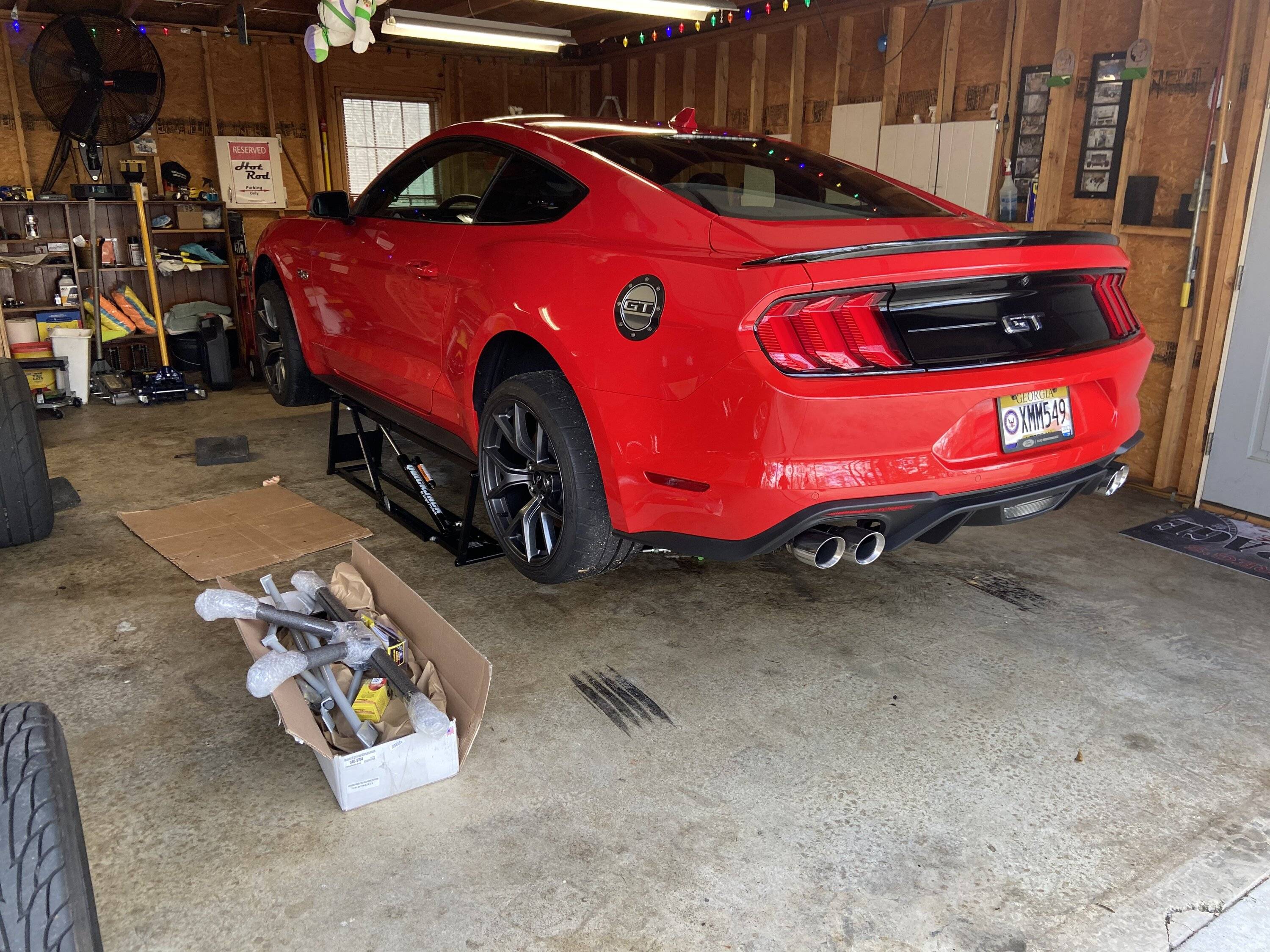

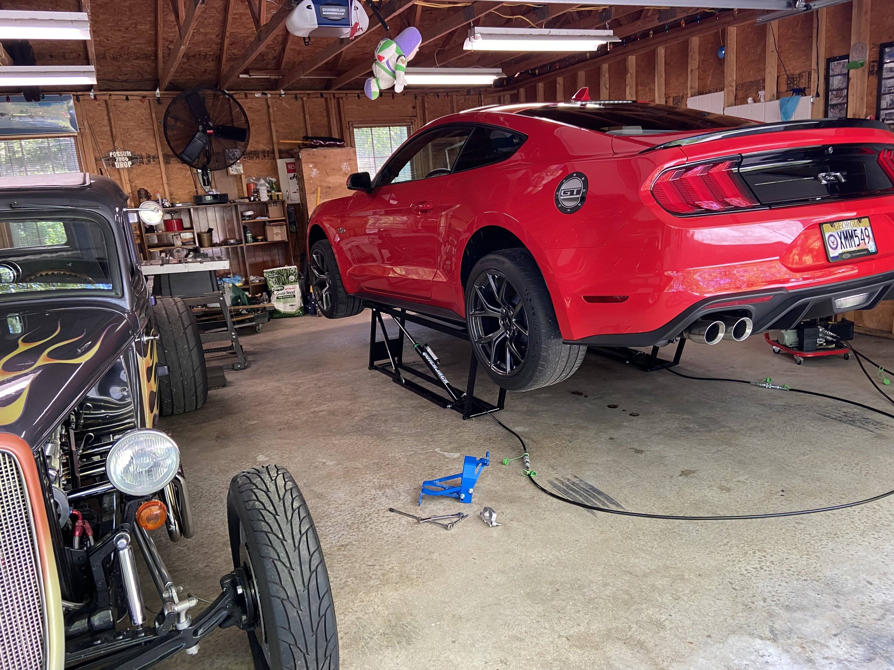

First shot 5000LX
Note the distance of the white cabinet door & roof
line .
This is the 5000TLX worth every red cent.
A friendly, tip the pneumatic rams do and will leak down, check before using. I removed the Schrader valve & housing, Teflon taped the threads, soap checked for leaks.
None found, 3 months later rams needed a charge.
Why for & what is the purpose of the rams? They are there to fully collapse the jacks. After the car is resting on the tires.
