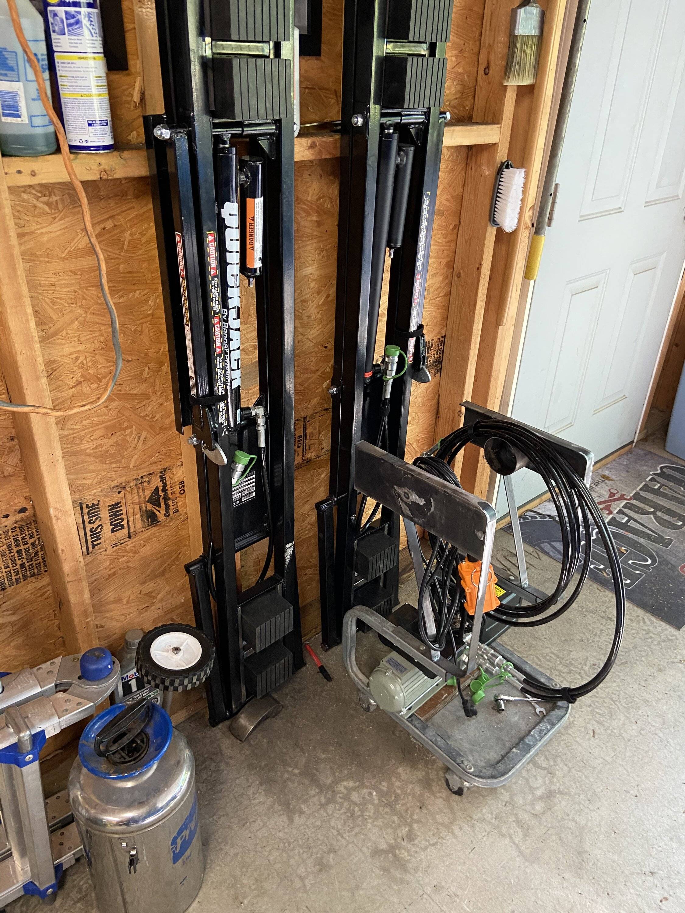

I can answer that, once the jack is full down, keep the down button depressed, count to 10/20, pressure is natural.
Natural pressure will allow easy, no hassle connecting and disconnect.
OP be sure you check the ram assist cylinder air pressure before using, it will leak down over time, its a given.
Its purpose, after the car is on the ground collapses the jacks, to full close. Best advice watch the QJ assembly ytube clip explains some of these things visually.

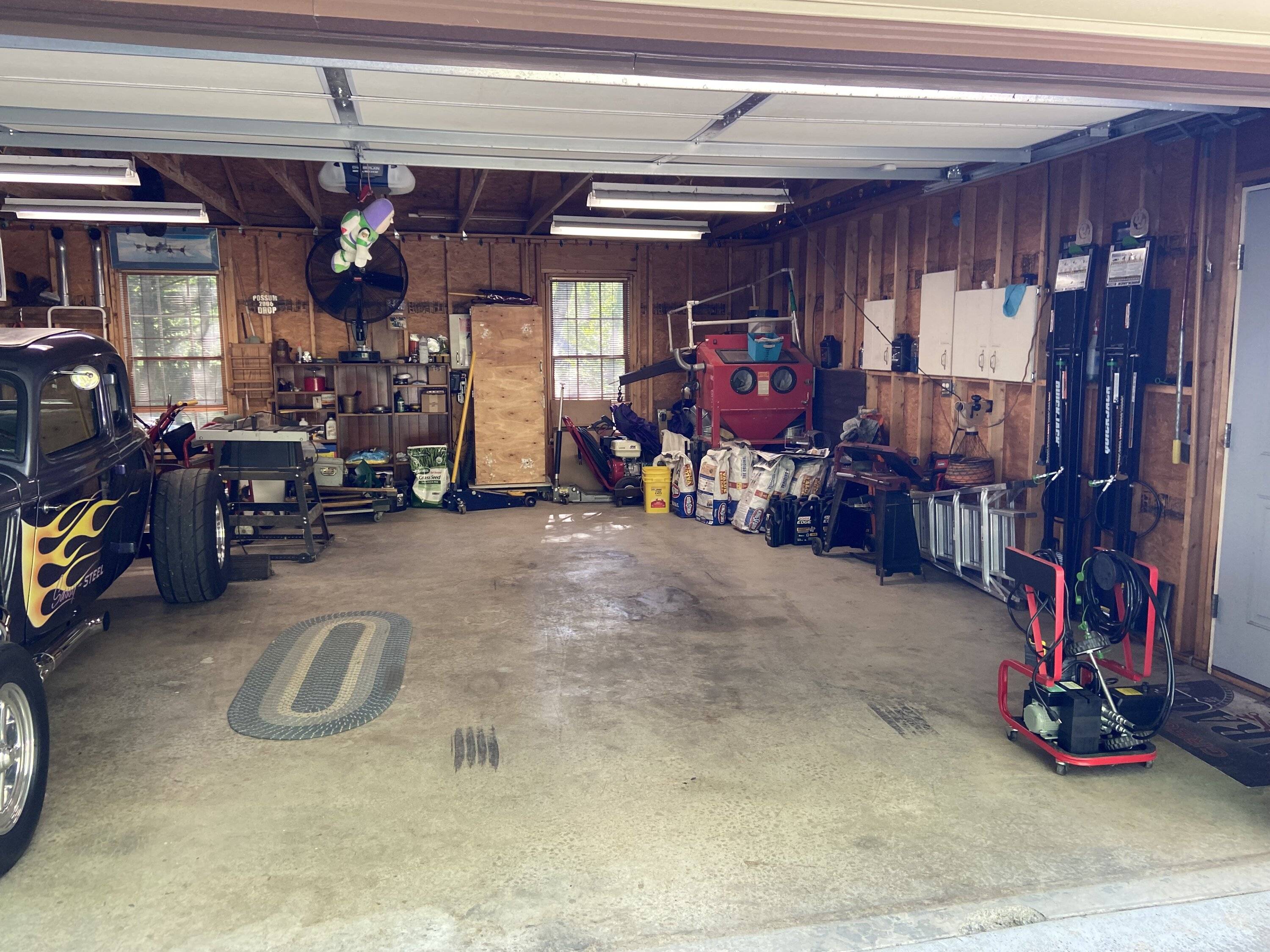

Yeah, I did a pump cart also repurposed mechanic seat
finished
