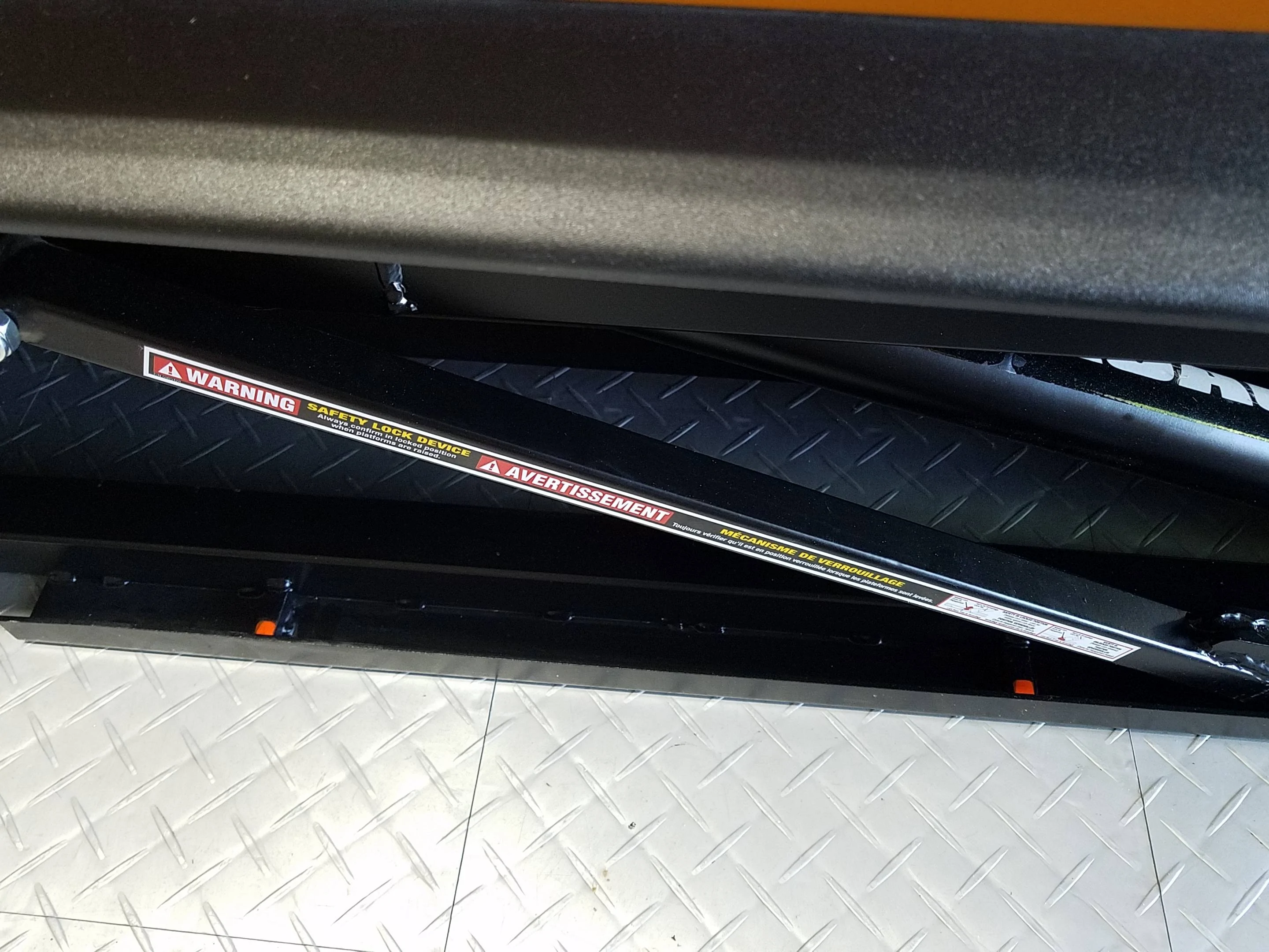

I used my orange paint pen on the lock blocks to make it easier to inspect that the bars are locked.

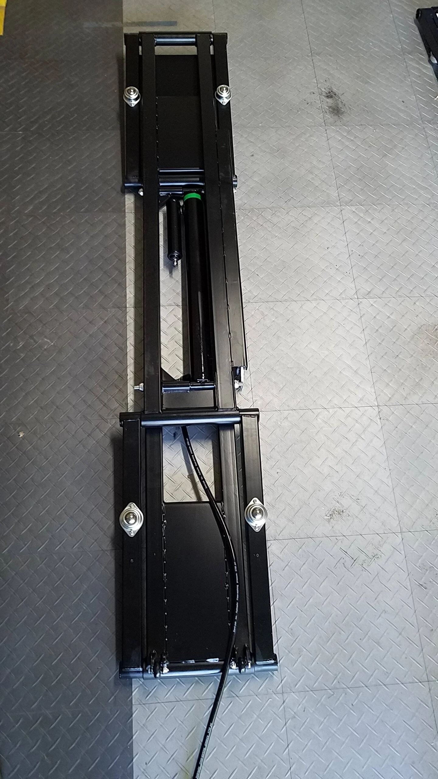

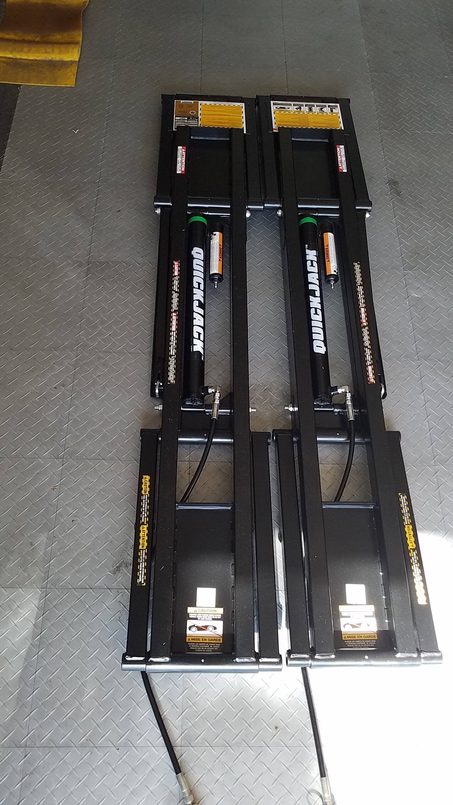

You can keep them on the floor together and park your car over them. With the roller ball mod they will glide into position.
Here are my 7000TL ready for parking. Also shown is how I implemented the roller ball mod.
This looks cool. One question - When the car is lifted, all of the weight sits on these 4 very small contact points. Does that cause any damage to the rollers or the garage floor?

With those roller bearings installed ? No - watch the video - bearings are not in contact with the ground (they wouldn't be able to handle the load anyway) once jack is extended.
Ok, I should have read the rest of the thread! Lol

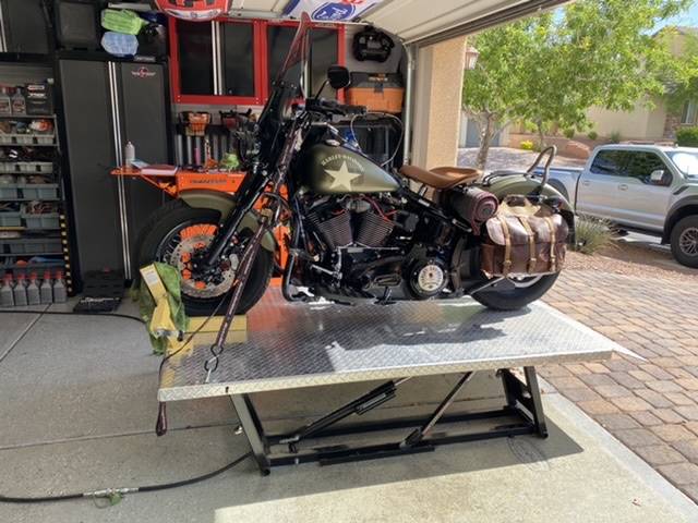

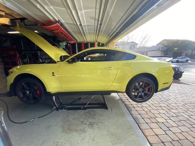

It have the 7000 series and use it on just about everything from my cars, jeep, truck, and motorcycle. It hangs on the wall when not in use, and a highly recommend the caster mod.
What size rollers did you use?
You used 4 while the video used 3 with just a center one at one end but am guessing that was just cheaper. I'd prefer 4 for a bit more load capacity and not making a base for a center roller.
Question for anyone:
Any reason other than cost and a fraction of an inch higher when collapsed to not use 1" instead of 5/8" rollers?
