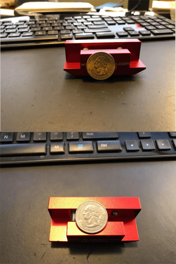

My lift pads arrived a couple of days ago. I'm surprised by how small they actually are but they are well built and solid and look like they should do the job just fine. A lot lighter than jacking rails. Put a quarter in pics for size perspective.

Are you going to use with QJ? If so review please?

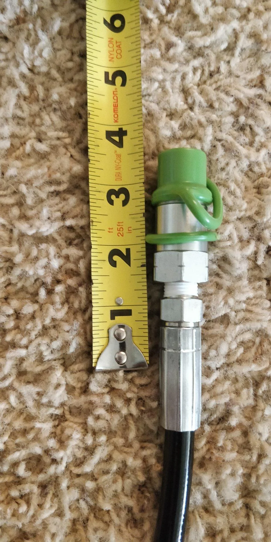

How tight were y'all able to attach the qd's to the hoses?
I got as tight as I could by hand and have about 1/4" gap.

That's about right. If they are tight and dont leak then they are tight enough
