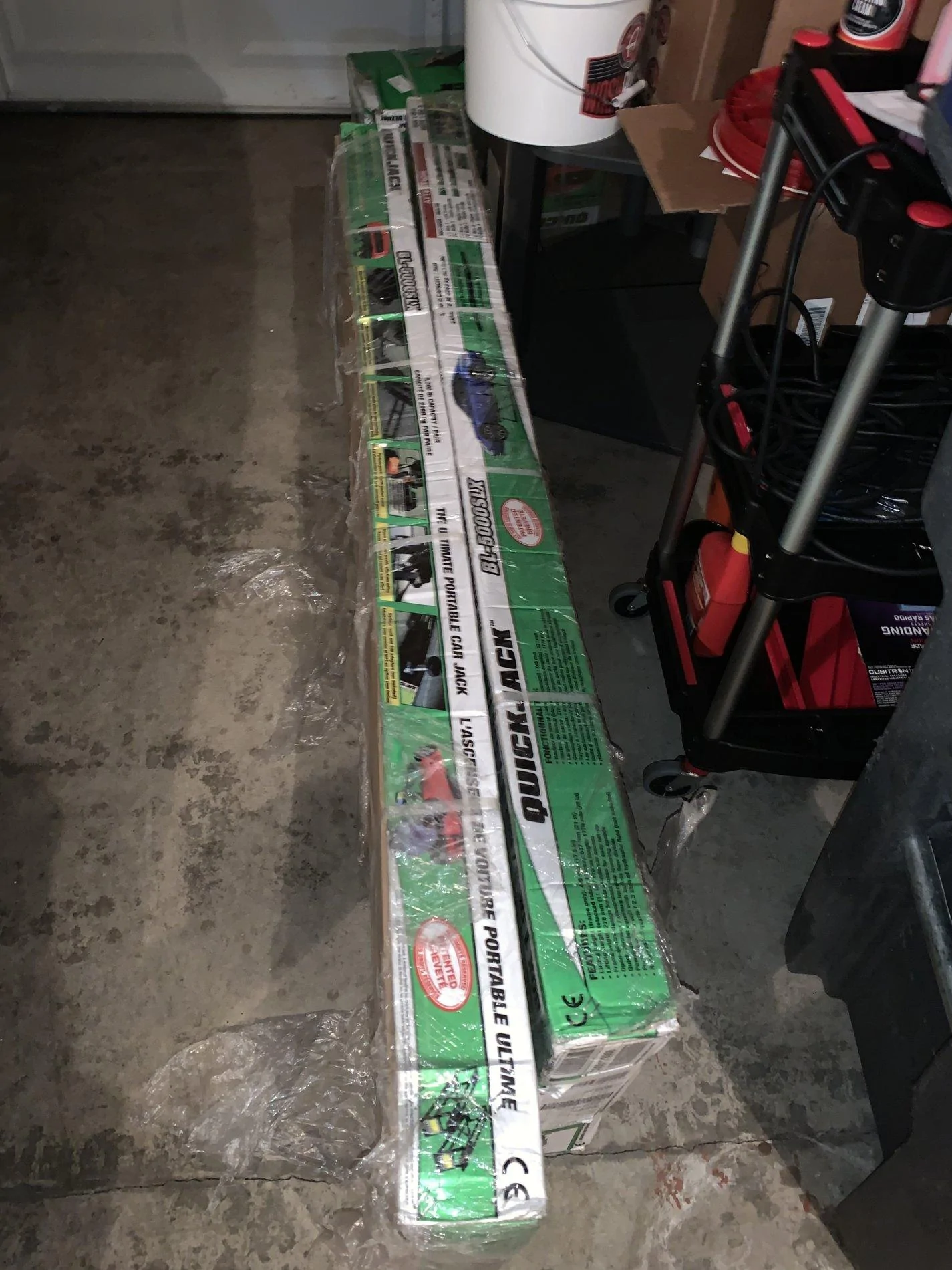

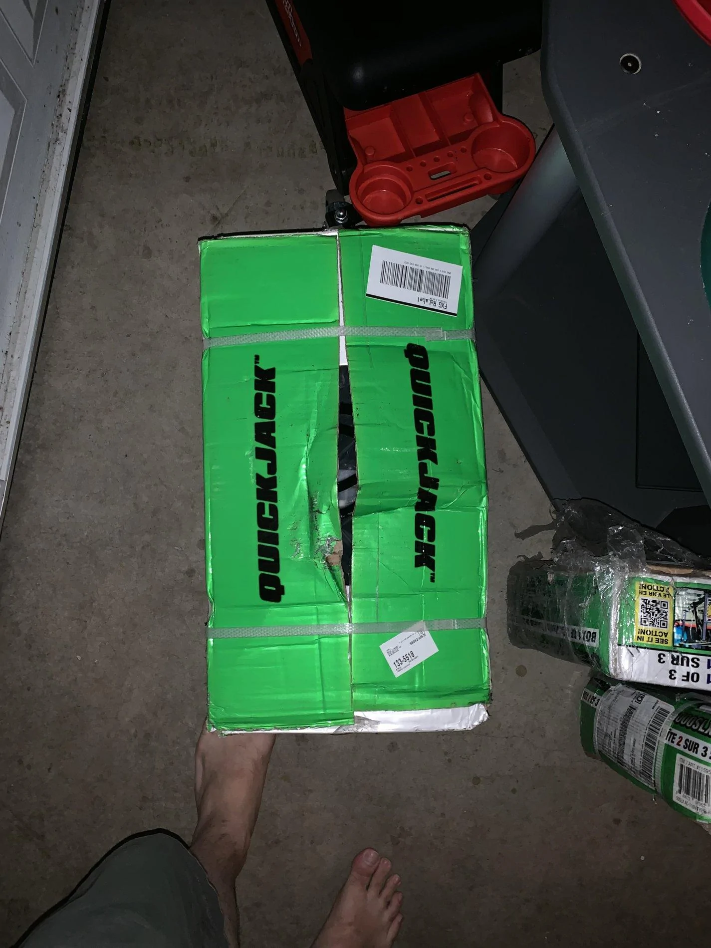

Got mine delivered today. Not in the best of shape...everything looked good out of box

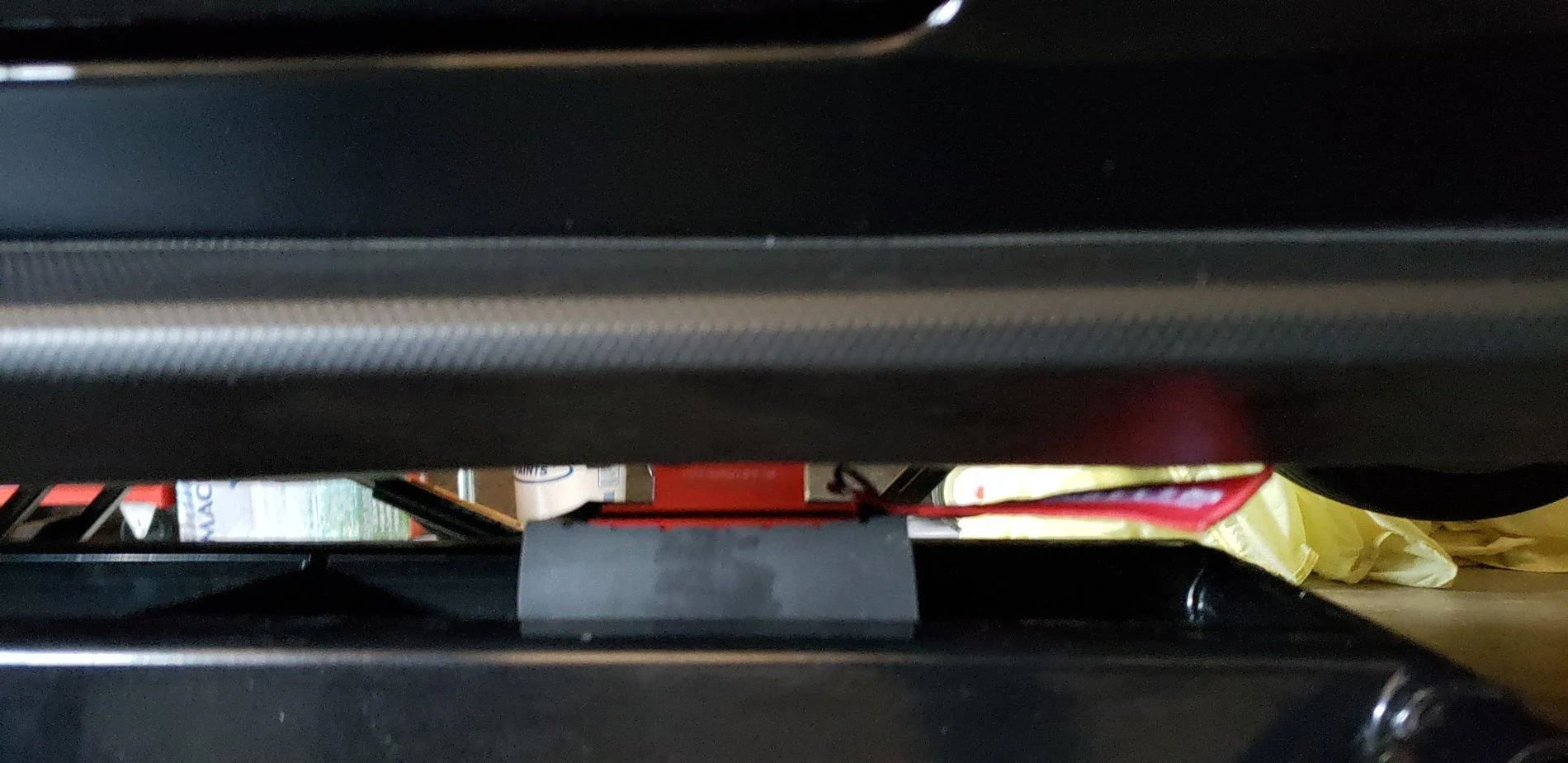

You do not need absolutely anything to protect pinch welds - that's complete nonsense from the "you absolutely need jacking rails, otherwise you're going to die" crowd. There are literally millions of cars on the roads being lifted every day by their pinch welds in service shops. And they're fine. In fact, I lift my 54 year old car by pinch welds and it's fine.
What you need for quick jack is something to protect the rubber blocks from being split by the pinch welds - with car that heavy, they eventually will and set is like $80. Either rails or jacking pads work fine for that purpose.

Yeah that is with quick jack told me. Pinch welds would slice block eventually resting on metal frame. Has anyone tried the ZL1 add on lifting blocks that mount two the car? Kinda scared of fit and rust in general.
kz
Oct 26, 2014
4,605
2,926
West Chester, OH
Mustangs & F150
Yes - I have them - work just fine.

Yes, absolutely - I set up rubber blocks so they hit the pads when the Quickjack is going up.
Plus you have to install the pads where they even can align to hit the blocks. The blocks don't have a huge range of placement.
If someone doesn't care about the slight amount of extra weight, BMR (or other) jacking rails save the time of making sure they line up with the QuickJack, plus make it easier to jack up the car when the QuickJack isn't available. If pads are installed where they are needed for the QuickJack, they won't be in good spots to lift one side of the car with a single jack placement.
