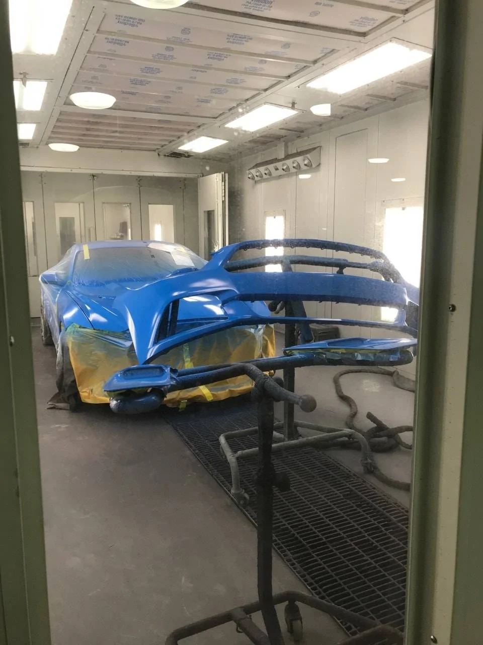

like this (also got the chips fixed)

This would make sense for an older car, my new one is brand new, which makes me think the spot painting and blending won’t be an issue.
I was just going to sand the holes down, fill them, sand, prime, and use touch up. Trying to keep the area I touch as small as possible.
