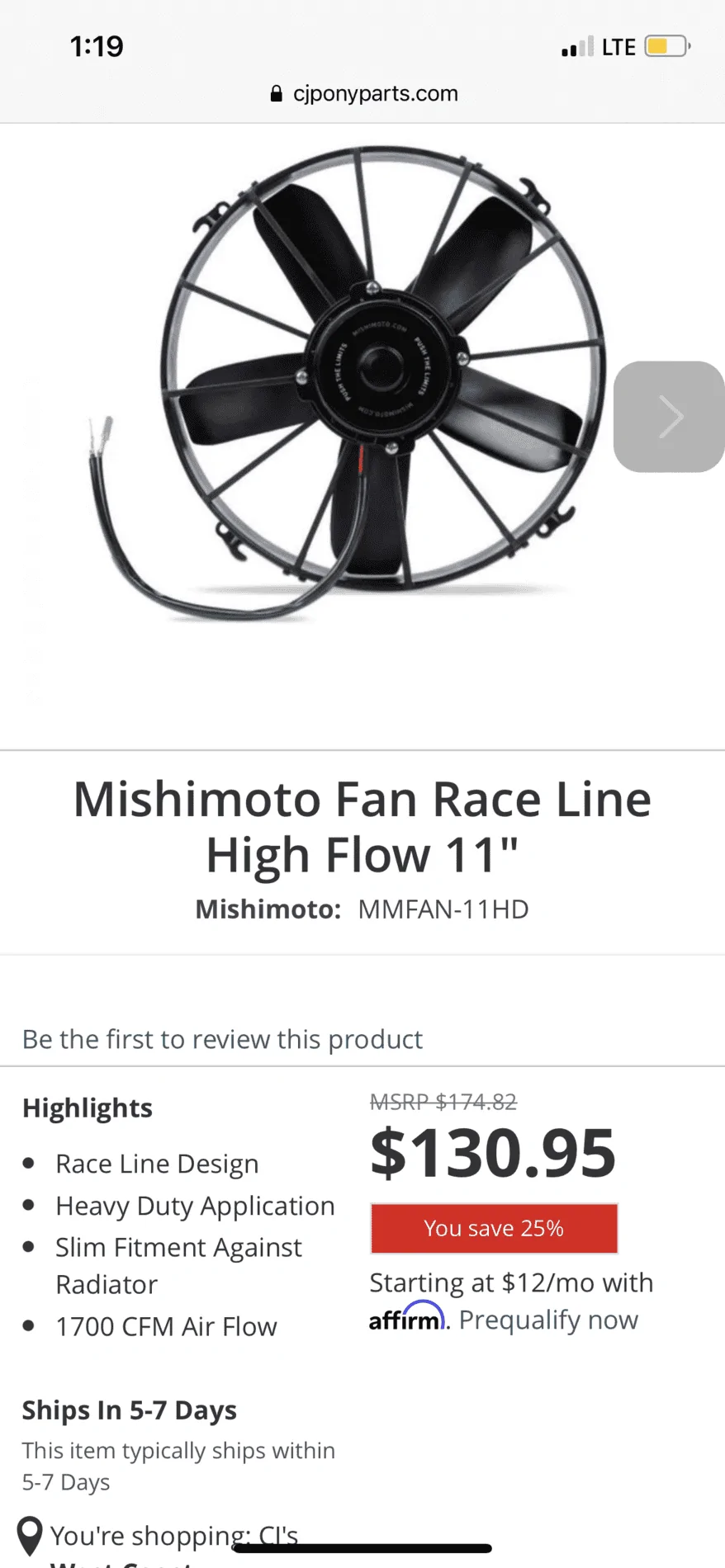

I have put two of these on a s550 with no shroud and they move more than enough air that you do not need a shroud. They are very powerful
Yea I think this is the route I will go with for fans. I can't find a good two fan shroud so I will most likely just run two of these without a shroud. I'm still hoping the bottom air dam will make a noticeable difference though.
Thanks for the info
Thanks for the info
Like these

On your set up I would probably just run the fans right on the radiator
