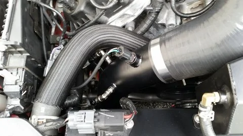

first a little about the car. its a 2014 mustang with a f1 procharger kit, snow performance water methanol system, Boss 302 intake, and a forged motor. I bought the car this way and don't know the previous owner and the shop that built/tuned it went out of business.
My questions/concerns are while logging the car with HPtuners I can see the car is reading IAT and Manifold pressure/boost but I cant find these sensors.
The first question is where is the car seeing intake air temp? because I don't see any external sensor for it to read from. and the temps don't come down when the meth system comes on like all my other cars in the past have. I have two nozzles one pre blower and one post intercooler.
Second question where is the MAP sensor located because I don't see one in the manifold. And while logging the car the map sensor readings don't match what my autometer boost gauge is reading. The sensor is reading way higher than the gauge. The boost gauge is plumbed into the manifold FYI.

All those sensors are in the maf

The car doesn't have the stock maf. I believe it has the one that goes into the intercooler from procharger.
And I don't think it has the iat built in cause if it did it should show a drop when the meth system turns on.

It's in the intercooler. You don't see the iat's drop because you shouldn't be spraying a lot of meth before the MAF sensor anyway.
Relocate the IAT sensor from the maf to upstream from the meth nozzles. Then spray all the meth you want. I run dual 16gph nozzles.
There is no MAP. IAT is measured at the MAF. Vacuum/Boost is read from a sensor from the brake booster.
Any idea how accurate that sensor is for measuring boost? Or how hight it's capable of reading?
I ask because my mechanical boost gauge is reading 12psi and the datalog shows 16.9psi.

Boost/vacuum is inferred and accuracy depends on how good the tune is. iat is in the maf. The maf in the intercooler is stock. Get a breakout harness
Okay so from what I read the harness will be pinned in the ecu into the IAT 2 location. Will I be able to view the IAT2 on the dash like I can with IAT 1?
Or is that something I can view only with a scanner?
I'm guessing my tune is not very good considering how far off the boost is reading.

I have water/meth as well with a breakout harness. I am using the same IAT pid as did prior on torque and have a readout on the dash as well with nothing done to change the readout. I did notice it was different in hptuners than before.

No idea, I put the breakout harness in and I still see IAT. Maybe it is still IAT1. From what I remember it is hotter than it was before (so I assume it is what the breakout is reading). Also on hptuners the iat I used to read our is a constant now and it is different parameter for IAT. Next time I log ill verify they correspond.

Nevermind.. Had a mojor brainfart haha. It reads IAT just not from the MAF anymore.
