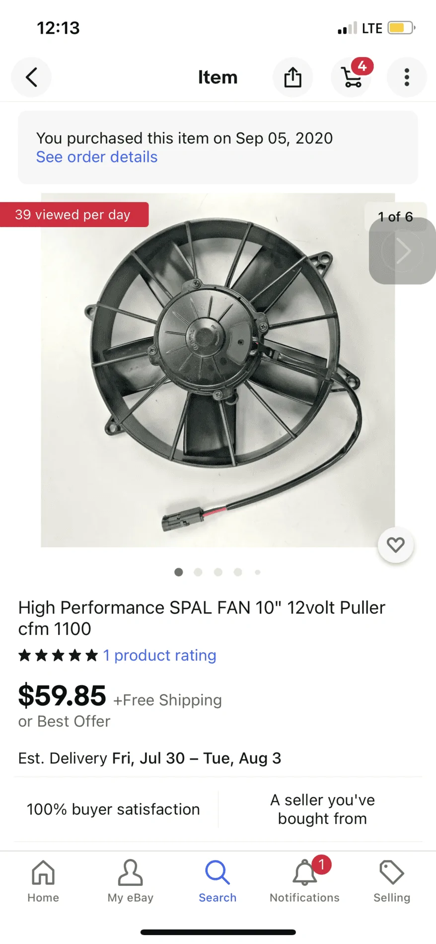

Yea the shroud is pretty much against the radiator. I actually had that same thought but multiple people have told me that without the shroud the fan won't be nearly as effective.From the picture of the fan, Is the shroud completely flat against the radiator and the only place for air to come through is at the fan? If so it may be worth pulling the shroud off. That way when cruising it will be using the whole radiator.
all factory shrouds angle out from the side so there is always air flowing through the whole radiator. the idea of it is to force the fan to pull air through the radiator and not pull the air in from the sides of the fan. If the shroud is tight against the radiator it's stopping a lot of airflow.Yea the shroud is pretty much against the radiator. I actually had that same thought but multiple people have told me that without the shroud the fan won't be nearly as effective.
I mean it's not sealed to the radiator. But it is very close. There is a small gap all the way around though.all factory shrouds angle out from the side so there is always air flowing through the whole radiator. the idea of it is to force the fan to pull air through the radiator and not pull the air in from the sides of the fan. If the shroud is tight against the radiator it's stopping a lot of airflow.
What! You need the shroud as tight against the radiator as possible or it will not pull air through the radiator. So at low speeds the car will Get hot or overheat. the whole for the fan is large enough for double the air flow that is needed. A lot of fan shrouds come with a rubber seal against the radiator so there’s zero air leakageall factory shrouds angle out from the side so there is always air flowing through the whole radiator. the idea of it is to force the fan to pull air through the radiator and not pull the air in from the sides of the fan. If the shroud is tight against the radiator it's stopping a lot of airflow.

If you run without a shroud you’re probably going to overheat at idle. You really don’t want to run without it.I mean it's not sealed to the radiator. But it is very close. There is a small gap all the way around though.
I might try it without the shroud if the air dam doesn't help. And I'm looking into a bigger/better fan as well
